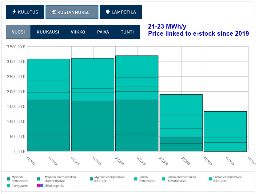

Roughly 0,5€/kWh, our house's consumption is 21-23 000kWh/y
Very difficult to say prescise price, threre are so many different charging schemes, our price is tied to daily e-stock price and rate is different during day time in the winter. We installed an air-water heatpump in October and are expecting 25-35% reduction in consumption this year. On the other hand our new PHEV sucks 10-15kWh per night.
