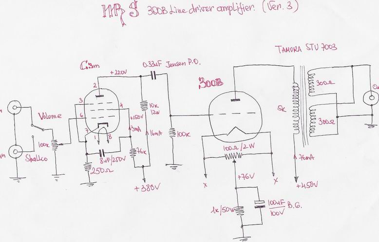

Any chance that you could post a schematic?
Re: English, Ani lo m'daber Ivrit.

Bas Horneman said:I want to build a preamp with a 300B. Why?
Simple..I want to build a preamp with a DHT tube and don't want to buy another tube for a while. (Cash and too many unused tubes in cupboard already)...at first I was thinking...gonna build a nice choke loaded TJ 205d preamp or 101d...But that's a lot of bucks to fork out...then I thought...but I already have some DHT's "in stock" for years that I have not used (that is where the 300B's come into the picture).
Well, given that many valves exist that fit on a U4 Socket and many of these have a mu between 3 (45 which would give a gain of around 9db) and 8 (10 and derivates and 205 which would give a gain of around 18db) and most of these Valves have lowish anode impedances allowing them to drive a line output directly, why not build the thing universal.
You do not need to run the 300B at 80mA and 450V for example, a much more relaxed 180V anode voltage will work for any number of DHT Valves, including some mostly (and unjustly) ignored.
You can then add options for 20/30/40mA Anode current via CCS. I would use fixed bias, which then in combination with a suitable CCS can be used to set the Anode voltage.
For the heaters, simply (again) make them adjustable and include in the case a suitable panel meter switchable to measure Left Anode Voltage, Right Anode Voltage, Left Heater Voltage, Right Heater Voltage.
The result a simple, common cathode, line stage amplification stage. I would probably place the attenuator after the Linestage, with a 10Y or the like, you want a 10K load, all others can see lower loads with no problems, so a 10K attenuator as load after the Valve would be my choice.
Then all you need is a stock of all sorts of DHT's. With heaters up to 7.5V/1.5A you have the following linestage Valves (list may not be complete though) as options:

The actual active circuit could look like this:
100nF PTFE input coupling Cap and 250k gridleak resistor to fixed bias with wide adjustment range.
Valve with CCS anode load.
2.2uF Output Coupling Cap (Mundorf or Audyn KP-SN would be my "starter" choice) folloowed by 10K Attenuator.
Done.

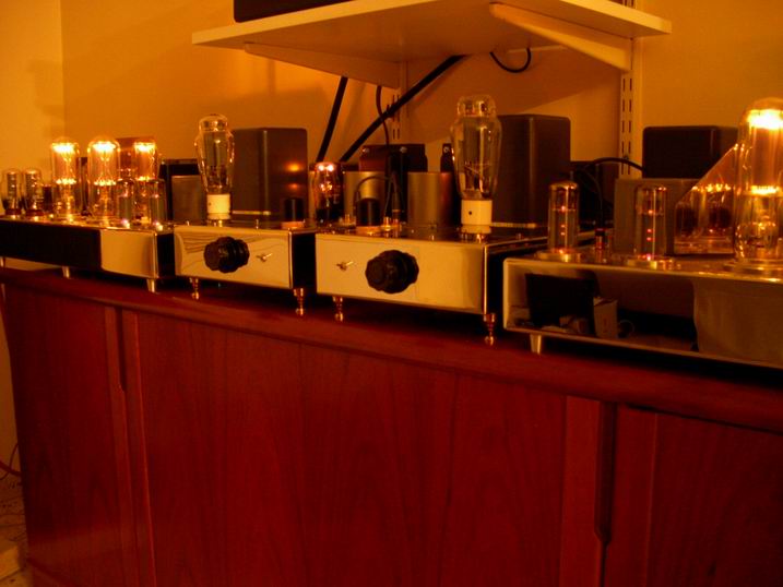

Originally posted by Bas Horneman
Did you ever see my darling (still not completed)
There, another Basian glowing sculpture...
dave

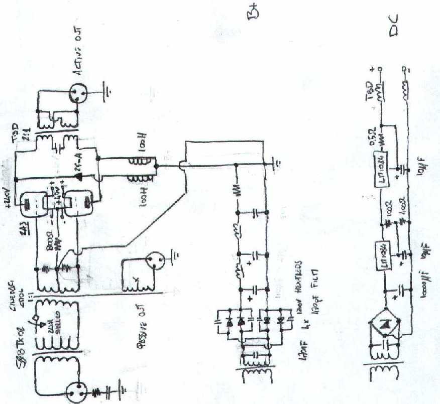

I am in! I think I will start with a passive preamp based on the S&B 102TX an later on I can add an active stage based on a parafeed push-pull of 2A3.
What do you think of the schematics I think to follow??!! I still need to work on it but your impressions would be very welcome.
Like a Raven, only better 🙂 But why the SS PS? Btw, the 'ultrapath' cap in Raven changes the sound for the better IME.
I wonder if the TX102 won't be happier driven by a capable driver rather than being left to the mercy of whatever source is plugged in. Of course this means further complications and there is nothing minimalist about the approach.
Mama mia 😉 😉
SS PS ... well just to stay simple and to give the hexfreds a try but yes changing the PS would be straightforward. I noticed I missed a cap in the RC!!
Source ... I just bought on e-bay a Tascam CD-R for 250eur ... happily waiting for it. I will had a source selector anyway and probably a +6db selector for the TX102
Like a Raven ... yes indeed. I like Push-Pull
Caps ... I am not a part picker but I fear I will need to test different caps
???DC (current) heater???
I am not going to series connect the heaters: I think the best thing to do is to have a separate supply (probably just the last current regulator) feeding each of the valve so each channel should have a bridge + CLC + V regulator + 2 parallel current regulator
Anything wrong???

Hi Gianluca,
I saw that preamp when I was looking for an example of the 300B preamps on the net..I'm just not too keen on the gain stage of the preamp...with the 6sl7 and all...
Nice preamp though huh🙂
