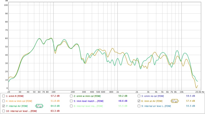

And anybody with acoustic measurement experience would know that the wild bumps and dips in the curves are not shortcomings of the mikes.

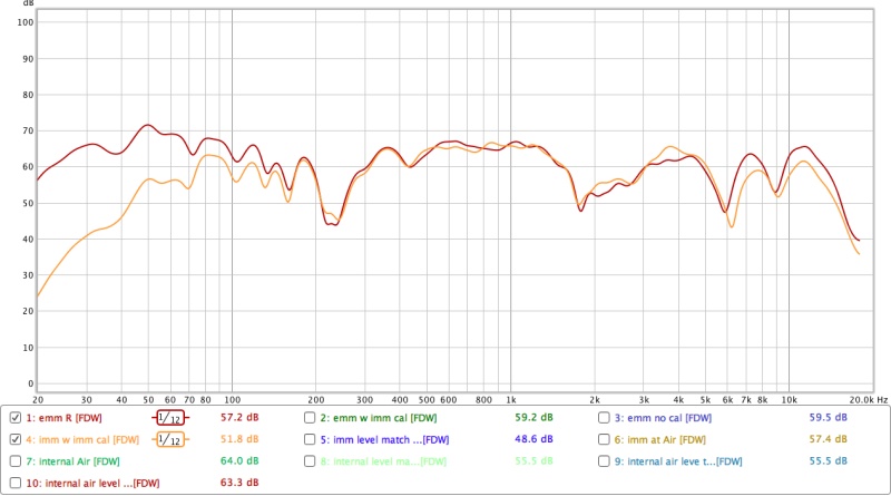

I am confused by this statement and the graphs in the first post. How do you use a mic to measure frequency response of a subwoofer when the response of the mic looks so terrible? Am I reading correctly that the response is from 45 to 70 db meaning a 25 db difference? I would have thought the calibration file would get a close to flat response curve for the mic?
I feel like I need ground level baby steps for venturing into actual speaker measurements. If the mic response is that irregular I do not get how I would be able to measure the response of a speaker other than to compare it against another speaker?

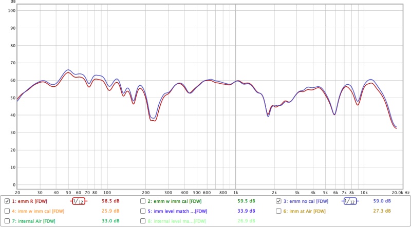

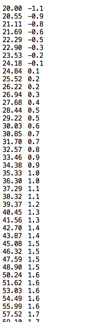

The mic curve for the fancy EMM-6 is the flip-side of the individual calibration corrections I posted in #8 - about as flat as anything in the acoustics world.
The ups-and-downs of the post #1 are the reality of my smallish music room as picked up in one spot with sine-wave testing displayed in one format.
Such curves are related to some aspects of listening experience but freq response (esp one spot in the room as heard by a small mic) should not be thought to characterize all of the listening experience or even being definitive vis a vis your experience of tone compass.
I'd say most curves are used by folks like you and me as part of an iterative process where you are comparing before-and-after. And, as I showed in post #1, even a laptop mic is just dandy for a beginner.

Am I understanding then that the mic's ARE very flat, but the charts you generated are the real world measurements in your specific listening environment? IE the 10 db difference between 20 and 30 hz is an artifact of your environment, not the mic?

The two mics are in close agreement and both are notably flat, as per calibration in post #8. Yes, that's my system-plus-room, one spot (for purpose of comparison between mics), one day, and typical enough of curves posted by others.Am I understanding then that the mic's ARE very flat, but the charts you generated are the real world measurements in your specific listening environment? IE the 10 db difference between 20 and 30 hz is an artifact of your environment, not the mic?
Although you have no experience of your own for comparison and since builders on this forum are notably shy about posting their own rooms (even some of the most vocal persons in this very thread), I sense you are appalled at the non-flatness of my results?*
You can also say that my curve (1/12) is substantially plus-or-minus 5dB, 20 Hz to 15 kHz (with some boost in the bass as many good listeners know to do). Nothing to sneeze at.**

The emm mic is quite flat, as you can tell from it's individual calibration in post #8. What you see in the first chart in post #1 is the mic at one spot in my room with my high-quality near-full-range electrostatic speakers, wild as that appears.
All the charts look wild - that's the reality of acoustic measurement. And if you moved the mic a few inches, the bumps would move around in unpredictable ways.
Now to return to my basic point: can you use the little mic available for free in your laptop?
If you look at the third chart in post #1, you see that the imm mic* and the laptop mic produce results that do resemble one another. The bumps and dips are displaced a bit, but relative to all the variation otherwise (and remembering that they do not occupy the same point in space), pretty close.
And even if they weren't close at all, you could still use your laptop mic iteratively, as barrylotze says. For example, when replacing capacitor values in a crossover you could see the results with each change.
