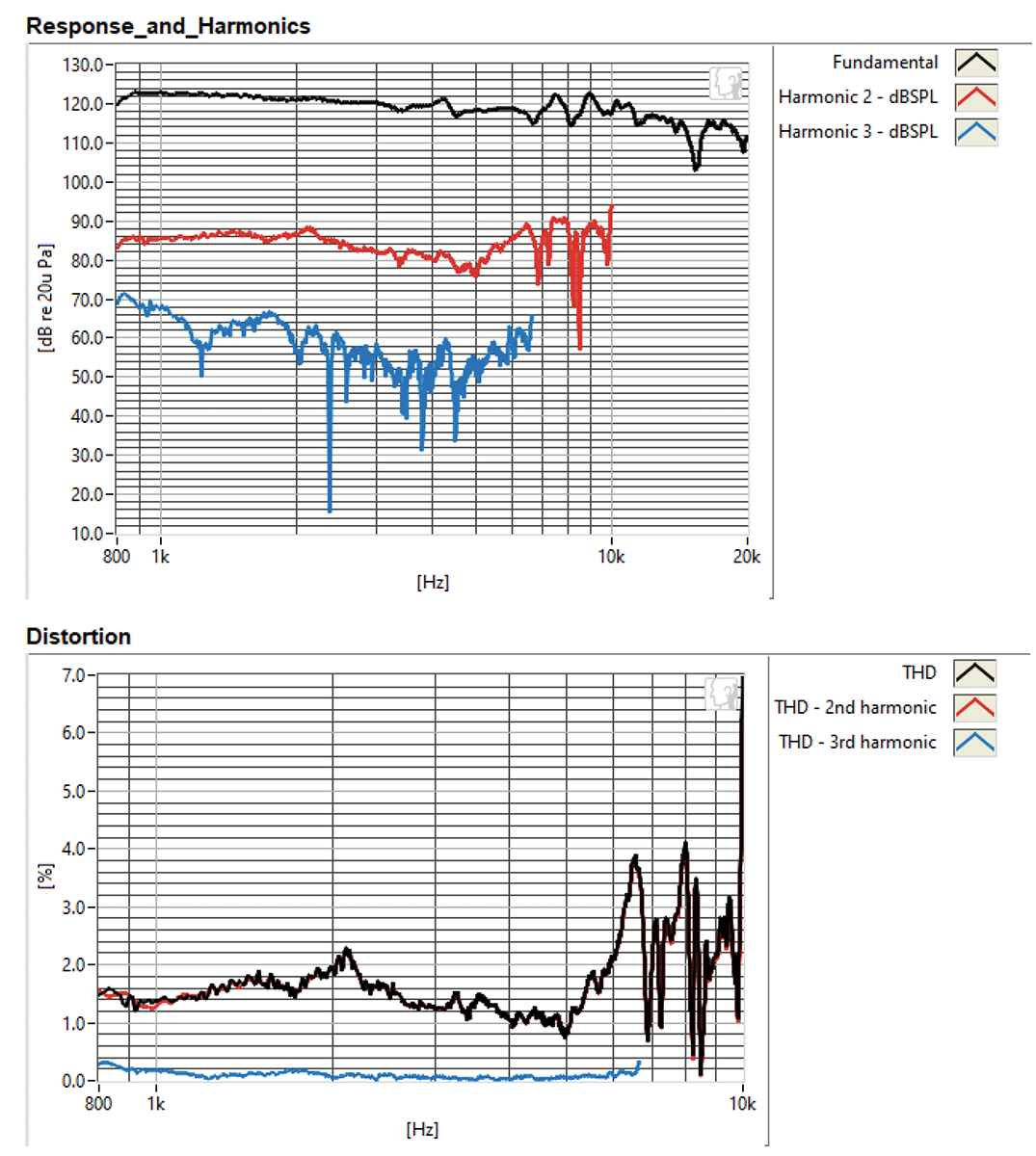

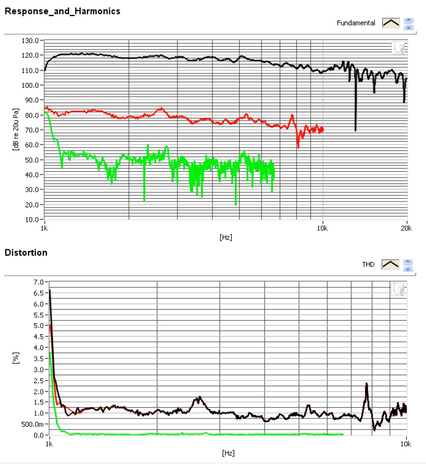

For comparison's sake, here's the measured polars of the B&C DE1090TN vs the Eminence N314X and their distortion measurements. These were done by Vance Dickason. Note that the horns are different.

I am new to this,
Could someone give feedback on this CD and there thoughts, with these graphs
The B&C DE1090TN uses a 4" (100mm) diaphragm, the Eminence N314X a 3" (76.2mm).
The increased displacement from the larger diaphragm would allow for more output at lower frequencies that are displacement, rather than power limited, around +5dB at 500Hz.
The N314X's smaller TeXtreme carbon fiber diaphragm may have better high frequency transient response, slightly less "ringing".
Without seeing (or hearing) tests made of the drivers on the same horn, not too much more to say.
Do you have any experience with either one?The B&C DE1090TN uses a 4" (100mm) diaphragm, the Eminence N314X a 3" (76.2mm).
Would there be one you would choose over the other
Jeremy
Jeremy,Do you have any experience with either one?
No direct experience with either driver, though have tested and listened to the Eminence N314T.
For a PA design like the SA102 requiring high output to a relatively low frequency from the HF driver, I'd go with the designer's (Todd Michael) choice- the 4" B&C DE1090TN.
If the extra displacement afforded by the larger diaphragm were not an issue, I'd choose a 3" format driver, though l would be more inclined to choose a B&C 3" over an Eminence.
If using Eminence, would probably choose the N314T over the more costly, but even rougher response of the N314X.
