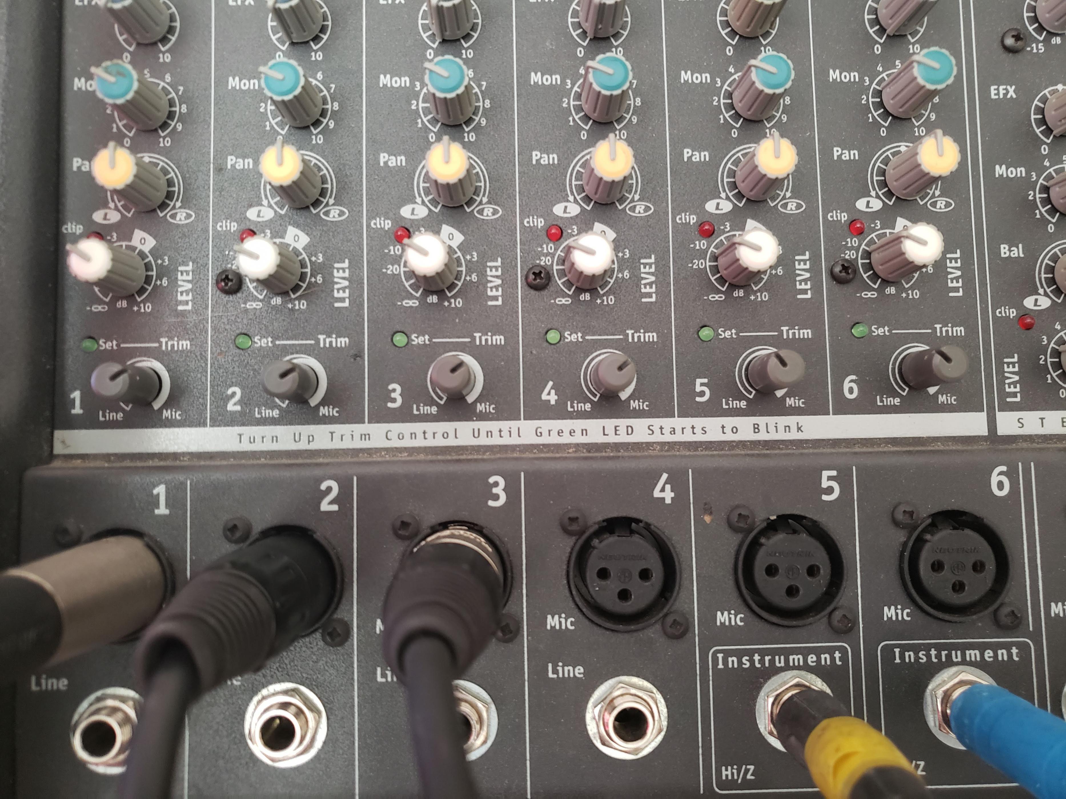

I'm having some weird issues with my mixer and what wondering if I could get some help diagnosing the problem. Everything works but I have to turn up the trim all the way up on channels 1-4 to get the green trim light to light up and also causes the red clip light to light up...
Channel 5-6 Instrument/Mic (Hi/z) I have to turn the trim all the way down and the trim light still comes on with the red clip light.
I haven't used my amp in months due to me having surgery but I know something is not right.
Any Ideas?
I think I figured out the problem.. I think it was the cable I was using to test things... Maybe my memory was a bit off, I thought I had the trim down lower than what it is set at now.. I'm getting a blinking to solid green lights trim light and no red clip light on all channels... mics are plugged into channel 1-3 and I have a guitar amp and keyboard plugged into 5-6
Does this look about right for anyone who has knowledge with Yorkville mixers?

have you seen the article What is Gain Structure? - diyAudio it may be useful in answering your questions.
looking at the picture and as i'm quite familiar with this mixer ( one of the local bands i help out is using this mixer) i would say input trim is still a little high and the channel "levels" are run a tad low but as gain structure is a chain we would need to examine where masters are set.
all of this is relative and we've not even considered loudspeaker efficiency and a multitude of other factors that come to bear in a PA situation.
