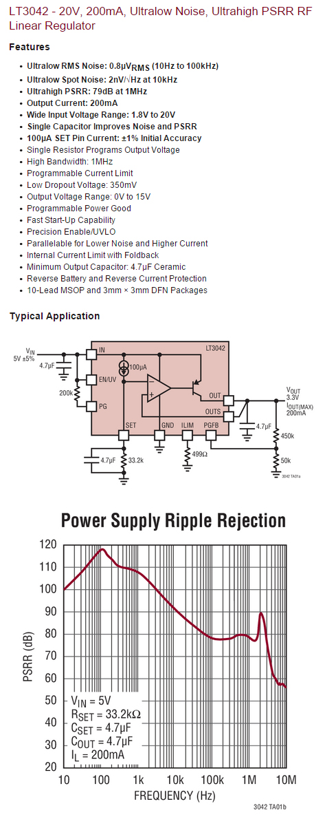

While I was amazed by ADM7150's performance, Linear tech released their best LDO ever - LT3042
The first sub-uv noise (0.8uv RMS @ 10Hz-100KHz) LDO on the market. What do you think?

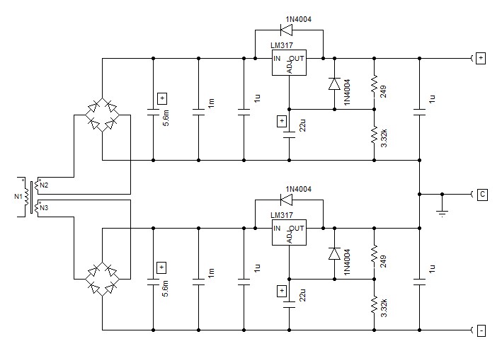

According to the datasheet, the LT3042's PG, PGFB, ILIM and SET pins cannot be driven more than 0.3V below ground during normal operation, or a fault condition. On its own, this is fine, but I'm trying to envision how two LT3042 rectifiers could be arranged to provide a common return path for (+15)-0-(-15) output without these pins on the now-negative half being below ground? If you could provide a schematic drawing it would be excellent and a great help.

TI Tina doesn't have that part in it's library so I'm using a standard LM317 circuit for illustrative purposes, just substitute the LT3042 circuit, it will work the same. Notice the only common connection point is the negative side of the upper regulator and the positive side of the lower regulator. That junction is the only common connecting point, and provides the common "ground" for the supply.
Hope that helps.
Mike

I appreciate the explanation and well-drawn image. It is what I had in mind, but the 0.3V clause unique to specific Linear devices, and having seen arrangements utilizing a single bridge rectifier, I initially had caused some concerns. I will report back once I have prototyped a pair. These may be suited to your latest preamp design.

No problem. The main thing is, as long as you don't create a short circuit, the reverse voltage limitation shouldn't come into play. But if you need total peace of mind, a schottky rectifier with a forward voltage of 300 mV or less would fit the bill.
