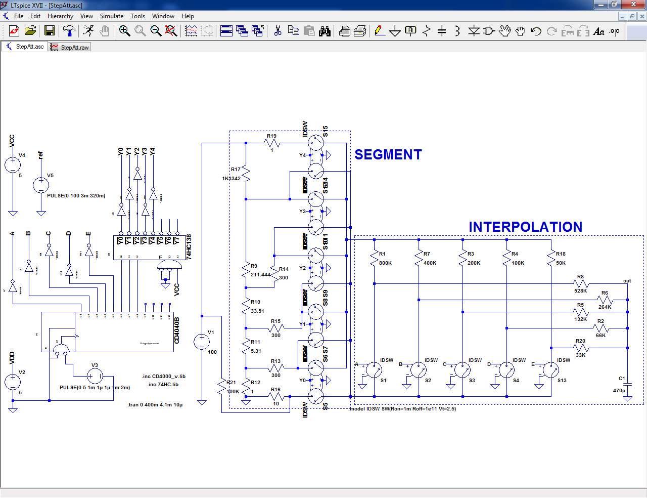

To illustrate the mode of operation, I have prepared a purely conceptual example in sim.
attachment.php
It reflects the topology and the way it operates, but a real attenuator based on these principles would be completely different:
The segment generator uses a simple resistive divider with awkward values, and the interpolator is based on a non-linear DAC having large, variable input and output impedances.
I used these expedients to simplify the sim, reduce the number of switches, etc.

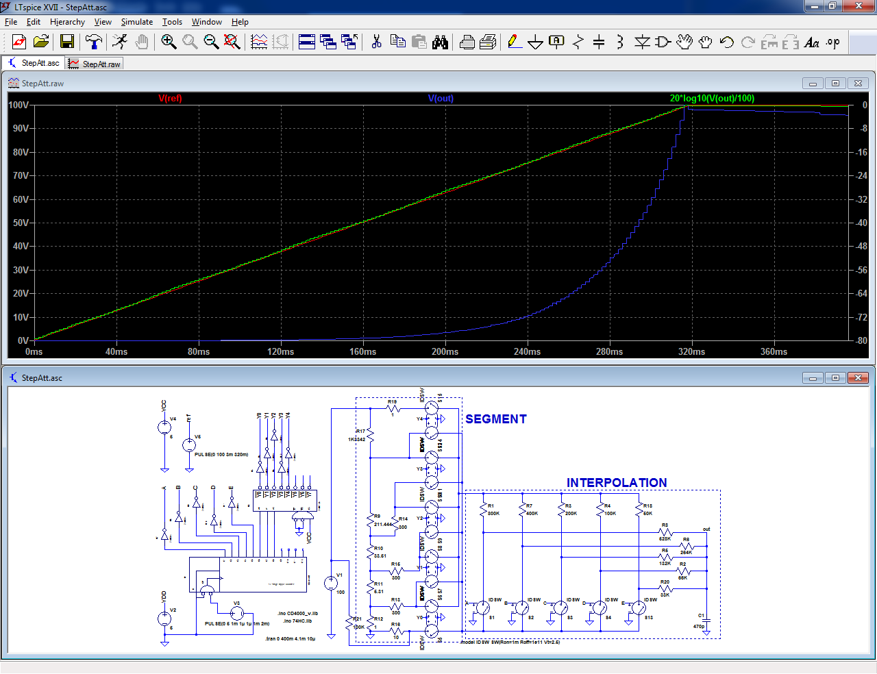

Note that all the left part serves to illustrate the operation of the circuit by scanning all the attenuation range, and C1's role is to clean up the video.
The Vref trace is just for graphic comparison.
This example has been designed as a 5 bit, 5 segment, 160 x 0.5dB steps attenuator covering 80dB:

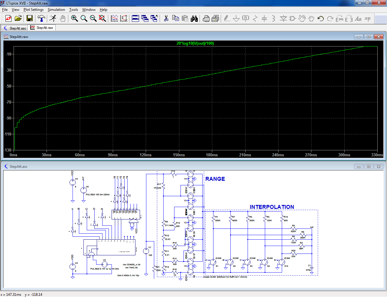

The example I gave is just a plain-vanilla, linear-in-dB attenuator, but other functions are easily obtainable, always with the same guaranteed monotonicity.
In this variant, the start of curve is altered to progressively arrive at a ~ -∞ attenuation, without resorting to a mute (which is always possible by turning off all the segment switches):

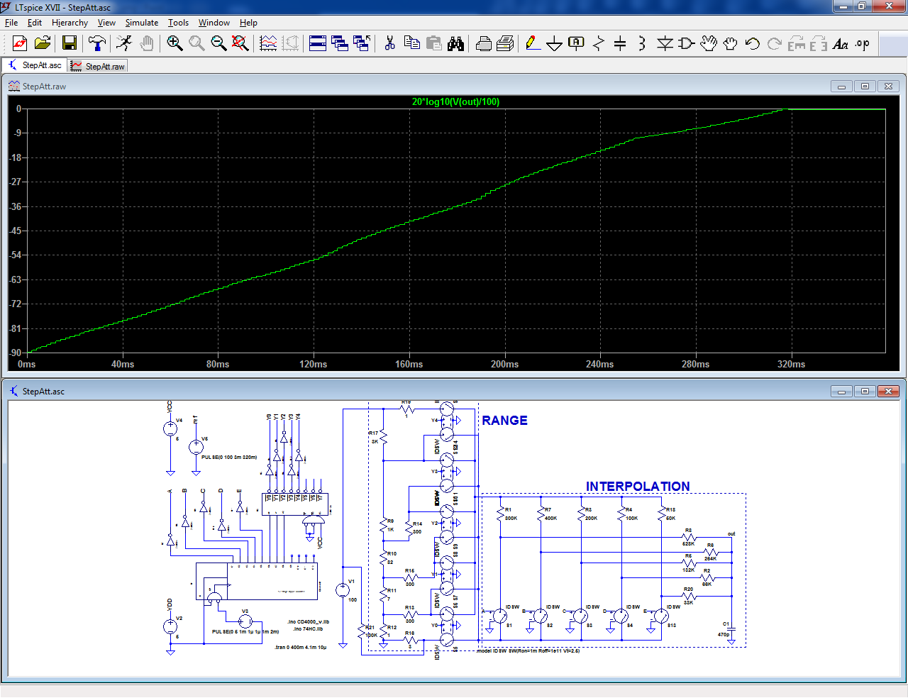

Here, the slopes of individual segments have been changed:
attachment.php

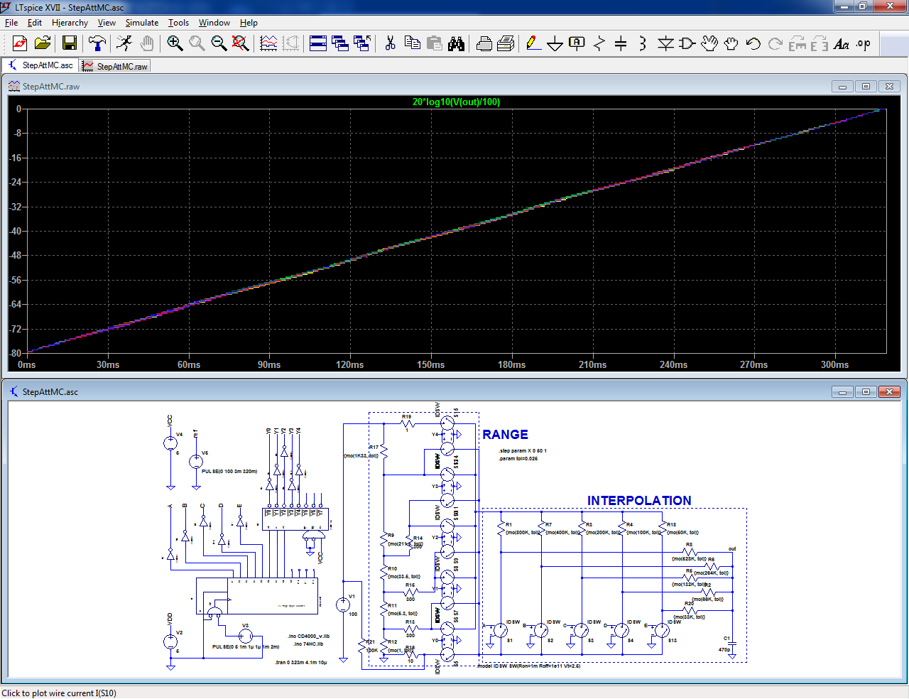

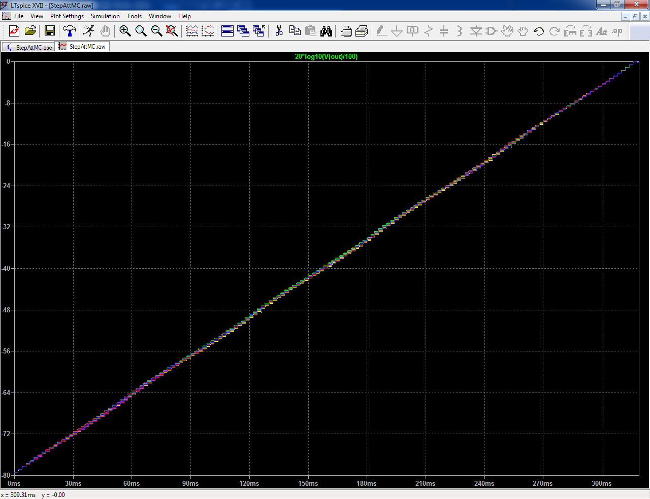

And finally, to illustrate the robustness of the concept, here is a Monte-Carlo simulation (50 runs), with all the important components affected by a +/-2.5% tolerance:
attachment.php
Not bad, considering the 160 steps/80 dB range: there are variations, of course, but the monotonicity is never in question
