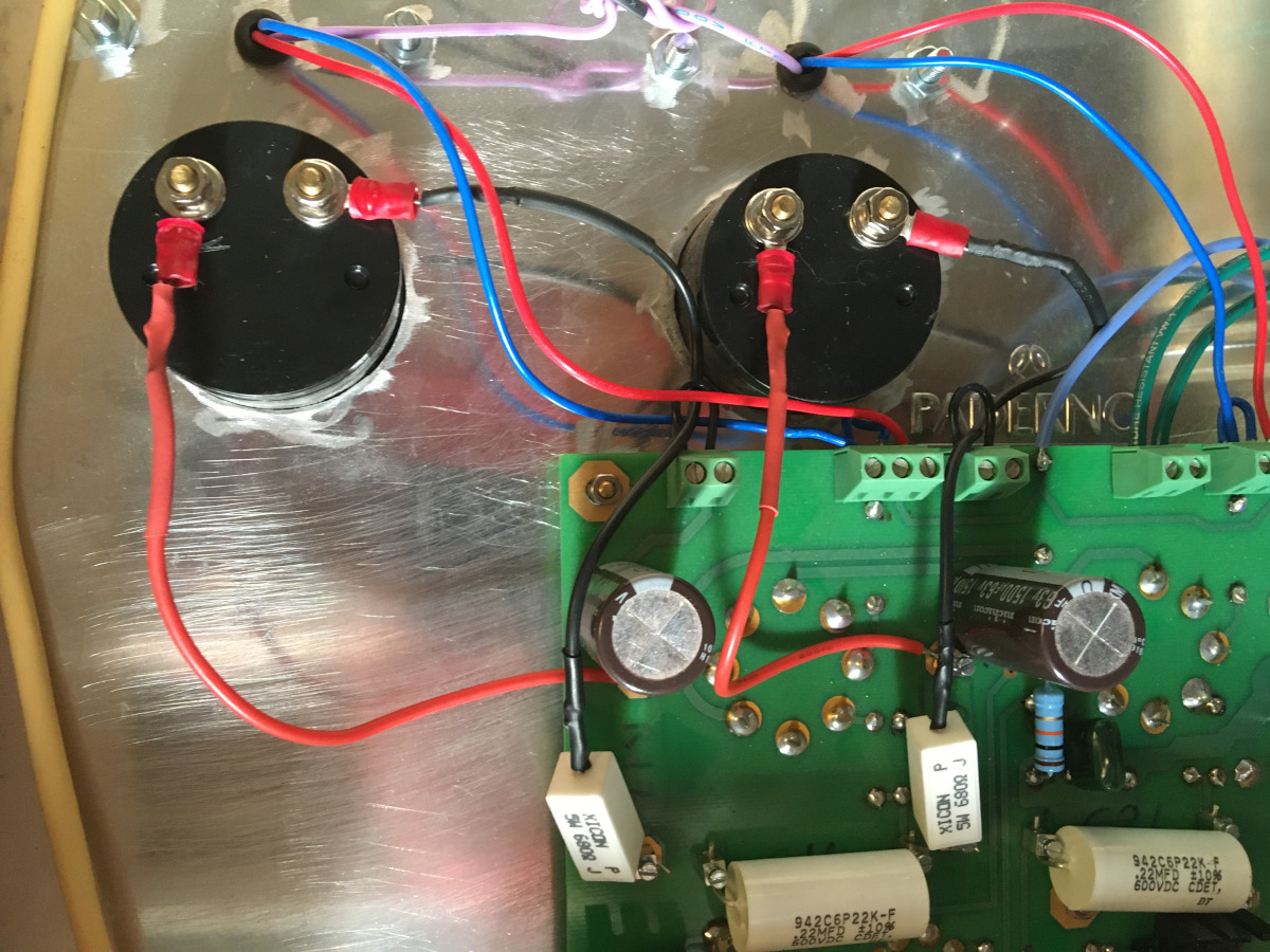

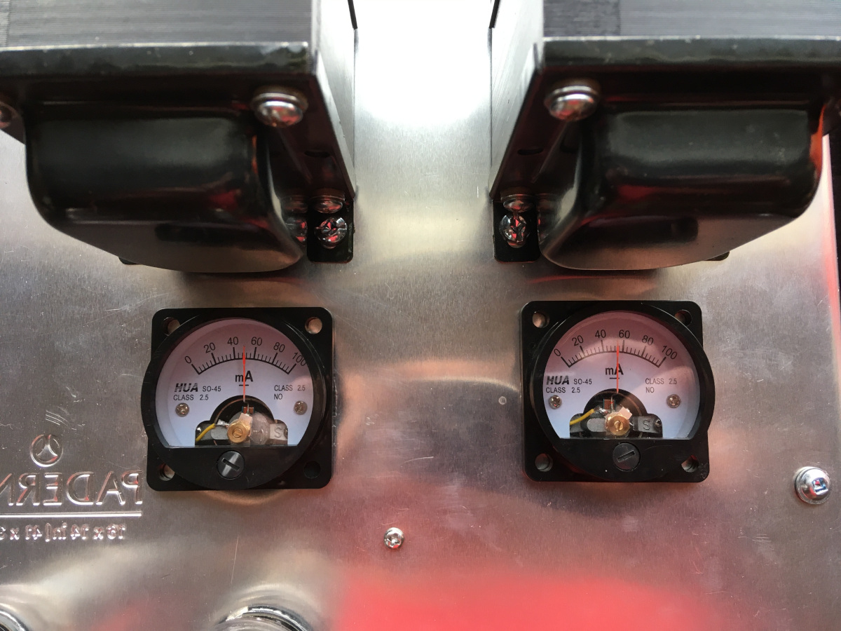

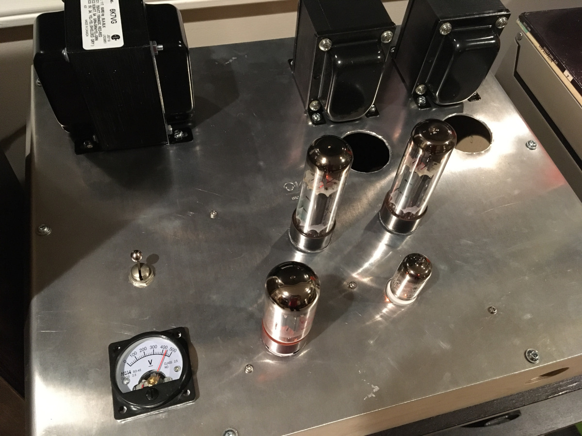

However, I have decided to go ahead and install my permanent B+ voltmeter... almost done... just waiting for my soldering iron to heat up.

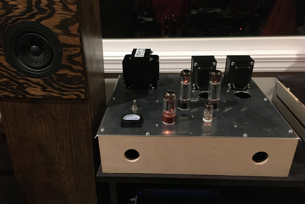

I figure I owe the community a couple of pics. Still a long way to go (install ammeters for each power tube, stain/finish the chassis wood, install Vu meters on front, install bottom grille, install feet, figure out how to polish the top plate...)
But at least it works for now. Nice to have a permanent B+ voltmeter.

The amp has been playing for quite a long time now. I just used my IR thermometer to check the power transformer. 40C, which is a hell of a lot cooler than the 274BX ran when it worked. It was hot to touch, whereas the 6K7VG is merely warm.
