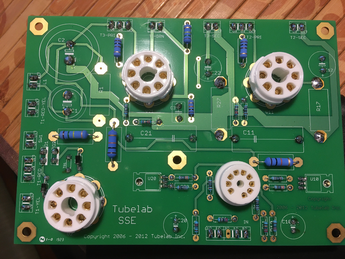

I am guessing that the regulars around here, maybe even George himself, have become a bit bored with these SSE builds. I mean really, how many years has it been?
On the other hand, for people like me this is new and exciting - and I have really enjoyed reading other people's build threads. So I figured I would post my journey.

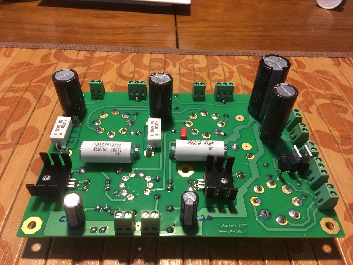

So far, I have obtained the board and sourced all the minor components, built the board, and have some of the major components - with the rest on the way.
This is what I've decided:
- "Inverted" orientation for under-chassis mounting
- Current inrush limiter on mains primary
- Hammond 274BX
- C1 = Nichicon 47uF 500v
- C2 = Kemet 150uF 500v
- Triad C14X choke
- Kemet 80uF 470vac PP motor run cap
- TR1, D3 and D4 installed
- Binding posts installed for C11/21 and R17/27 to enable easy replacement
- CDE 942 series PP coupling caps C11/21
- 680ohm to start off R17/27 (plan to run EL34 exclusively for quite some time)
- a selection of various other values for R17/27 for future use
- Gold-plated copper inputs and speaker terminals
- 18GA 600v 200C tinned copper silicone hookup wire
- probably DIY chassis - typical wood frame and aluminum top
- not 100% decided on OPTs yet - have some cheap Chinese ones on the way just for testing
- Tubes will be EH EL34, NOS GE 12AT7, and various rectifiers (Shuguang 5AR4, NOS RCA and Sylvania 5U4GB).
Photos of progress so far:
(Note: the way I have oriented the C11/21 and R17/27 binding posts may seem odd, but they make component installation/replacement easier (for me, anyway).

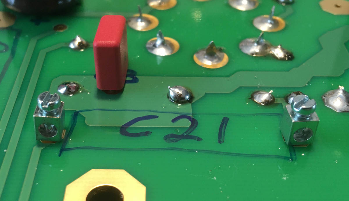

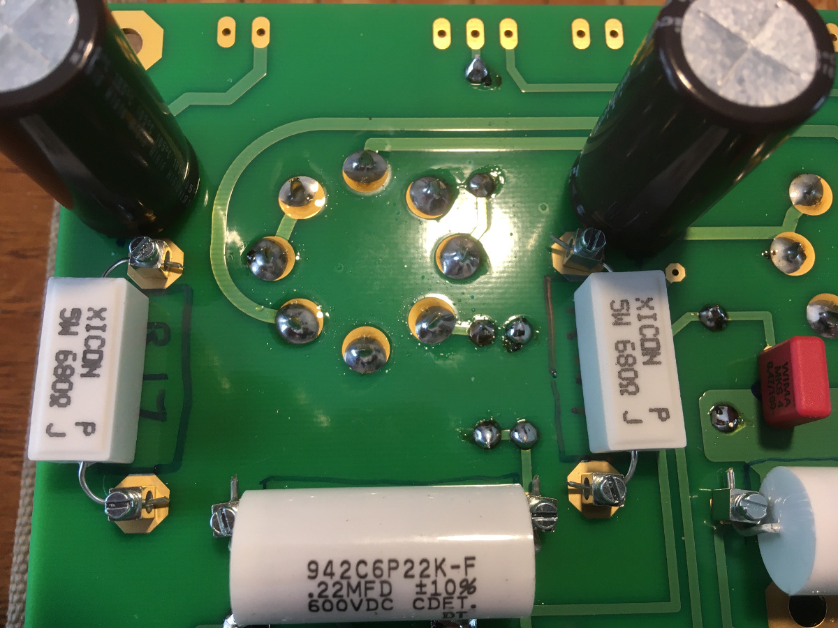

Looks good so far, I like the idea of the binding posts, where did you get those by chance? Might try to install them on mine.
These look about right?
8737 Keystone Electronics | Connectors, Interconnects | DigiKey

Hey thanks!
The binding posts I used are very close to those. Same manufacturer, but part number 8730. I have no idea what the difference is (if any). I ordered from Mouser 8730 Keystone Electronics | Mouser Canada
The only thing to keep in mind is to be very gentle with the torque. Set the screws just firmly enough to bind the leads - a bit too much torque and that pin is going to spin and crack the solder joint (a smart engineer would have designed them with non-round pins).

... - a bit too much torque and that pin is going to spin and crack the solder joint ...
Just an FYI regarding those binding posts ... some of the pads are plated through, and I think that includes some of the coupling cap pads, and maybe the cathode resistor(s), making a connection between the top and bottom of the boards. If that connection is broken or otherwise not made, the board won't work and then you have to reestablish the connection with the component lead.
I don't know if that is applicable to these binding posts, again, just something to keep in mind.
Very good to know, and all the more reason to exert as little torque as is necessary to bind the leads. Thank you.

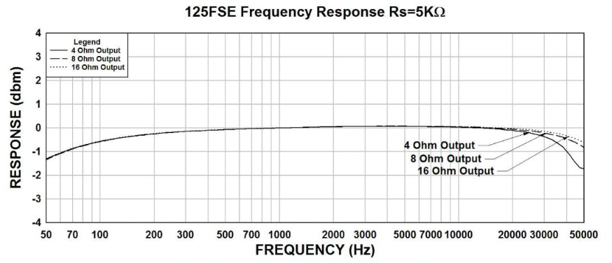

The Hammond 274BX arrived yesterday. The Chinese OPTs have not even left the wharehouse (due to Corona, I suppose). I think I am going to go ahead and order the Hammond 125FSE (4.5 pound, 20 watt) OPTs. Here is the frequency response at rated output power (20w). I figure at 6 watts or so they will be flat (+/- 1dB) to 30Hz (at least) which is more than I need.
attachment.php
I finally made the decision and pulled the trigger on a pair of Transcendar TT-338-OT. They are expensive, but as they say "you only live once", and "you can't take your money with you."

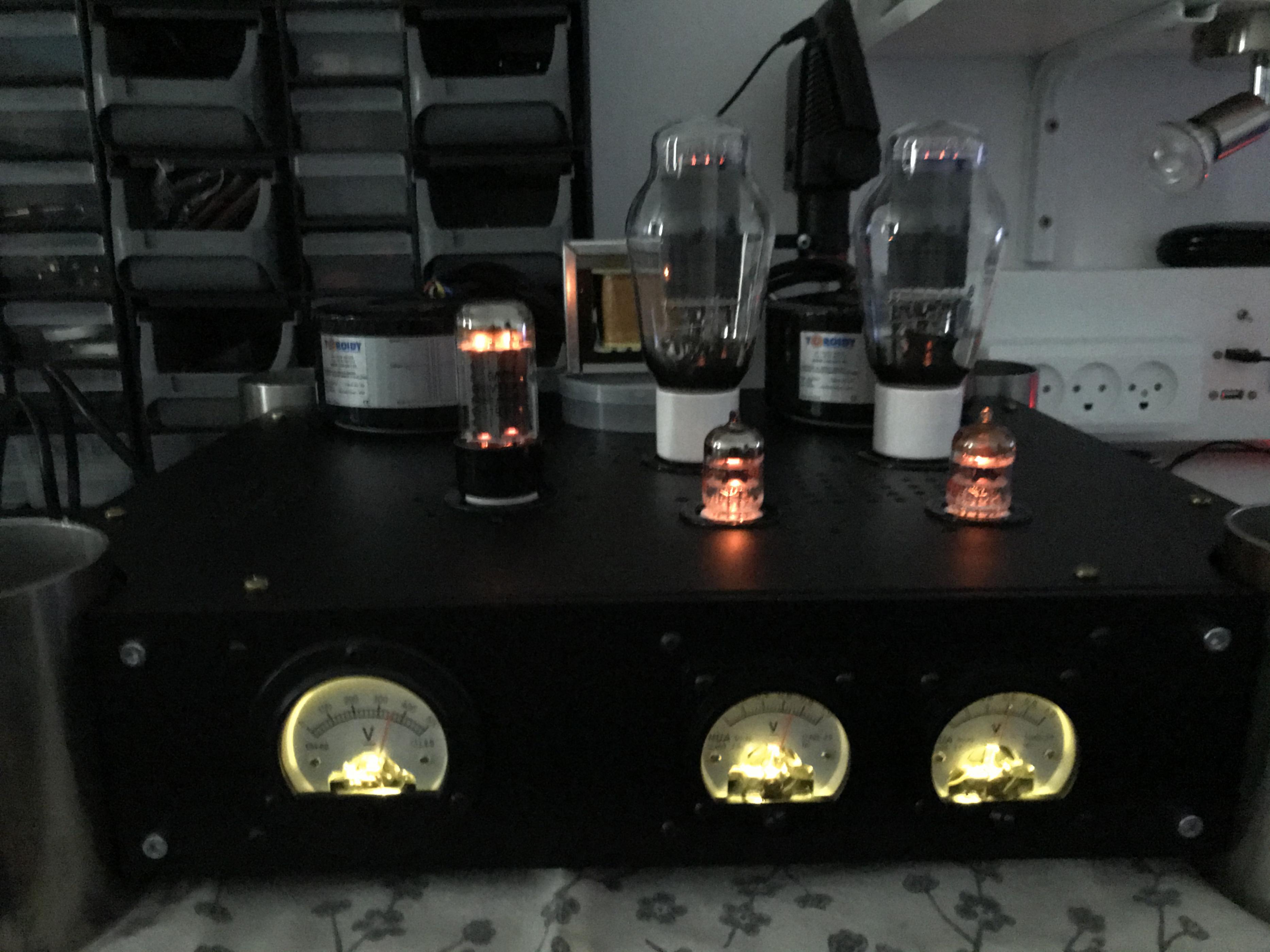

I have also decided to add the following to this amp:
- 2 front-mounted, back-lit, analog VU meters (pure eye candy)
- 1 top-mounted, 0-500v, analog voltmeter to monitor B+
- 2 top-mounted, 0-100ma, analog ammeters to monitor power tube plate currents
This will delay the project by at least another month as I wait for the parts (China).
Cool cogitech, great plan you have...
I think that the voltmeters you ordred could be like mine ?
They are fairly easy to hack to get light in, well not 100% perfect but good enough for me through 🙂
Jesper.

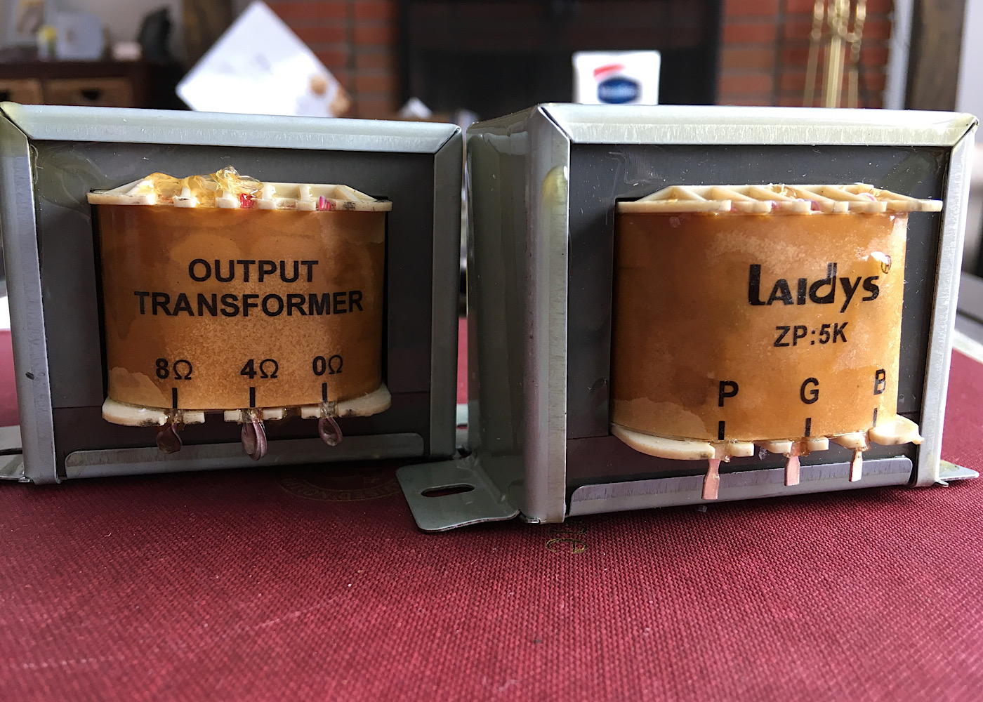

I'm happy to report that the Chinese Cheepies have arrived.
- They have a U/L tap (nice surprise!)
- They weigh 996g and 991g respectively (~2.2 lbs)
- Primary resistance is 370ohms (both the same)
- Secondary resistance between 0 and 8ohm is 1.8ohms (both the same)
- I have no way to test inductance but the claim is 25Hy, which seems entirely appropriate for this size of OPT
- I'm calling it a 6 watt OPT
Note: they are the same size, despite the perspective distortion in the photo:

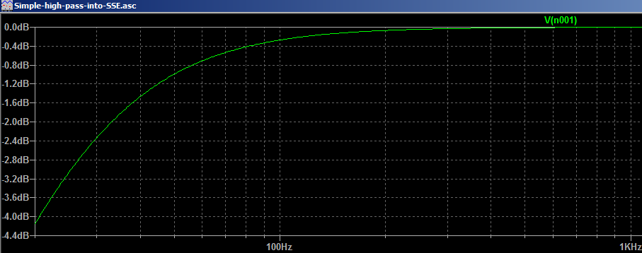

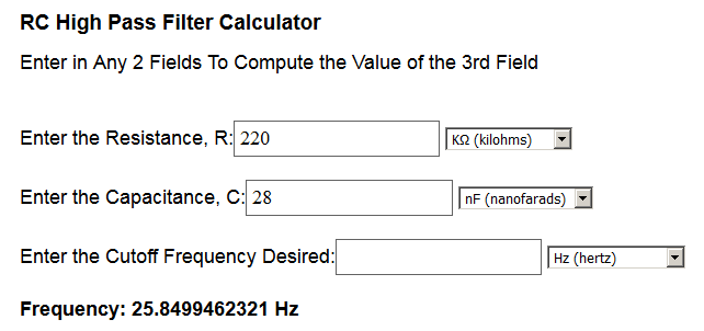

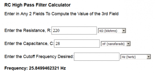

Been thinking a lot about frequency response (due to another discussion on OPTs) and I have decided to add a switchable high-pass filter on my SSE just for schlitz n' giggles. It'll look something like this:
attachment.php
attachment.php
I already have a bunch of 10nF film caps so I will just parrallel 3 of them and install in series (switchable) with each input channel.
It'll drop 1.4dB at 40Hz and continue to drop from there. My speakers roll themselves off pretty hard right around 40Hz (F10 ~35Hz) so maybe gradually relieving the OPTs and transducers from the sub-40Hz signal will be a good thing. Why drive that energy through those components if I'm not going to hear it anyway and it is possibly/probably going to cause saturation and/or inter-modulation distortion at higher SPLs? Room modes tend to give me loads of low bass gain, anyway.
The switch will probably get switched back and forth a few dozen times in the first week and then stay in one position for years, but what the heck. Cheap thrills.
