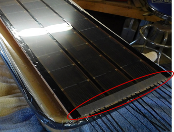

My new segmented wire stator electrostats are finished. And they sound as good as they look … damned sexy.
Glad to hear you are pleased with the results of your new wire stators. 🙂
Can you describe how you handled the spacers at the ends of the stators?
From the pics on your website it looks like E6000 was used to glue a thin spacer on top of the wires at a level flush with the black VHB tape used on the vertical spacers.
Yes, that's right. I glued down .047" thick polycarbonate shims over the wires at the panel ends, and then applied .015" thick UHB tape over the shims to match the height of the .063 foam tape vertical spacers.
Assembling the wood lattice over the wire in the jig worked really well. I put down wax paper on the jig platform before stringing up the wires. When I took the stators out of the jig the glue lines were perfectly flush to the wires.
