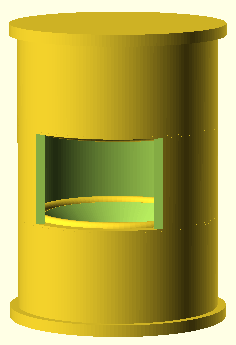

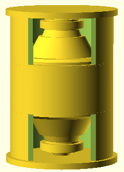

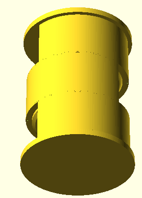

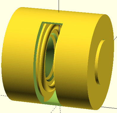

Think I will go ahead to order four 12" Peerless SLS and have a go at this design and see how it measures standing on end:
To keep the front and back cut outs as far from each other as feasible, I increased the chamber widths (heights as in the CAD above) but the cavity volume is still about 10% less than I've estimated Charlie's design is. Drivers are on back order and need to find time to cut the pipe, so will be a few weeks at least before firing up.

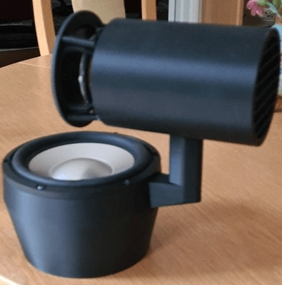

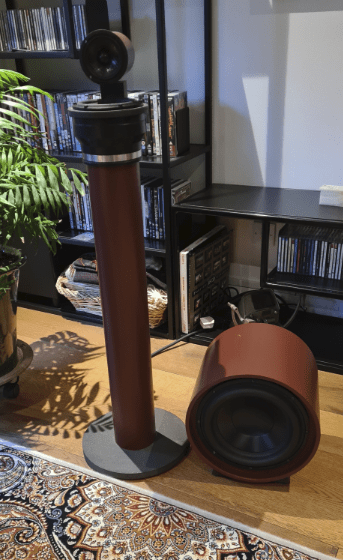

Quick background to explain why I'm thinking about a drum style 10" ripole: I originally bought an LXmini kit from Frank Brenner's Linkwitz store and later added a pair of LXsub2 kits. I like the cylindrical shape of the subs as they fit in well with the LXmini. Here's a picture of my build before I changed the basket and FR tube for a neater solution:
New top assembly now looks like this:
Hence I would like to keep the circular theme rather than square boxes.

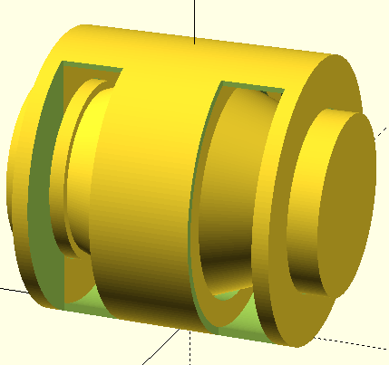

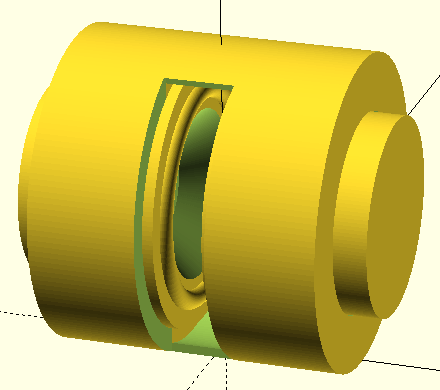

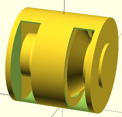

Here's my idea for the design, any helpful comments (for or against the design) will be most appreciated. Firstly with the Seas 10" drivers:
View attachment 1126988View attachment 1126989
With Peerless SLS 10" drivers:
View attachment 1126986View attachment 1126987
The front cutout is 1/3 * SD * 2, the rears are each 0.67 * SD.
Assembly will be an interesting challenge, but I have some ideas for that.
Finally, a question regarding the radiation pattern of ripoles in the vertical direction? I guess still some sort of cardoid? What would happen if the sub was flipped on it's side/end?
Franks brown sub reminds me of one I'm working on.
Im making one now. It looks almost the same size, mine houses a 10 that kicks like a mule in the tight quarters. More info in sub forum. And updates later.Hi Frank I am keen to know if you did this cylindrical project

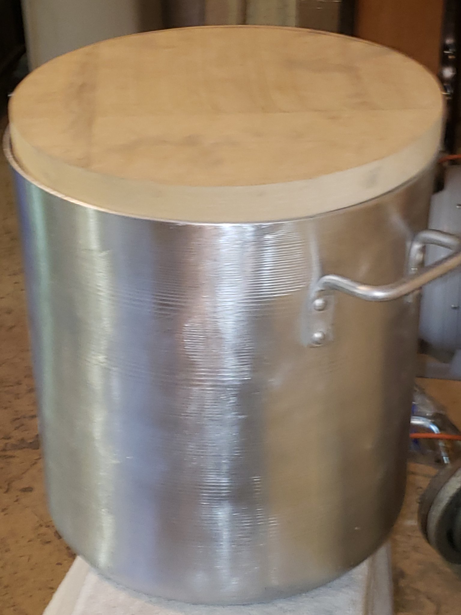

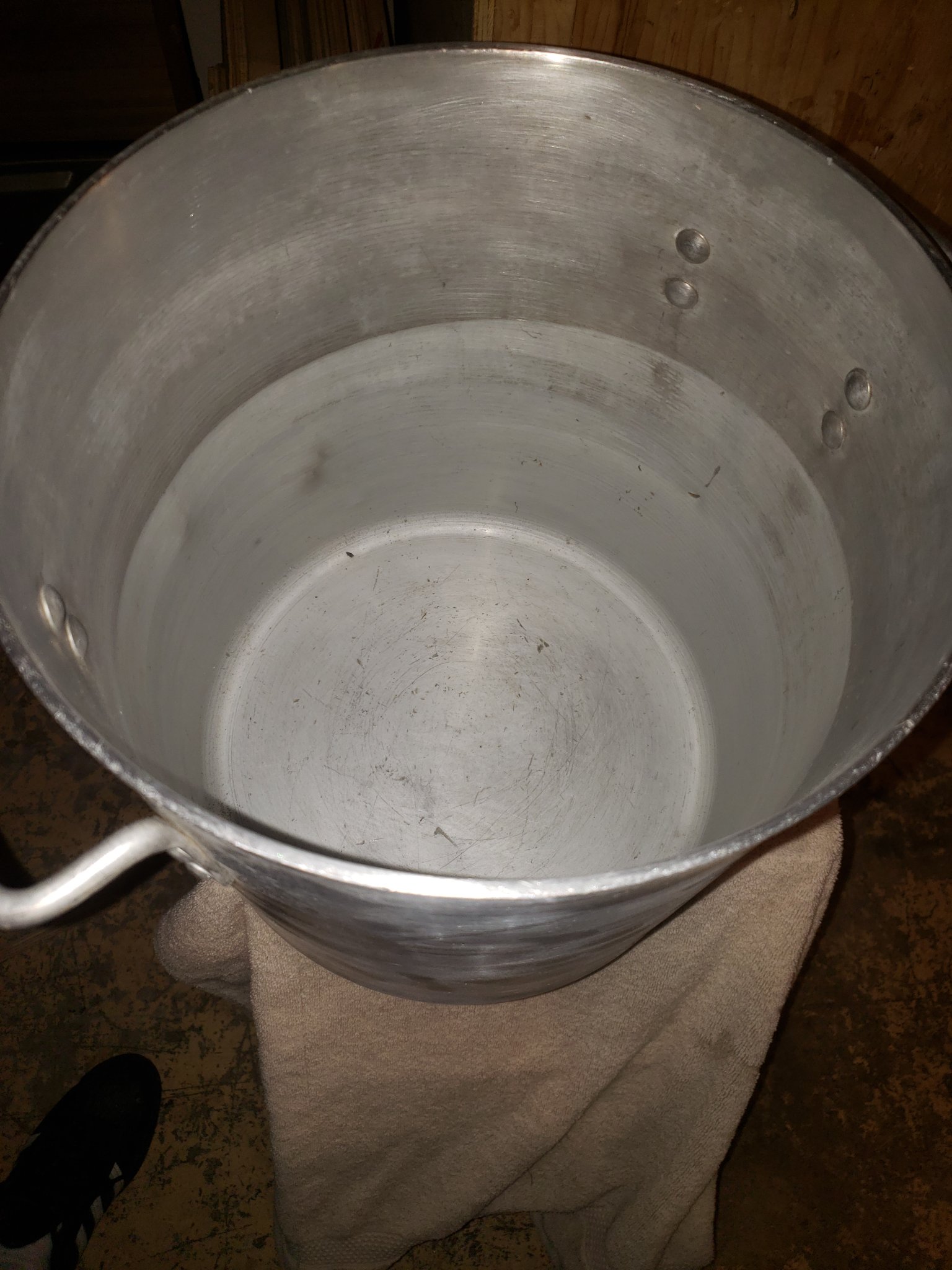

Its a pot, lots of people do. I like contrasting wood with metals. And that was already the dimension I wanted.

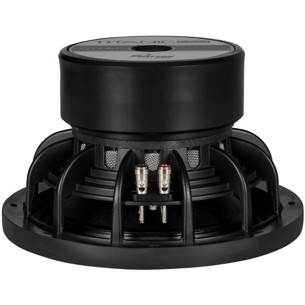

It doesn't look like it started life as a pot anymore, its a baffle for first of two subs https://www.parts-express.com/Dayto...tanic-Mk-4-Subwoofer-4-Ohm-295-401?quantity=1
I'm making this set 3.1, actually it will be a 2.2. https://6moons.com/audioreviews/gallo/ref3.html

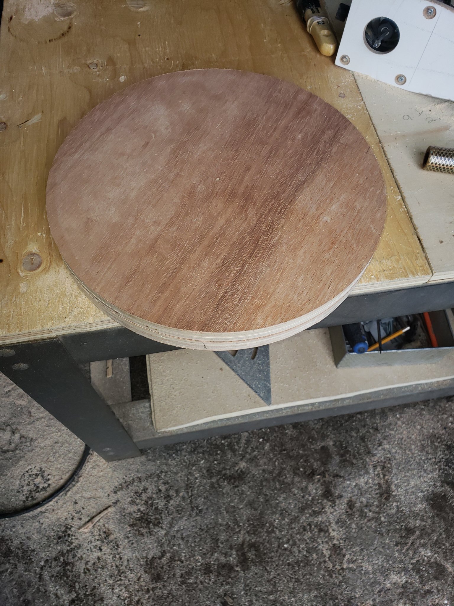

MDF blows, litterally. I only used it cause that was free. I forgot how crap it is. Baffle is another 1/2" thicker (.75 x2 plywood birch. Its also much better quality. So glad I hated the MDF in the end.
The 10 fits the pot bang on perfect with 3/4" from ID of baffle to ID on the metal edge. It fit perfectly tight after I clapped the pot slightly to take it back to the original "perfect circle". All the heating/cooling may of threw it off a couple thousandth. Or maybe it had a temperamental chef in its past life.
Its working out splendidly 😉

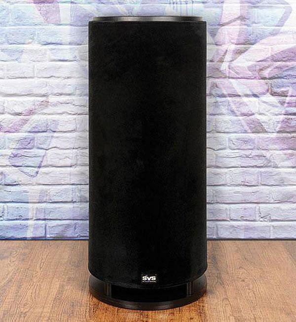

SVS has been making tube subs for years. Maybe they would fill you in on where they source the rolls from.
