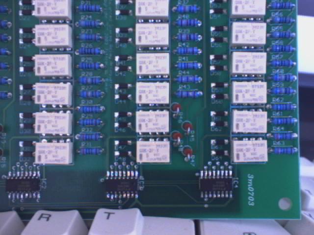

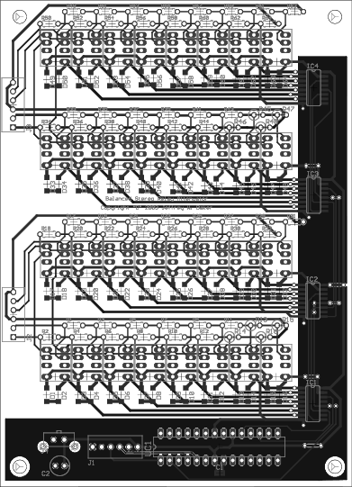

Yet another relay attenuator
Here's a much better photo:
Damedged2002 said:
Hi JWB,
That's a pretty nice project you're doing. I'm curious if you have tested out the boards to see how it sounds during the volume adjustment. Are there any noticable clicks from the relays opening and closing?
Don
These Omron microminiature relays are quite loud. There is a clearly audible zip as you go up or down. If you need quiet relays, you would use Coto. They are almost inaudible, but also about twice as large.

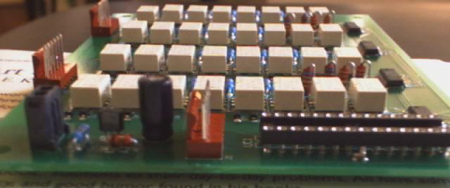

Compact relay attenuator with remote control
already a little while ago I also made my own relay attenuator.
It utilizes only 5 tiny relais for a 32-step stereo attenuator.
Besides manual (front knob) control, it simulatenously works with an IR remote control. Next to volume control it can also perform input channel selection (4 extra relays for 4 input channels).
All implemented with a (PIC) microcontroller as only IC.
The design allows connecting multiple boards under a single control, to implement balanced (XLR) designs or multi-channel audio.
You can see my design at: http://jos.vaneijndhoven.net/switchr/design.html
Broader background info and two utilities for dimensioning and analyzing switched attenuators are on:
http://jos.vaneijndhoven.net/switchr/index.html
Happy reading,
and let me know on your feedback!
greetings,
Jos
