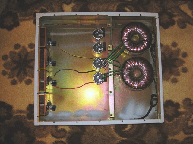

Yet another pseudo GC in progress
200W trafos, 10mF capacitors, non-inverting configuration dual stereo.
Intended for bi-amping, hence the small heatsinks.
The case is actually bottom-up in the pictures, it's an old pc case from some ancient cluster or smth (no openings in the front panel)

Nuuk: yeah, neat and very compact

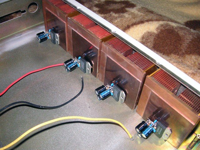

motherone: yep, these are Socket A heatsinks. Got them from a local supplier for about 3$ each and they even had fans! Though they were very noisy and as these heatsinks proved to be quite effective up to about 50W output power, I decided to get rid of fans altogether.

Lucky you! I've been looking for copper socket-A coolers, but haven't been able to locate a deal like that. Most of the suppliers out there will charge you more for the shipping than the heatsinks cost!
You'd think there'd be some good places to get stuff like that here in Seattle, but I must always miss the sales where they clear them out 😀
One thing that comes to mind is have you thought about using thermal epoxy to mount the chips to the heatsinks? It'd be a nice, no-screw method to do it. Might be worth it once you verify that the amp works, and assuming all the heatsinks are isolated from each other and the chassis.
Yes, I have thought about that. I have even experimented with simple epoxy glue and an insulator (paper towel - about 20microns which was too thick, only appropriate for 30W or so. Sliced mica should do better but I haven't done any experiments yet).
Anyway I will use screws for this project as these heatsinks are a bit small (+-35V supply) and a good physical contact with the case could provide additional heasinking which is important as I'm not planning to put any fans there.

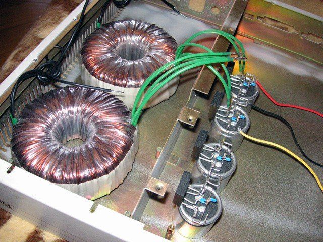

Attached a closeup 🙂
