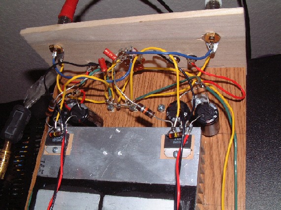

I follwed that famous "Peter Daniel GainClone" schematic and I mounted everything on a scrap piece of wood from my garage.
The result is truly ghetto looking but when I hooked it up to my generic panasonic dvd player and Paradigm studio 80 speakers I was so pleasantly surprised. My gain clone (or PeterDaniel Clone or Thorston Clone

maybe i am having heat problems because the heat sink fins are facing down 🙄 that's the heat sink i got and i don't have a choice on how to mount it another way

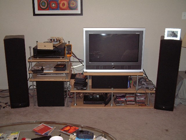

due to recent money issues i will just leave my gainclone "open air" as it is.
You may not be where you want to be but remember that the best place to live is just inside your income 😉
If it works, there's no real hurry for a case but I wonder if you could turn it on its side to increase the air flow over the heatsink fins?
My choice would be some sort of acrylic casing as well and one day I may just get round to making one.
One advantage of leaving it open is to admire your work while you enjoy the music!
Gainclone, 16x9 TV, and a 16x9 Dog, what more could a person hope for.
Congratulations.
Don’t be too anxious to give up the breadboard look. It has its own chic-ness. My favorite GC photos have mostly been open chassis.
Sometimes exploiting what you have to work with can evolve into something special.
Congratulations.
just remember you have some exposed connections there that
are very dangerous! At least cover up your mains connection and
secondaries. Just brushing up against that could ruin your day.
(voice of experience? nahhhhh!)
nice work! - be safe to build more 😉

Well I reckon a wet nose is a good conductor too…
A curious pooch with a healthy wet nose could also receive quite a wallop too.
