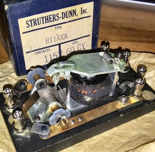

While there ARE mechanical latching relays, most today seem to "latch" with small magnets. To keep electric demand low, very small magnets.no need to apply an active force to keep closed the NO position, a latching relay would be more stable to sustain higher loads.
I have one on this desk. Here is a vintage LATCHING relay:
The electromagnet CHUNKs on the ratchet shaft. Cams work two switches A and B, alternately.
