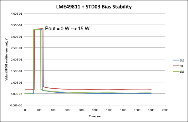

Speaking of bias. I calculated the resistor between the SOURCE and SINK pins as follows. I measured the bias current sourced by the LME49811 by attaching an ammeter between SOURCE and SINK. I measured the bias current to be 7.9 mA. I wanted 2.5 mA in the ThermalTrak diodes as Sanken says this is the recommended operating current. Figuring the 200 ohm bias tweak pot would be centered, I calculated the expected voltage drop across the diode stack and the pot to be 2.495 V. Thus, R = 2.495/(7.9E-3 - 2.5E-3) = 462 ohm. 470 was used. What I don't like about this, tough, is that the current through the resistor and diode stack will vary depending on the base current drawn by the output stage. Would it matter much if I ran the full LME49811 bias current through the diodes? I could scale up the current in the output devices by the same factor... Or is there a better way of doing this?

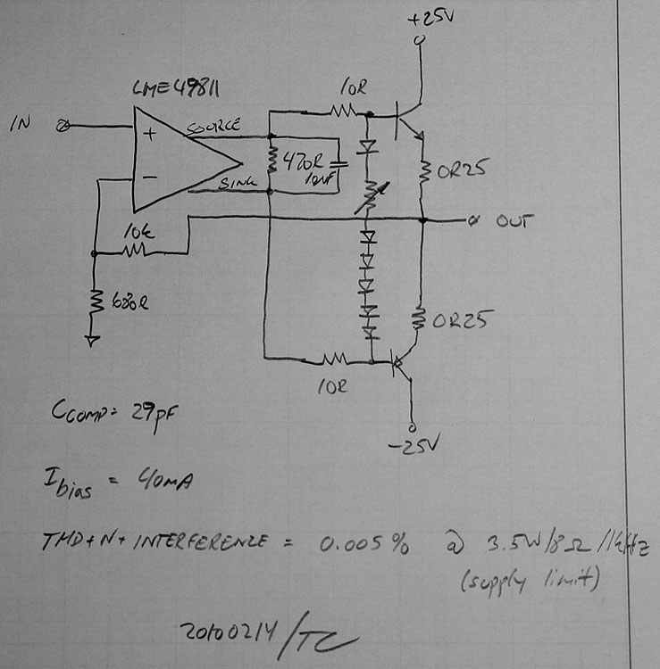

BTW: I notice that many people use a small (10 ohm seems to be typical) resistor in series with the base of the output devices. What's the purpose of this? Taming parasitic oscillation?

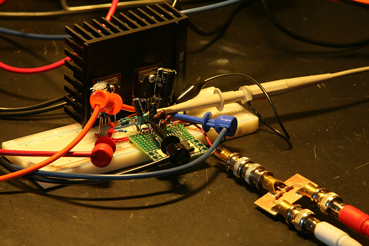

I have built a small proof-of-concept prototype (see attached). So far I'm impressed. Once I had the math for the bias circuit down, it was really a breeze to get going. I don't hear any hiss or hum in the speaker -- something that's confirmed by a quick look with a spectrum analyzer. The distortion is 0.002~0.003 % across most of the frequency spectrum at 1 W, 8 ohm output. Note that this is basically the noise floor of my HP8903A distortion analyzer. This is with a setup that's wired up on a solderless breadboard held together by double-stick tape and bailing wire. I did wrap it in grounded tinfoil for the noise measurement, though. That knocked the little bit of induced 60 Hz hum down from -93 dBV to below the noise floor. Nice!!!

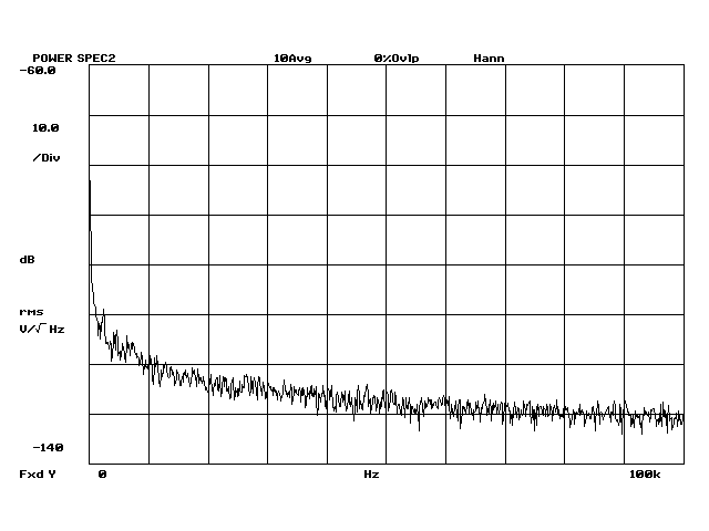

I have included the main components on the schematic. In addition, I'm using 29 pF (22||7 pF) for the compensation cap, 100 uF supply bypass with 10 uF || 100 nF at the chip. The final version will include the 75 pF + 3k3 noise gain compensation network that Audioman54 mentioned elsewhere. And of course, I'll have more output devices, DC servo, etc., etc.
The distortion plot is 1 W into 8 ohms with +/-40 V supplies (HP 6228B lab supply), 80 kHz bandwidth. Note measurement limit is about 0.002 % due to the noise floor of the HP 8903A.
Anyway. I'm looking forward to reading your comments on number of output devices and bias scheme. Meanwhile, stay tuned as the build progresses.
this is just a suggestion.
Miss out the 470r initially.
Add a 10r in series with the bias voltage adjustment pot.
Measure the current through the diodes by monitoring the 10r voltage drop.
Bring in the new value of the bypass resistor to reduce the diode current down to near Sanken recommendation.
Check the temperature compensation change from open circuit 470r to the new value 470r.

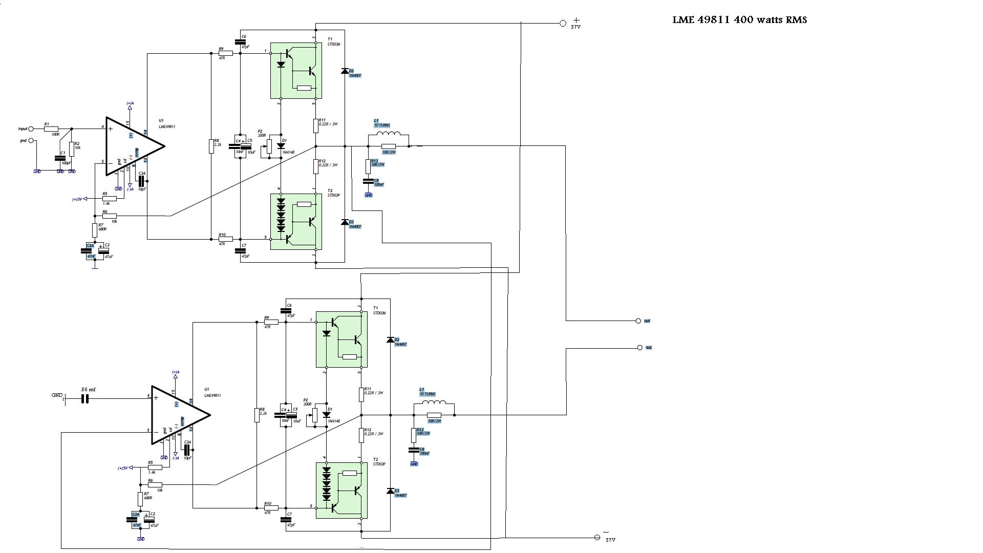

Dear Tom,
Here an example of my working STD03 amplifier design. To obtain more power I use a bridge configuration. Also for driving a subwoofer. This design works still flawless. I am stubborn and tied the diode strings from both pairs together. I stole this from Arcam who does exact the same in their P1 amplifier with two pairs of STD03's.
Ps. The STD49811 can't deliver enough current to fully drive two pairs on STD03's. Better go with the LME49810.

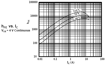

Here's how I think about it: I've attached the Hfe curve for the STD03. The worst case (-30 C, 10 mA Ic) Hfe is about 80. 0.01/80 = 125 uA base current. Surely, the LME49811 can deliver 125 uA... In the other end of the spectrum... Max Ic is 15 A per device. So 30 A for two pairs. 30/8000 = 3.75 mA. If I run two diode strings at 2.5 mA each, that becomes kinda marginal at worst case output current for the LME49811 (6.5 mA). So a little math to start the day:
One diode string: 2.5 mA. LME49811 w/c current: 6.5 mA --> 4 mA left for the output base current. 0.004*8000 = 32 A. Plenty...
Two diode strings @ 2.5 mA each --> 1.5 mA left for output. 0.0015*8000 = 12 A. That's getting low...

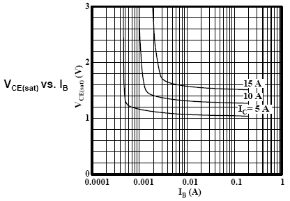

Another way to approach it:
Remember 60 V supply...
4 ohm load: Iout = 60/4 = 15 A (7.5 A per device).
8 ohm load: 60/8 = 7.5 A.
Looking at the Vce(sat) vs Ib curve (also attached), it seems that for 10 A per device I should have 2 mA of base current available per device. This is for an ambient temperature of 25 C. As the transistors will be on a fairly warm heat sink inside a chassis, I'd consider that a reasonable worst case calculation as Hfe increases with temperature. This calculation assumes that the LME49811 can drive the output stage into saturation - which it can't. The actual peak output voltage will probably be a good 10 V down from the rail, hence, easing the output current (and base current) drive requirements a bit.
Sorry for the thesis, but reading through the various LME4981x + STD03 threads, I've noticed *a lot* of chatter about bias current drive and I'm just wondering where all the confusion comes from. Maybe I'm missing something completely fundamental -- in which case please point it out to me.

Bias measurements
I'm starting to understand why people suggest using the LME49810 to drive the STD03's. If I'm going to use the LME49811, I will be limited to one diode stack. That's alright, though. The resistor that most people suggest to use between the SOURCE and SINK pins concerns me, though, as if it is designed to keep the current flowing in the diode stack at or below 2.5 mA at idle, it will take up all the remaining output current of the LME49811, leaving little to drive the output devices. Basically, the part of the LME49811 output current not drawn by the resistor will have to be shared between the diode stack and the output device base. Hence, I think the resistance between SOURCE and SINK should draw just enough current that the bias can be stabilized but no more. This is probably what leads to the 1~2.2 kOhm seen in most designs.
With no resistor between SOURCE and SINK, the bias is very touchy to adjust. I ended up at about 130 mA (65 mV across 0.5 ohm). With 2.2k it was easier to adjust the bias and I ended up at 100 mA. Slightly better still for 1.5k. I think I'm fairly comfortable with my current setup with 1.5 kOhm between SOURCE and SINK. I did not see any immediate signs of bias stability when tracking the bias current (actually the emitter-to-emitter voltage on the two STD03's) over half an hour. The attached data shows the voltage vs time at 5-second intervals. The step is caused by a change in input voltage to the amp resulting in a 0->15 W step in output power.
~Tom
~Tom

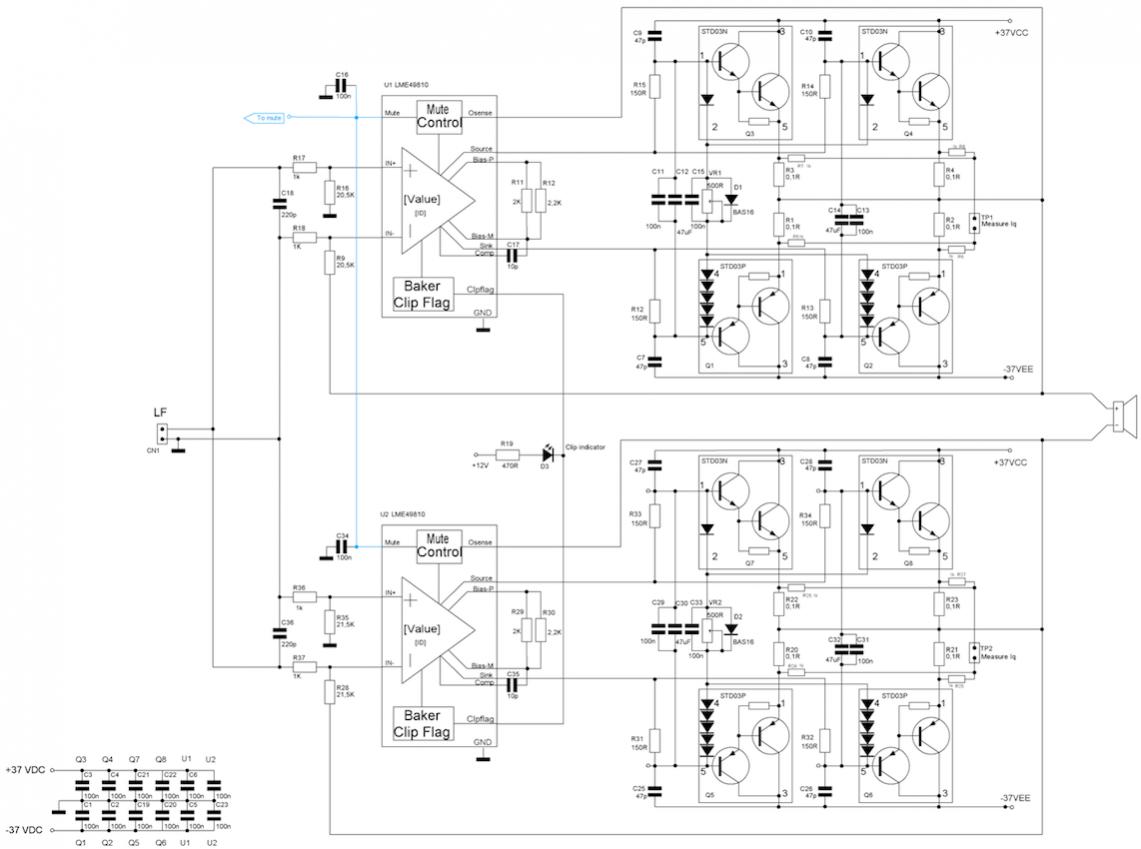

Is con2 2 a cold input from a balanced source or a signal ground?
The 5k6 passes just 8mA to the 411 and the Zener. This is not enough.
How much interaction is there between the two bias strings and their adjustment pots?
The input is from a balanced source. I realized after I posted the schematic that I need to bring out the feedback/input ground also.
Well... The LF411 max supply current (if I recall correctly) is about 3.9~4 mA. Then the output current should be added -- worst case 15V/28kOhm = 0.53 mA. That leaves the zener with about 3.5 mA. Looking at data sheets, it seems the 15V zeners are mostly tested at around 8~9 mA, though, I have yet to find one that actually *specifies* the zener voltage vs current. Anyway... I think you're right. I should probably up the current through the zener some. Go with a 3k3 instead (--> Izener = 9 mA). That would lead to a power dissipation of 614 mW in the resistor. A 2 W is probably OK, though a 3 W type would be nice.
That's a good question. It has crossed my mind as well. I'm really just going with what Sanken recommends at this point, thinking that if I don't like it I can pull one pot and run on one diode string, connect the two strings in parallel with just one pot, etc., etc. The changes would be easy to make with a little "blue wire" and shouldn't hurt circuit performance in the end. I am quite curious to see how the bias adjustment turns out. I fear it'll be a ping-pong game between the two pots, but we'll see...

So... Off the solder-less bread board and onto a PCB. I skipped the local supply filtering (R2, C3, R22, C13) due to space constraints. I'm currently running off of +/-50 V (the max my lab supply can provide). I'm seeing 0.007 % THD+N at 35 W output power, 1 kHz, 8 ohm load.
I fiddled with the bias adjust. With the resistor across the diode stack - R12 in the .pdf schematic - stuffed with 2.2 kOhm, the bias is very, very hard to get equal between the two pairs of output devices. I tried placing the two pairs of diodes in parallel with just one adjustment pot and that worked a bit better. The emitter-emitter voltage (across 0.44 ohm) was about 10 mV different between the two pairs of output devices. So 30 mV for one pair, and 40 mV for the other. Desoldering R12 and leaving it open, while having two adjustment pots (basically as drawn in the schematic less R12) made it possible to get the two emitter-emitter voltages to match within 3 mV. So I think that's what I'm going with. It will result in almost 4 mA through each diode stack, but the bias stability is NICE and the response time to a step in output power seems instant.

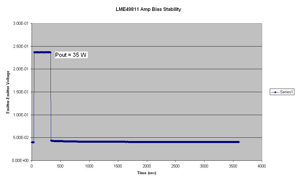

Attached is the emitter-emitter voltage response to a 35 W step in output power. The idle current is about 100 mA per pair of output devices (40 mV across 0.44 ohm).
~Tom
In my case for 49811 with two-pair ThermalTrak, I recall that there was about 2 mV difference for 22 mV across 0.22R emitter resistor.
The step response looks good!
I was really quite impressed by it! On my previous setup (LME49810 + MJE340/350 driver + standard Vbe multiplier) it took over an hour for the bias current to decay after a load step. With the LME49811 + STD03, it's nearly instant. The slow settling following the step is basically the thermal time constant of the heat sink.

Is there DC blocking in the source component?
C2 (DC block on NFB is acting as a high pass filter) seems a bit small. try 3 to 5times bigger. C2 should be connected to the input/signal ground.
R8 (2k2) may need to be adjustable to tune in the temperature compensation.
How does the inverting half source current for the +IN & -IN pins?
What is the resulting output offset?
I don't understand how the inverting side is set to unity gain. Is it?
plz look this.................nd give a coment whether it will work or not......it is given by my friend..........
The gain setting is wrong R1/R6 currently set at 100 should be around 27 to 30 Change R1 to 1k and R6 to 28k. You'll never get 400w RMS out of 37v supply. Without doing the math, it's probably 50w.
