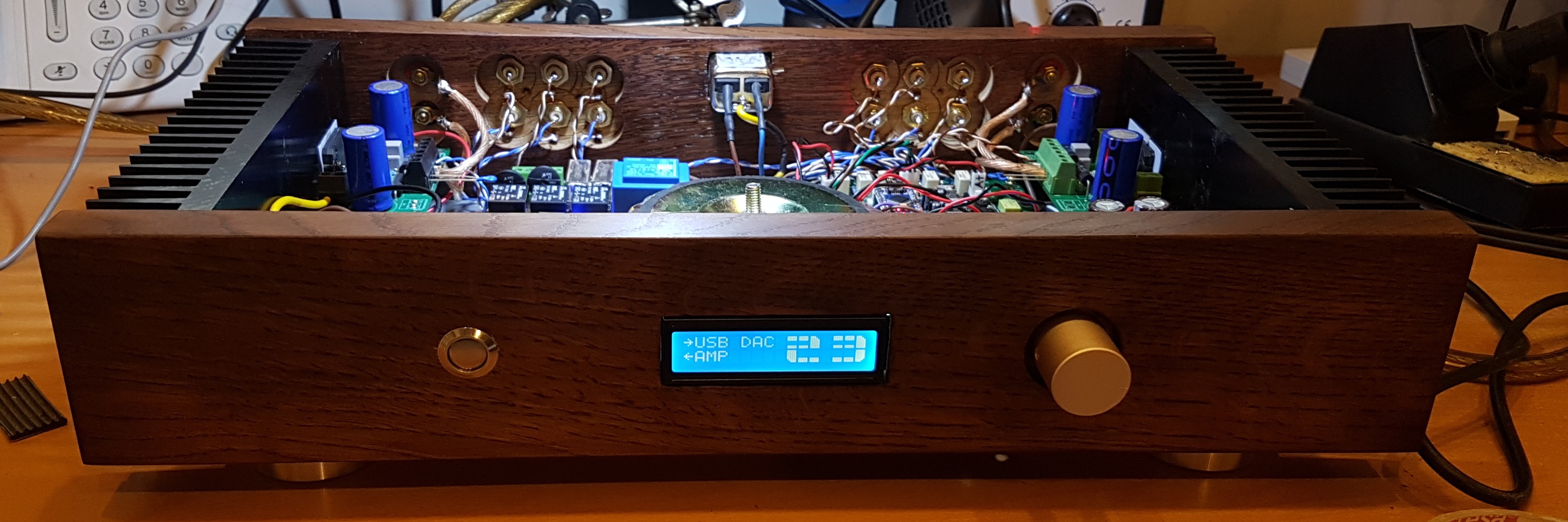

My oscillation issues were resolved after simply putting 220pf cap at the input. Now it's dead cold and silent, even with nothing connected at the input. I am using VxD for volume control which is tricky, as the input floats while the VxD boots up and initializes all the relays and LDRs.
