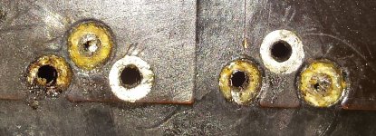

I finally got around to checking the outputs for this amp and sure enough there were two outputs that were bad.
In addition the trace around the board where the legs go through is also damaged. See attachment.
Does this need to be repaired and if so how do I go about doing that?

If you solder the connections on both the top and bottom of the board, you don't need to do anything else.
Acetone and cotton swabs will remove the flux and make it easier to see how bad the damage is.

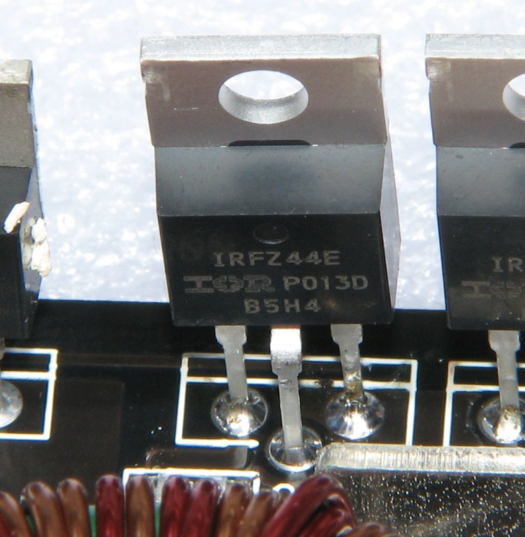

You need to bend the center leg out (will allow the leg to flex) as shown in the attached photo.
