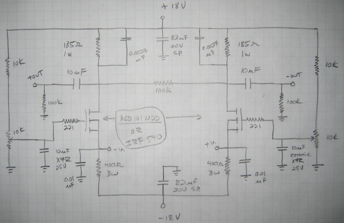

I have been investigating the Pass D1 I/V stage a bit more. Reading through Owen's thread, it occured to me that the power on transient of the circuit causes the DAC output pin to be pulled negative for some time until the gate of the MOSFET is pulled up to it's steady state resting point.
I assume you are familiar with the circuit. I attached Owen's schematic. OwenD1.jpg
Since the gate is driven by a resistor divider (with a large filter cap) it takes a long time for the voltage to come up. However, the resistor to the negative supply comes on immediately with the supply.
I am worried if I use this with the PCM1794 chip the outputs will be damaged during power on. The datasheet says the maximum current for any pin is 10mA, but that is all. No other information given. Since the part is powered from only +5V and ground, I can see a large current could be "pulled" from the chip to the negative supply through the MOSFET source resistor.
Do you have any experience with this?

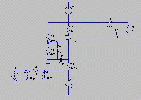

But, looking at the ecdesign thread, I seen a mosfet I/V amp, I include the circuit image, how about this one ?
It is not REALLY an Amp. It is a current conveyor, similar to the circuits using Diamond Transistors.
The issues here are that the I/V resistor is not referenced to ground but to the supply rail, which means there is zero noise immunity to power supply noise and the output carries substantial DC levels neccesitating a suitable coupling capacitor (I do not feel the quality of the one ecdesigns promotes suffices BTW). So the apparent simplicity in the I/V section is paid for with increased complexity elsewhere.
Remember TANSTAAFL.
So to make this circuit work really well you need a very esotheric powersupply with very low noise and an essentially linear impedance that should be in the audio range preferably 100000 times lower than the I/V resistor and a high quality coupling cap.
This gets very complex and expensive quickly, but the results of such simple circuitry (and the complex external circuitry) when it is done well can be quite outstanding.

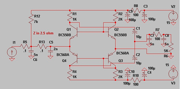

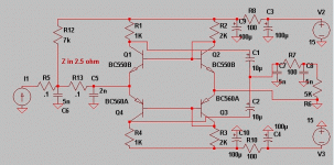

I've look again in the very long ecdesign thread and there was another one with bjt transistor, here it is.
How about this one ?

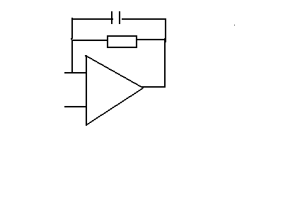

One thing I don't like with opamp are that they need lot of negative feedback to have low thd
This is debatable. Feedback is just another tool.
Ideally the open loop bandwidth of a circuit before applying feedback is at least twice that of the (fully bandwidth limited using a function parallel to that of the Amplifier open loop gain rolloff) signal.
Using very fast (CFB) structures can fulfil this requirement easily, even for the fast changing output current of a DAC. If using rather "slow" amplifiers within feedback loops it may be necessary to to slow down the signals to something the closed loop system can handle, with a cap on the inverting input/output of DAC.
and the input transistors on the die are so close to the output transistors that they are prone to oscillate.
I don't think you have this right. Op-Amp's, discrete, monolithic etc. oscillate due to the feedback loop and the fact that feedback signal eventually rotates phase such that the negative feedback becomes positive feedback.
I feel you just want someone telling you "build this one", please do not expect such answers from me. Analyse the schematic you have shown and consider the issues and problems with it. This will then allow you to make correct choices.
If this is too much for you, just fit OPA627 without any further modification. This is safe, will sound good and does not require any special skills or knowledge.
