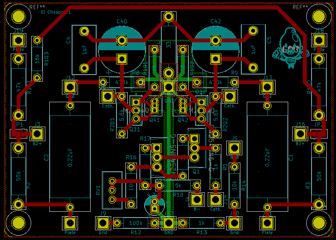

I'm having trouble coming up with a grounding scheme for my El Cheapo build. I've searched and read a lot, but I fail to see the bigger picture.
I've scrolled through the ppt and other documentation from hifisonix (thanks rayma), I've read Merlin Blencowe's chapter on grounding and read several threads. For my two guitar amps I've followed Blencowe very closely and that worked like a charm. Now with two channels, I don't know what to do...
In order to get the discussion going I've got this image with the ground path in pink. Some ideas that are incorporated:
* Only one ground point at the input
* Ground loop has little area
* input references connected together (to ground)
* B+ and ground are twisted together.
Another idea would be to do it more like section 15.11 of http://www.valvewizard.co.uk/Grounding.pdf . That is a multichannel amp, not a stereo amp. So I guess we need to move the connection to ground to the 'non-audio grounds'.
Fire at will!
If I understand your diagram it looks like you are making a bus for each channel based on you previous projects of mono amps, sorted very well it seems, and then turning this into a loop by connecting the 2 "big" current ends to each other, and the 2 "small" current ends to each other. If so, then no, you want to make 1 bus.
Yes, I'm making a bus per channel (as I did with single channel my guitar amps) based on Blencowes 'improved bus/multiple star' ground, grounded at the input (the 2 small current ends). And yes, I'm connecting both busses also at the power supply choke (the big current ends). I realised I had a ground loop, so I routed the grounds as indicated by the pink line in the image in the first post. That way the area of the ground loop is very small and magnetic induction will not be a problem.

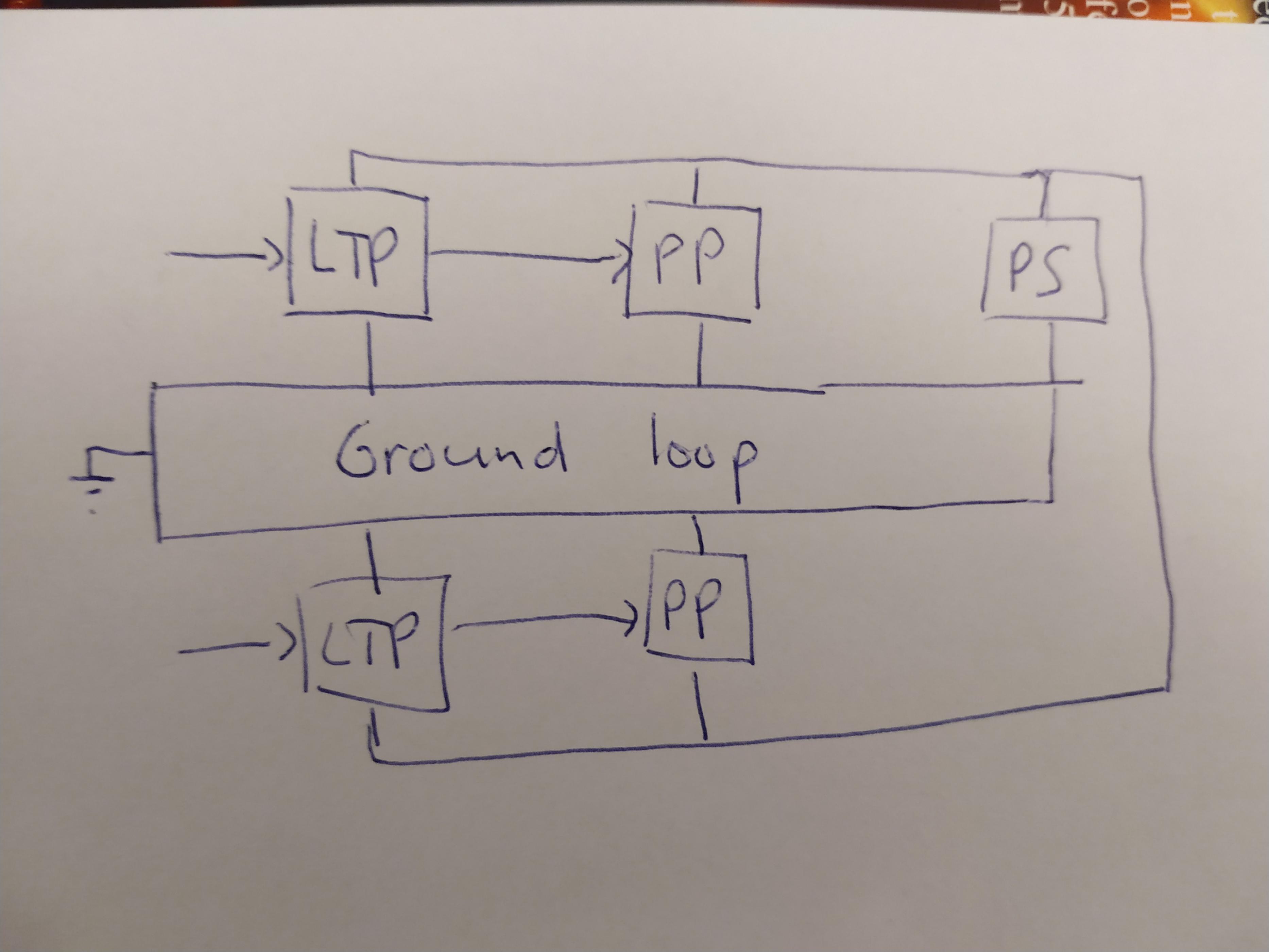

I made a sketch as trobbins suggested. (see attached image). The image in the first post is basically this, but with the B+ and ground twisted and routed through the amp so that the loop area is small.

@leadbelly: So your suggestion is to simply 'collapse' my ground loop in post #7 to a single bus for both channels? That seems simple. But if it is that simple, why doesn't everyone do this? Isn't it a problem that (return) currents from one channel modulate the ground level of the other channel?
Sorry, can't help with existential questions. 😀
Grounding can be made to work in more than one way. Star grounds and intentional looping can be made to work.
IMHO the path of least resistance (pun intended) from your design to a working design is the single bus.
Well, at least in theory I can twist or shrink wrap most of the ground wires making the 3D area small. Don't know if the cure is worse that the decease though...

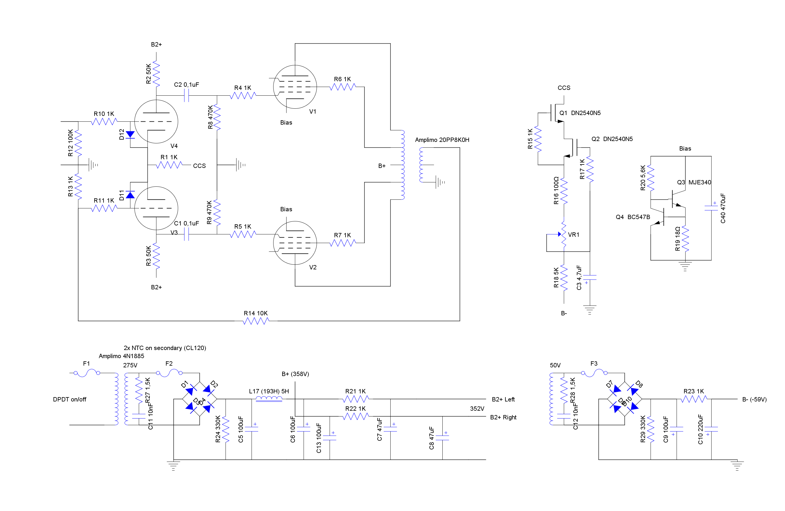

Can you be more specific about 'back to the choke', as there is no detailed schematic in this thread, and channel powering doesn't normally split 'at a choke'. Also any comments on layout require a good understanding of what you have or propose (ie. a schematic and the layout diagram marked up with key parts, given this amp hasn't progressed to operation yet).
Getting beyond Merlin's discussion, and introducing other noise ingress paths, is likely very dependant on the actual hardware and layout you have in place, and the external signal sources you are using, and whether this relates to a tangible noise or hum issue (ie. you can hear something, or you are chasing a certain SNR and have the equipment and setup to make measurements).
At this stage, given you are preparing what appears to be a guitar amp, I'd just go with a simple single 0V link to chassis from the most downstream common point, and use isolated input sockets, and then test.
Load current from one channel will also use the bulk capacitor from the other channel unless you include some L or R series component, if better channel separation is an aim. At the moment C6 and C13 are somewhat equally the last common 0V node, and perhaps simplest to use that 0V node as link to chassis, and to use insulated input sockets.
If this is for hi-fi, then what test equipment do you have and how low a noise floor do you want to achieve and can you test for that?
Preferably your schematic should unambiguously show where the 0V to chassis link is connected, as well as where other ground connections star to.
I agree. I think 220uF was not available at my supplier and came up with this idea.
So basically the second idea from post #1.
