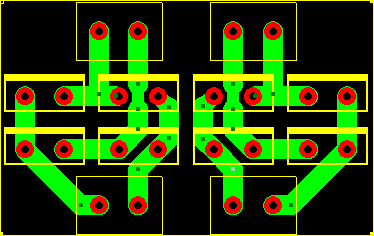

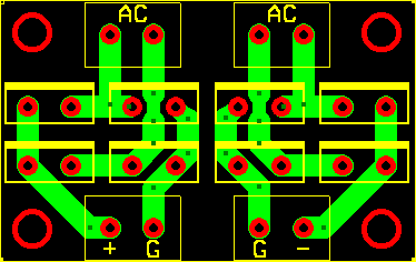

Double bridge rectifier!
Did I won something?
(Ho vinto qualche cosa? 🙂 )

Sorry...
I forgot to say the bridge pcb is designed for the ON Semi MUR860 diodes. Connectors are my beloved (=cheap) Weidmuller screw-type, 2 poles, 12A, model 1760490000.
RS code: 408-7871, Digikey code: 1760490000-ND.
Have a pleasant night,
Massimo

Don't forget that you can parallel your trace on the other side of the board for nothing if you order from ExpressPCB You have to be careful where you put your "text" on their boards since it shows up as copper on the finished product.peranders said:
100 mil traces can cope with more than 4 ampere!

Hi Jackinnj,
Thanks for pointing that out. I used only the bottom layer to help the "press-and-peel" guys.
Traces and text should share the same encoding: yellow->silkscreen, red->top copper layer, green->bottom copper layer. Did you noticed anything in the wrong place?
Ciao,
Massimo
Ciao,
Massimo
