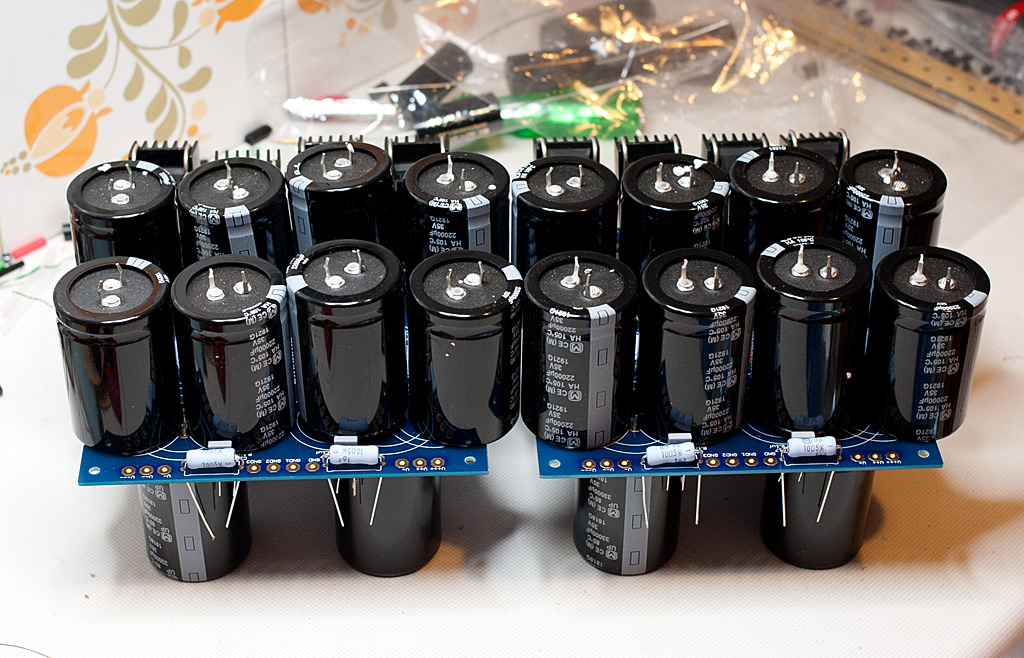

Apart from the 35mm 22kuF caps, I also forgot the 1/4w led ones. Which is no big deal since their value is not critical at all. I will use some 25k ones I already had.
Also the ohmite heatsinks for the diodes proved difficult to work with. The securing wire is stiff and you have to push them hard to fit. Really I see no reason why someone would want them rather than the ones with the screw/holes.
So here is one without the top caps
And here is one with the 35mm ones on top
Again, the most awkward part would be securing the boards on the chasis. It s going to need some looooooooong spacers

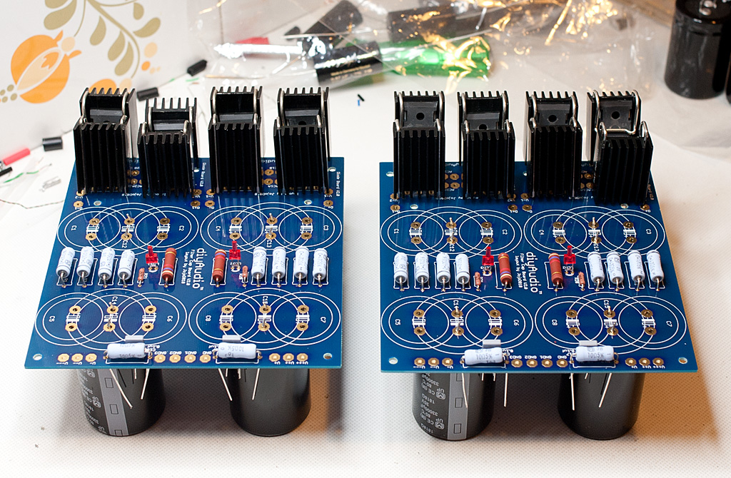

Just finished soldering the first psu board.
Here comes a small review of it. Nice one overall. I do not regret getting 4 of them. But I have to say that they have some design limitations.
First, with diode heatsinks in place, the space available for the jumpers (from rectifier to CRC part) is really tight. So tight that in case the jumper insulation wears off, there could be a short. I will try to fix this by soldering the jumper as close to the board as possible, and lifting the heatsinks as high as possible from it.
This reduces some mechanical strength on the rectifier part, but I don t think it will be a problem, as long as the diodes are not bent accidentally and the heatsinks do not touch each other... It is getting weird though... too many conditions.
I should use isolation pads on them. Or some mechanical spacer below the heatsinks to prevent the diodes from bending.
Second, the soldering pads for the 3W resistors are very thin. This makes them difficult to heat (I use an Ersa station with a 3mm chisel tip @450 celcius) especially on the center of the board where the plain is huge. And it is very easy to overdo it with solder (trying to get some flux and solder there) creating blobs on the wire and further making it difficult to see if the solder has properly flown on the pad. Pre-cutting the wires makes it a bit easier, but again it can get messy easily.
Third, my idea of soldering caps on both sides is a bit tricky with 30 and 35mm caps. With the caps tightly soldered close to the board, the pads of the other side caps are way too close to the cap of this side. So soldering the other side might destroy the center capacitor. I will try to get some spacers there to give the pads some air to breath.
And something minor. The led marking is really vague, so you have to go around the board a bit to figure out which way to solder them.
Anyway, it s a nice board and again I do not regret buying them.

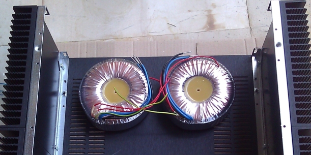

Well I have asked around and did not receive very good input on the local toroid ones. The EI are considered good, but I really don t like the idea of having separate PSU units. I usually like the Hammond ones (from mouser), but unfortunately they do not have big ones with 18V secondaries.
I was considering some French or Polish ones I was told about, but decided to get the Antek ones after all.

You guys mean toroidy.pl right?
I really hate it when there is no on-line catalogue![]()
That's the one!
By the way, the photo above does not work.
Sorry mate...
The polish are pretty good actually. I'm using two of them in my own build.
Price for them ? Including shipping?
75 euros each shipping included. But it's been a while now...
