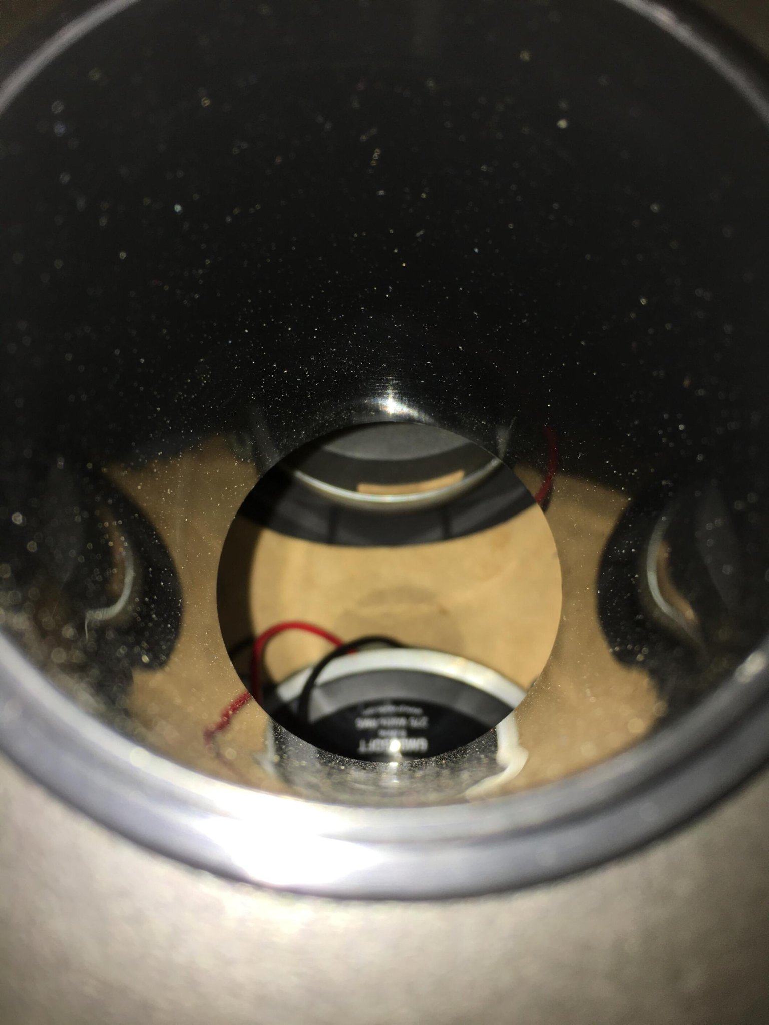

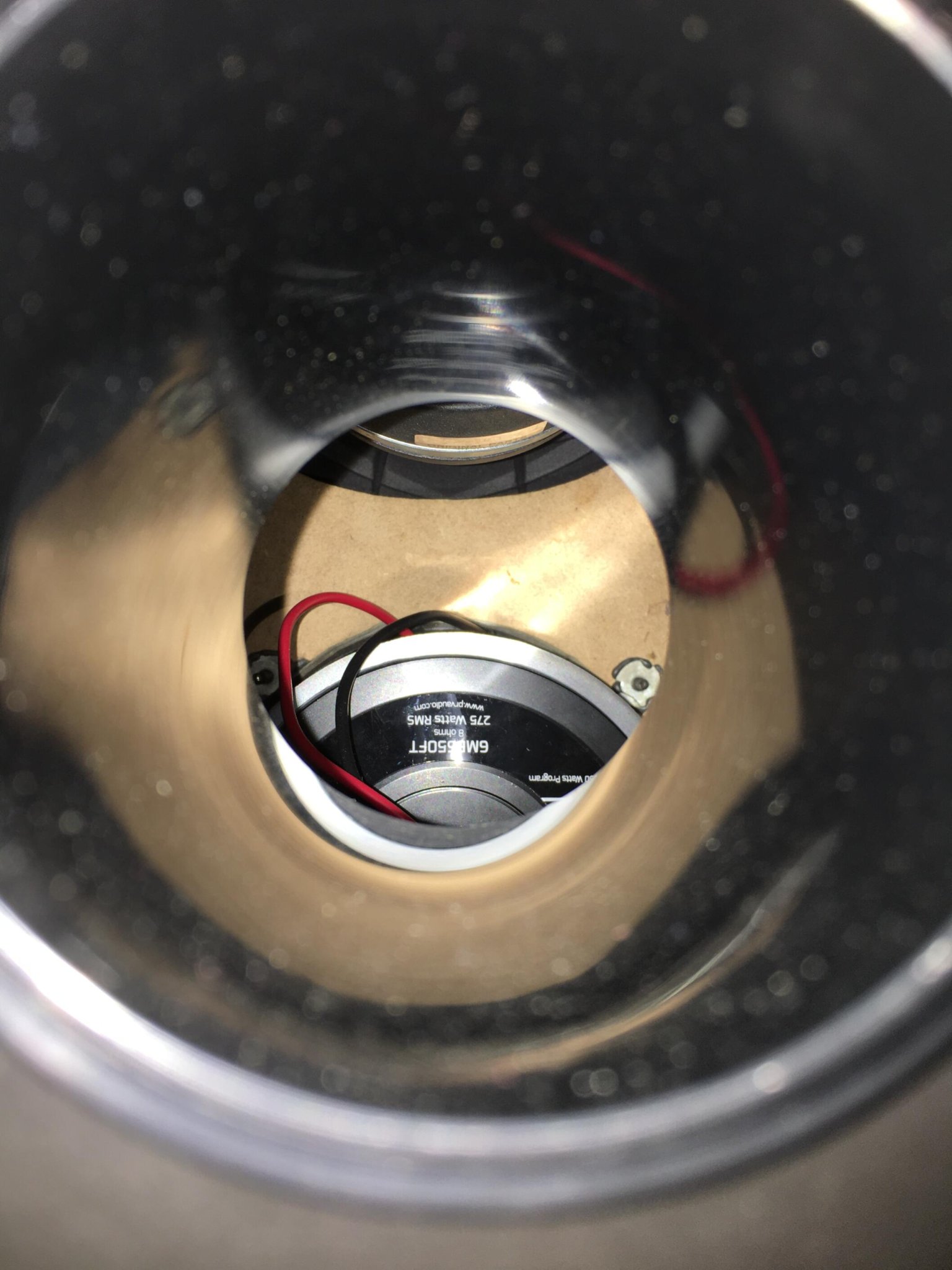

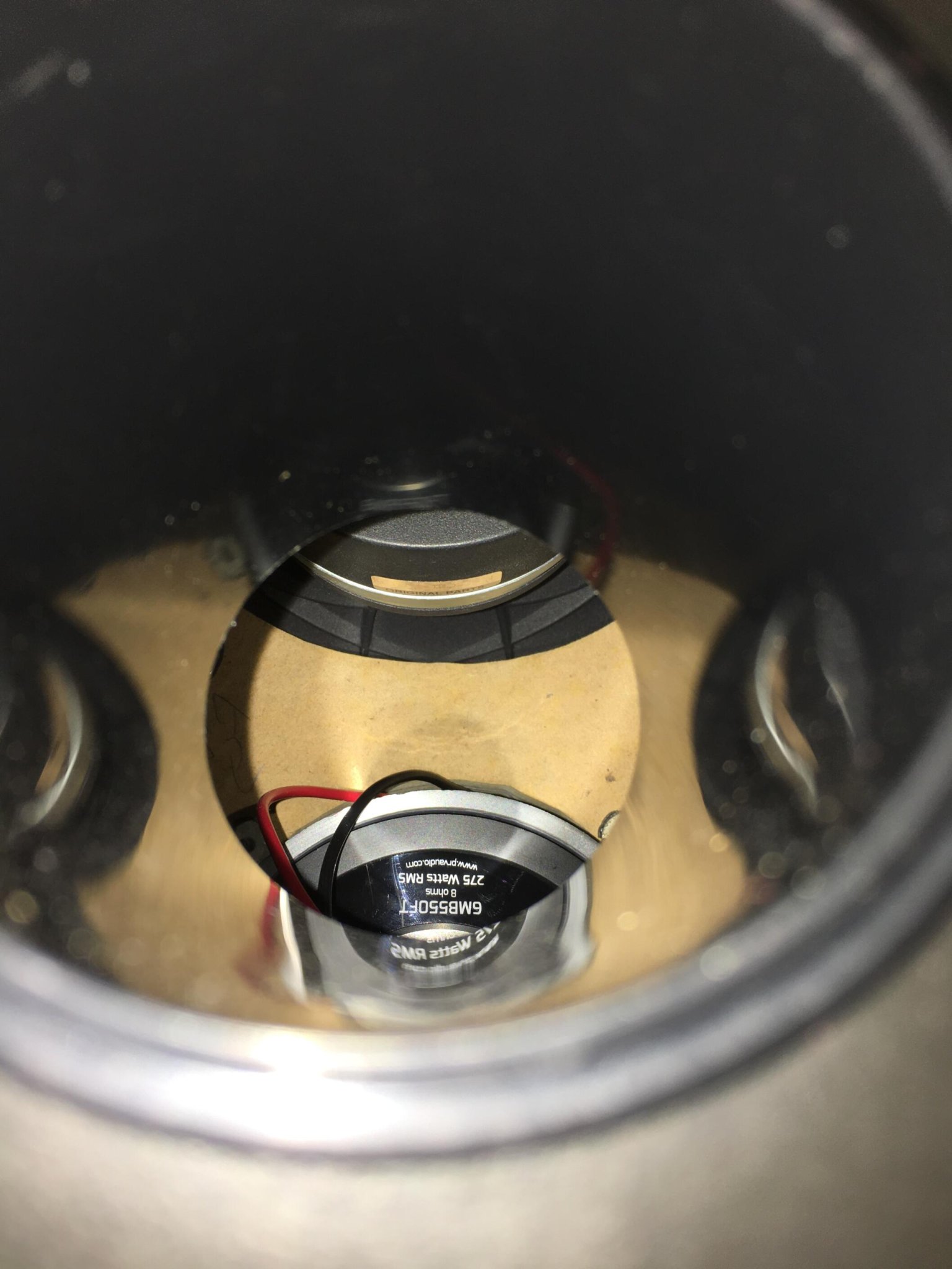

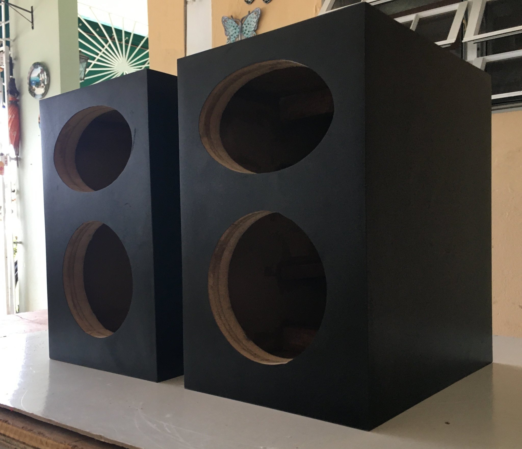

Forgot to post the images of the bookshelf port inner view so here are few, I'm also a fan of the front ported boxes and mostly with ports placed in the front low, but made an exception with a down firing design like I did on my 21" Down-Firing Port Subwoofers.
Between due space constraint in the bookshelf I have to place the port in the back of the little boxes in between the tweeter and the woofer, I could place it a little higher to get away from the midbass but the horn and the compression driver could be an issue due they too close proximity.
Regards
@JRiv : my edition is French, from 1996 - and is full of re-typing and translation mistakes that I had to correct and annotate, ma parole, j'y crois pas 😡 ! - So that I plan to buy the English language one... So I think that the matching edition in English should be the 1995 one you mention.
Vance Dickason about back-sided ports wrote IIRC : "maybe it will slightly decrease bass response in axis if the port output is too close from the wall". He made several position configurations but did not came to a general undisputable rule of placement.
A friend of mine made heavy cut and try tests on a project similar to my 375L vintage Monitor in size, and determined that the best placement of the port was at the back at 1/3 of the height for this project, but on another one, a bookshelf similar to my 222L, the best placement proved to be in front... It seems that it is a case-by-case basis.
When my acoustic measurement rig was still valid, I experimented rather center-placed port formulas, in order to "pick" the sound pressure belly (= speed acousic air displacement), conversely to the faces, where only node pressure can occur ( notably responsible of the panel vibrations). But this idea proved rule-inconclusive, or again a case-by-case basis !

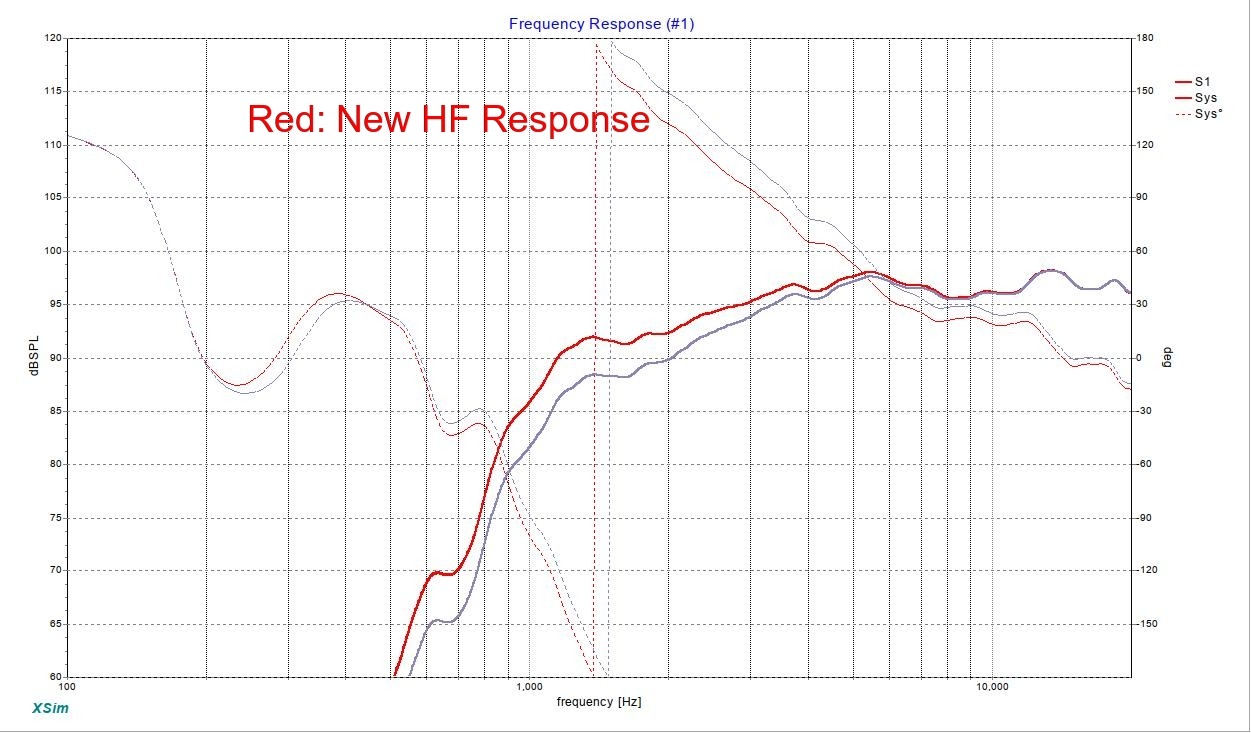

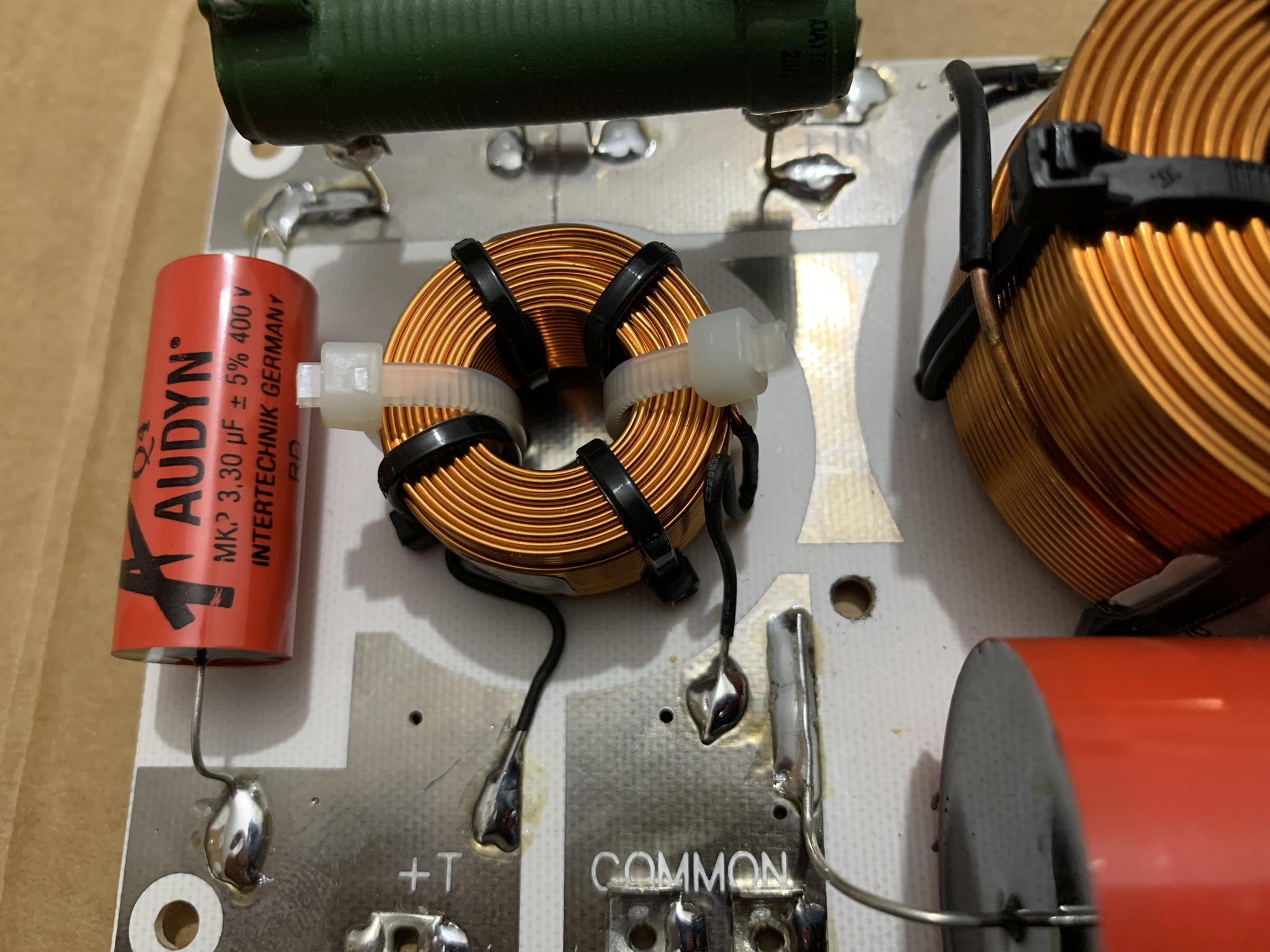

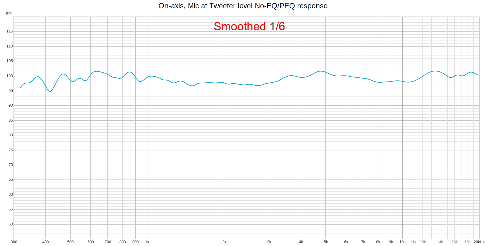

Hi, just a small update in regards the crossover in this old little project.
I just decided to tweak the crossover a bit to make it a little flatter response in the middle frequencies but without modifying the low-pass xover to avoid introducing mids distortion at high power levels due early cone breakup etc.
Then since the compression driver is the least stressed/driven part in this speakers I've opted to lower the HF crossover point just a tad, so just changed the 0.35mH inductor for a 0.5mH, and changed the 2.7uF capacitor for a 3.3uF and they opened up nicely, here below is the info for reference.
Here is the simple crossover mod:

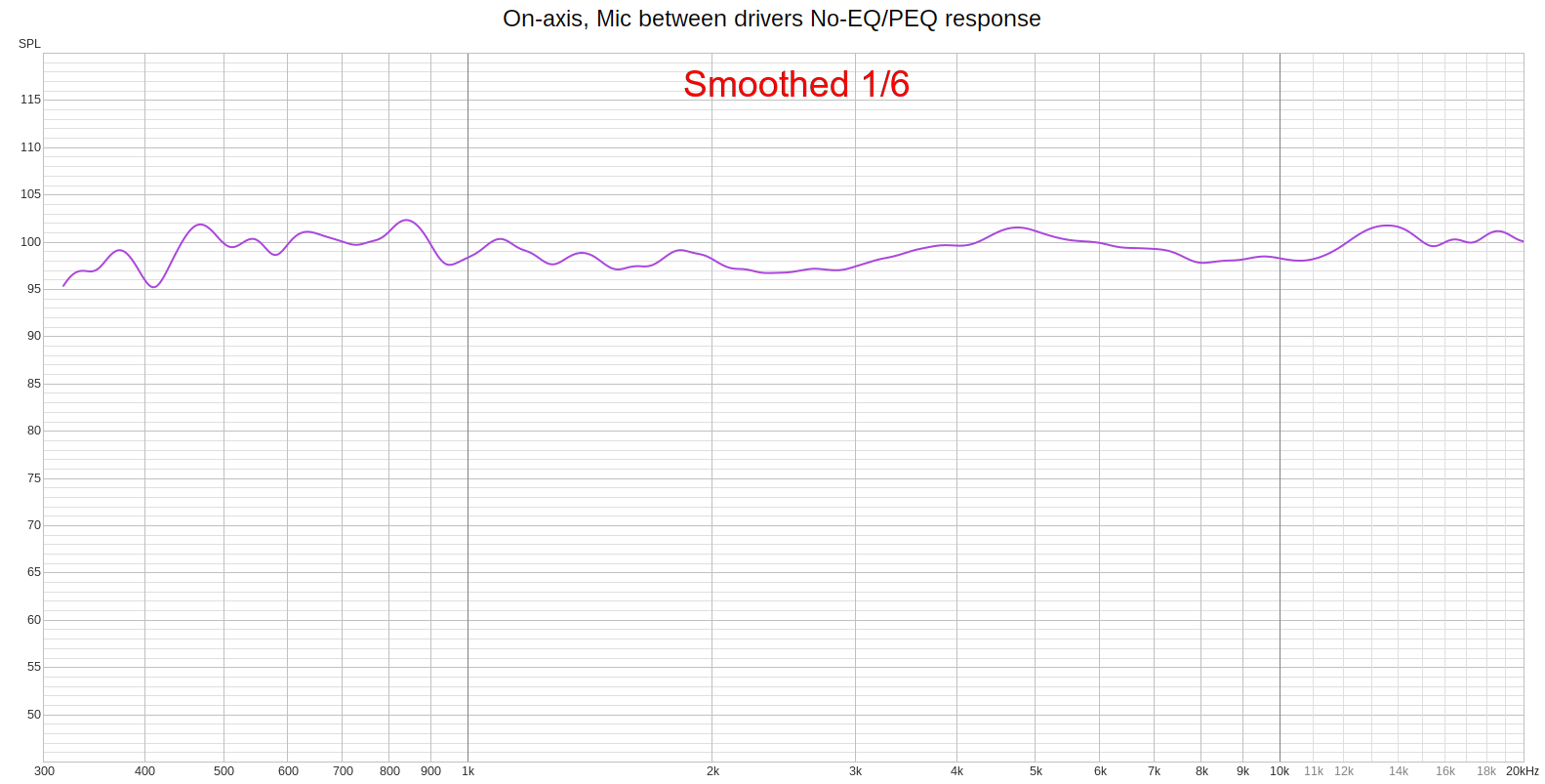

Here is the bookshelf response with the mic on-axis at tweeter/horn level and in between both drivers:
Between with just a little EQ/PEQ from the DSP this little speakers can be flatten from ~250Hz up but wanted to show just the raw response, also sorry I can't provide measurements of the lower frequencies since my room is too anemic and contaminates the measurements with tons of peaks/valleys reflections.

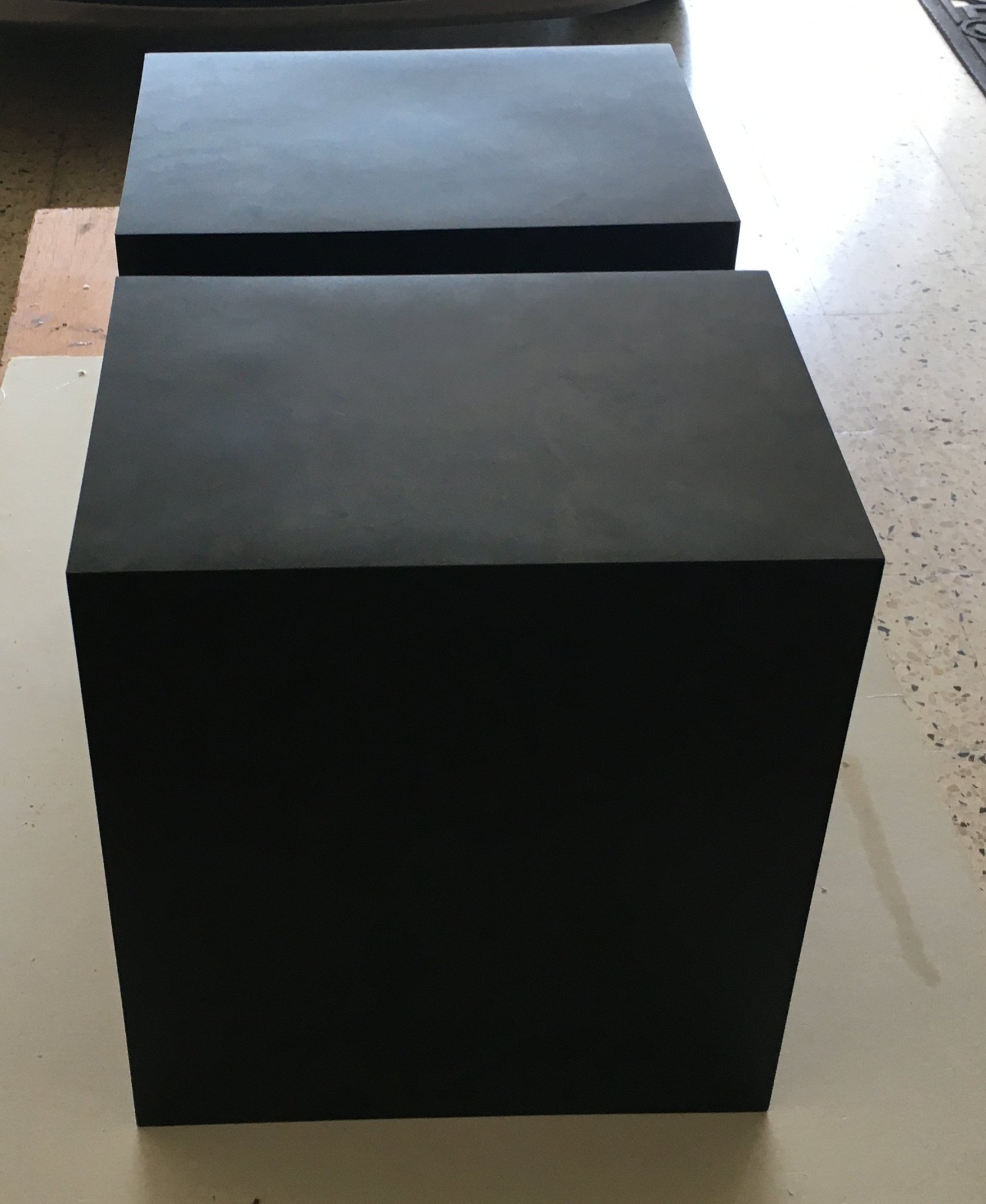

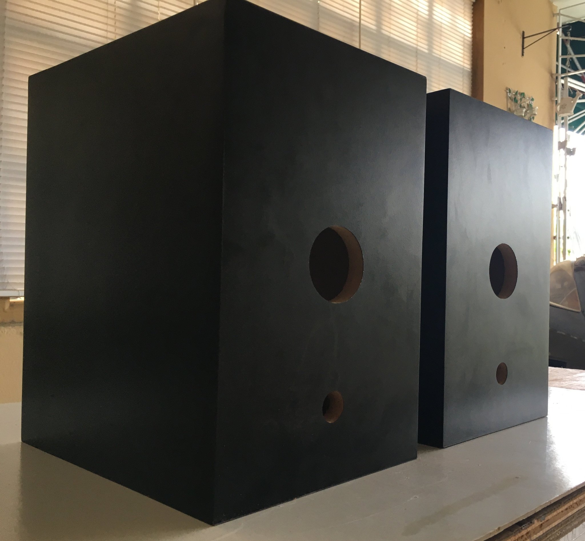

Imagine painting them in an unusual paint called Vanta Black. It's a nanotube-containing paint that absorbs over 99% of light that strikes it, so an object painted with that has the appearance of a black hole. It's a void!
Hi @egellings I've always used standard Black-Matte laminate as it is cheap plus so much easier(subjectively) to work with and I always think it will also provides an extra layer of box protection as well, unfortunately I was never good at painting and I admit Piano-Black is my finish of preference.
Regards!
