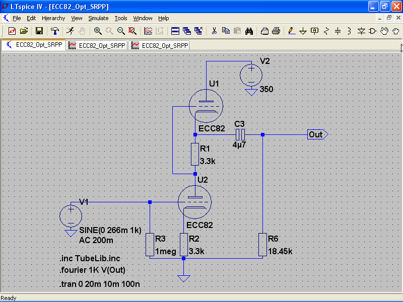

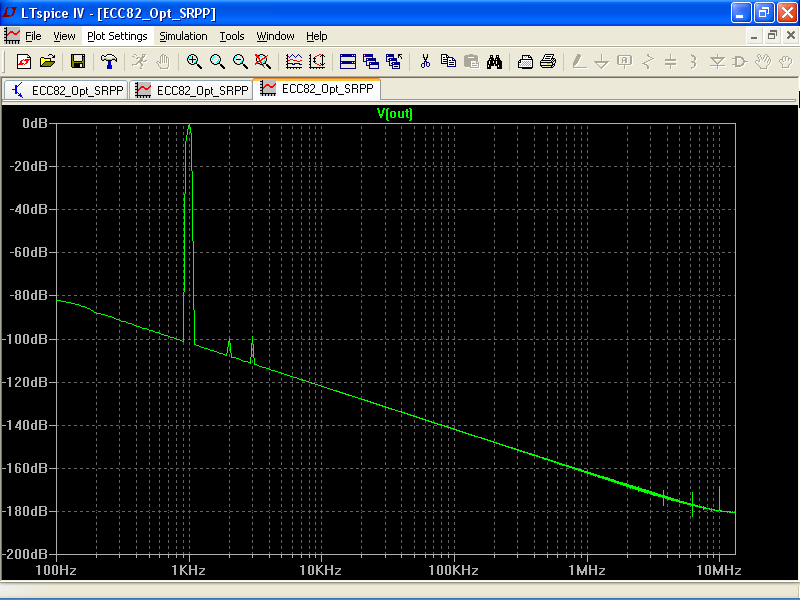

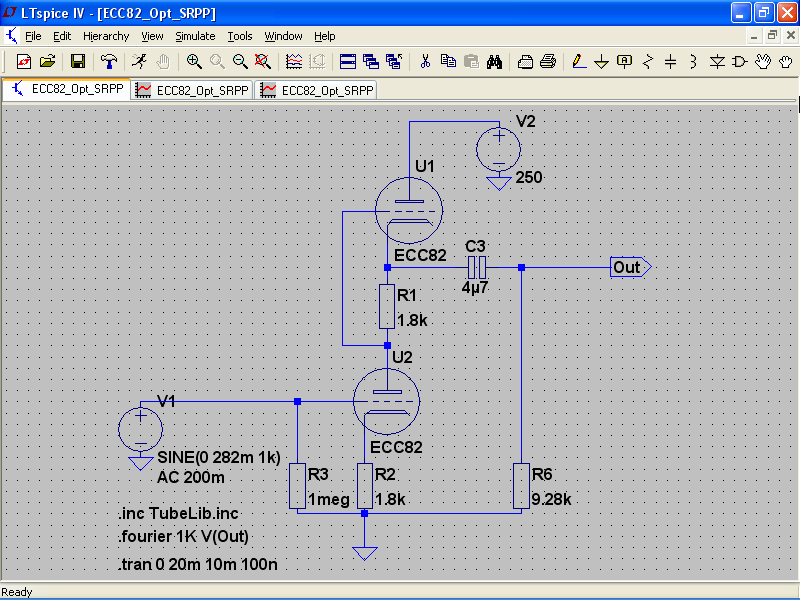

Hello Popilin,

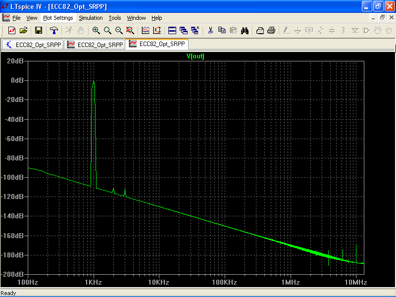

I spent some time reading White Cathode Followers over at tubecad.com. WCF’s also operate in push pull. They operate with similar theory and similar magic formulas to optimize the balance of push pull operation.
The discussion of WCF’s says that power supply ripple is much reduced at the output when the push pull balance is optimized.
We have discussed the improved distortion performance of optimized SRPP amplifiers. This has set me to wondering about the PSRR performance of a SRPP as the Push Pull balance is optimized.
What do you say? Will you take one of those LTSPICE simulations and add 500mv of AC ripple to the HT supply and see what happens to the power supply rejection ratio as the circuit moves through the optimization notch.
DT
Hi DT
As far as I know, PSRR performance of SRPP is quite poor, around -6dB, nevertheless this should not be a problem if your PSU is good enough. 😉
500mV is a lot of ripple, even for a simulation, indeed, results are horrible. 😛😀

Yes SRPP typically has a not so good PSRR. The white cathode follower is in the same boat. However the WCF has a much improved PSRR when the Push Pull is in critical balance.
My question, is this also true for the SRPP?
yes 500mv is dramatic. If there is any reduction in ripple at critically balance of Push Pull it will also be dramatic in the simulation, us less ripple if you like.

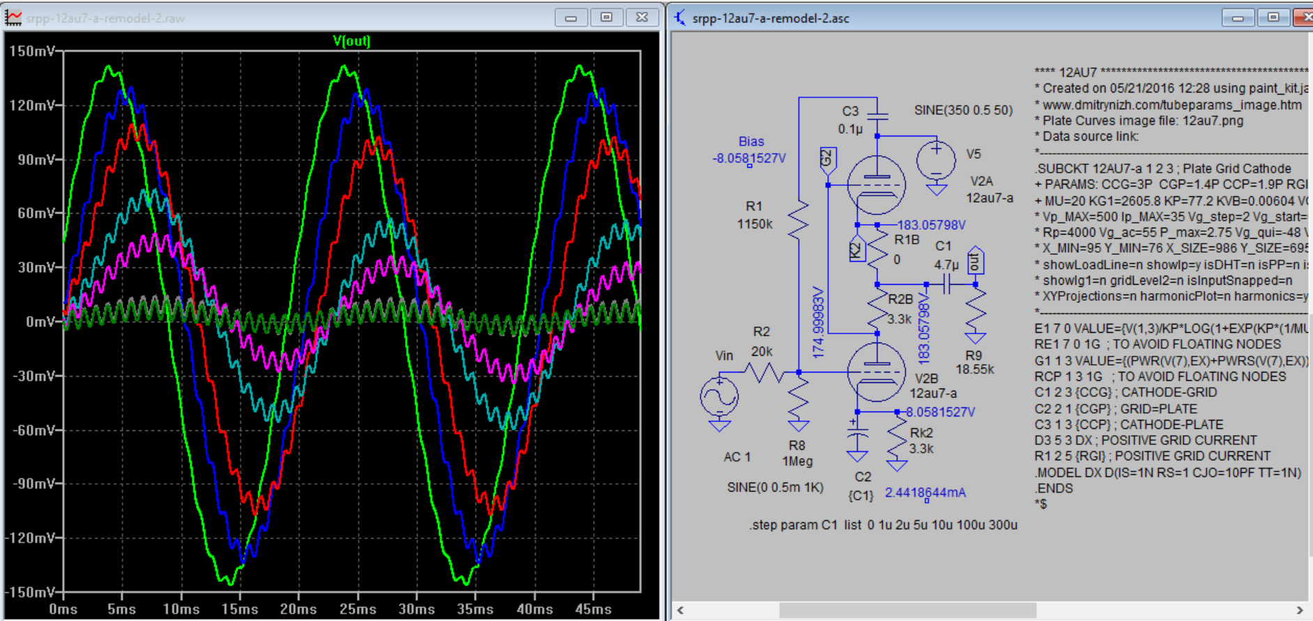

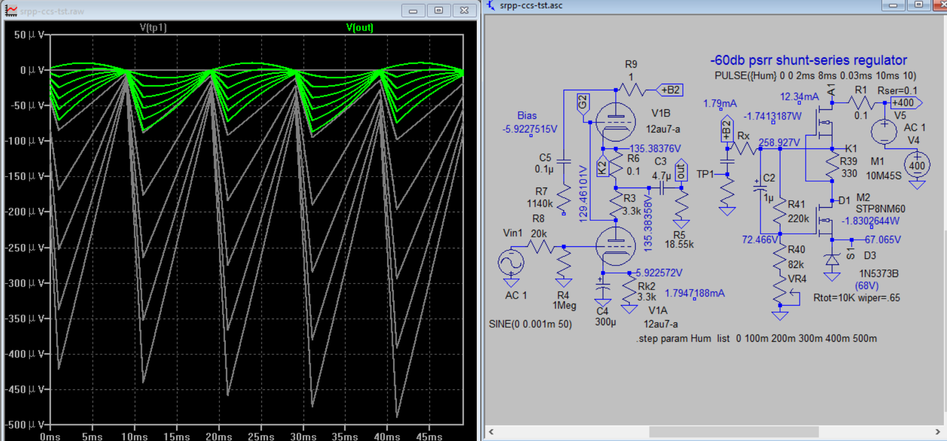

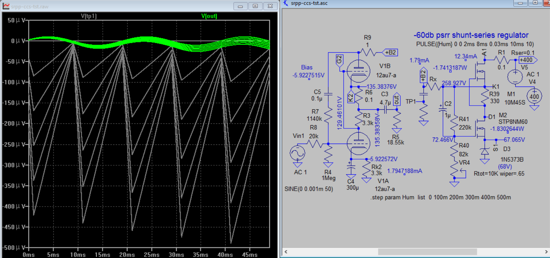

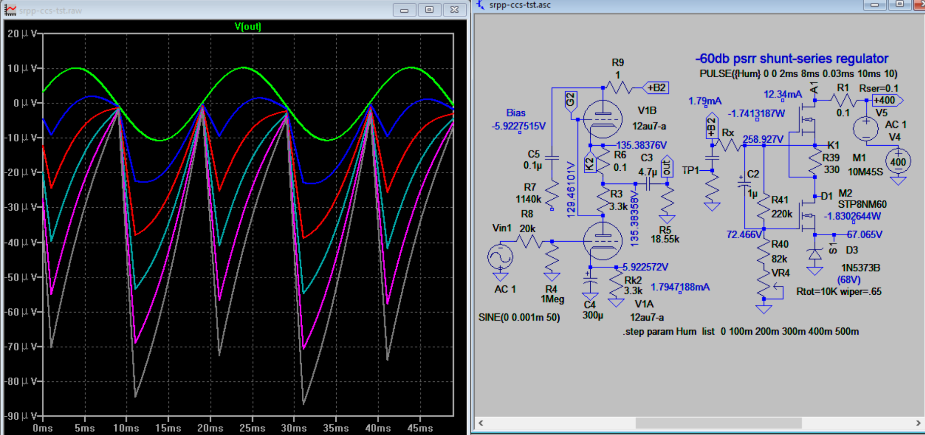

PSRR of SRPP improved somewhat as usual when the cathode is bypassed as well as this sim here shows. According to the sim, PSRR is greatly improved if Broskie type of PSRR mod is added and null occurred, and similar calculations of RC pairs maybe applied. A minor change of load or cathode resistance does not affect the PSRR much.

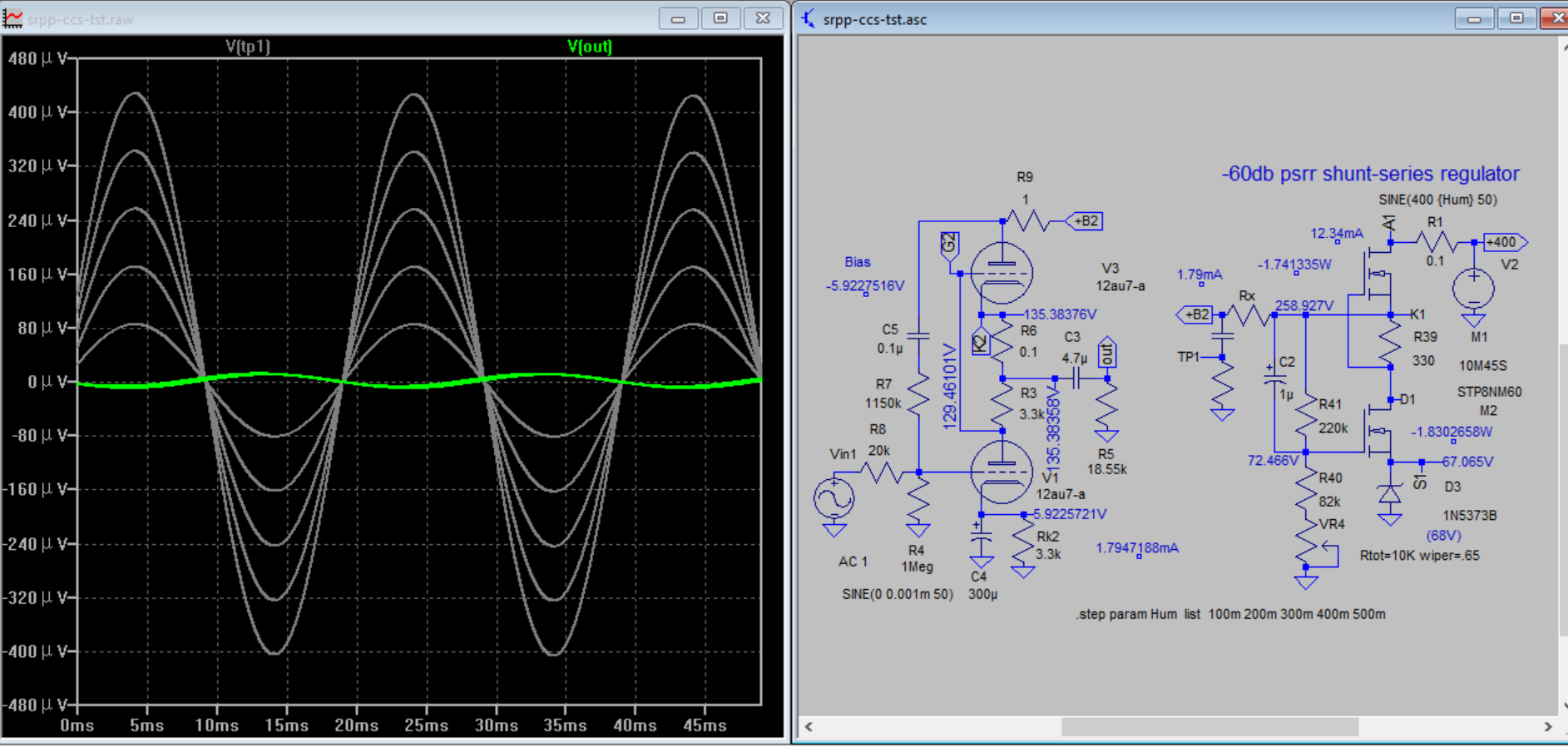

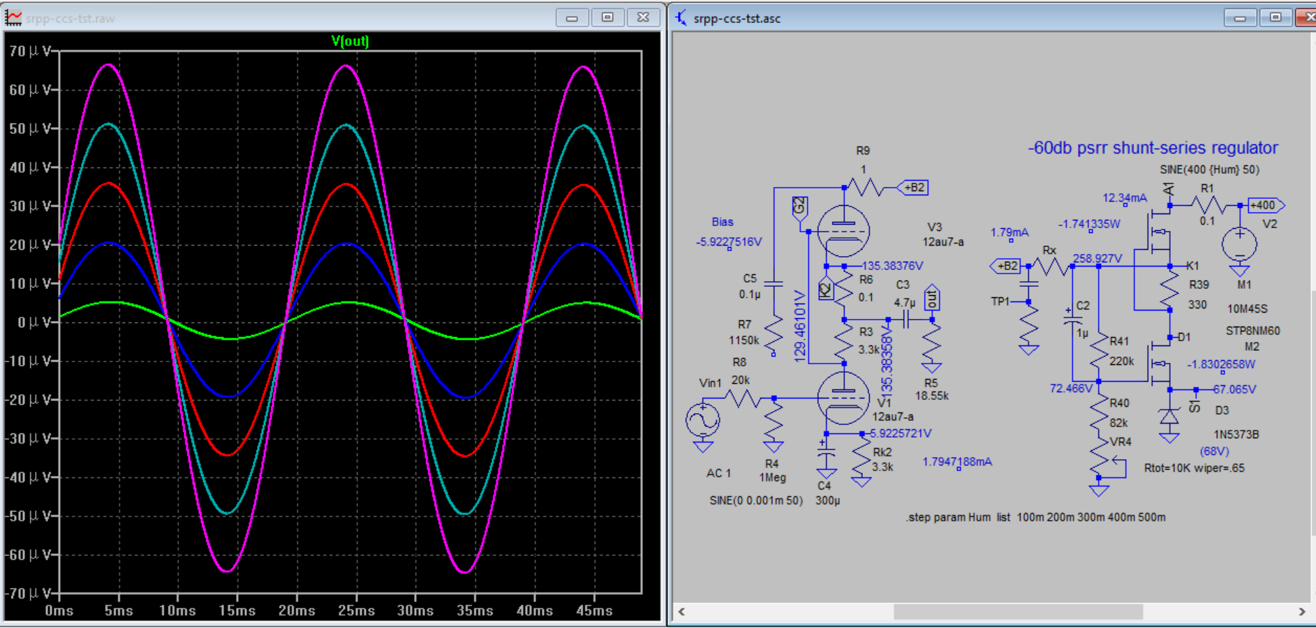

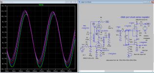

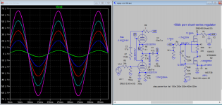

Here are another 2 sims for study purpose only, as the PSU ripple is never sinusoidal in practice, wish I can find one closer to real ripple.

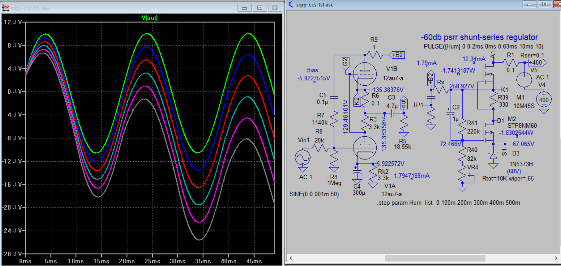

To sim PSRR just add a voltage source in series with the power supply dc voltage. Set it to 1V and do an ac sweep. Make sure you set the normal ac input voltage to zero or just remove it.
As a rule, the PSRR of an SRPP is about equal to the mu of the top tube. I am not sure why people say the the PSRR of an SRPP is bad. Compared to an op amp it is bad but the PSRR of a regular common cathode stage is much worse.
I am not sure why people worry about PSRR in preamps. It is not hard to build an HT supply with ripple below a microvolt.
For an unbypassed, unloaded SRPP (probably how 90% of people build them) PSRR is only about 6dB...

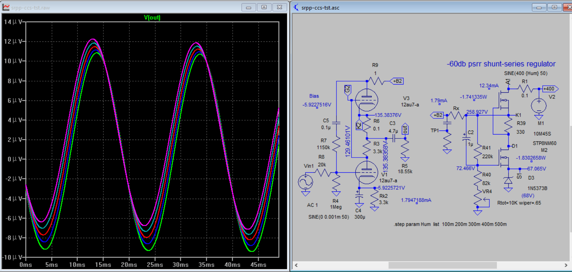

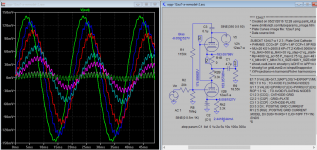

Thank you Ian (ruffrecords). I manage to series a ripple source of 100/120 hz with the DC. Again the results here are for study purposes.

Looks like the consensus is that an optimized un-bypassed SRPP does not do any magical reduction of power supply noise.

Indeed, in Merlin's article
Rk optimum = (2 Rload + Ra) / (μ - 1)
Amazing article BTW, full of equations, I like equations very much.
