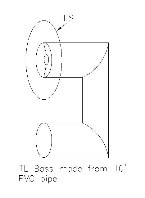

I wish I had taken some pictures...
Me too. I don't think what i'm imagining from your description is quite right. Can you do a sketch?
dave
Here's what it looked like. It was BIG. It used about 10 feet of 10" pipe. I had to create a mitre box to cut the pipe at the right angle to join the pieces together. What a pain THAT was!
The idea behind it was to achieve better integration between the bass and ESL drivers (a "normal" set up is like Mr Stokes- bass on the bottom, ESL on top. At high frequencies, the ESL is extremely directional, so the bass and high freq signals sound like they are coming from two different places (they are), one about 3 feet above the other. This isn't a problem in a large room where you can sit back away from the speakers, but in a smaller room, it can be distracting.
Anyway, the speaker was too big for a small room, and the annular shape of the ESL led to some interesting radiation patterns at high frequencies. Not a total success...
