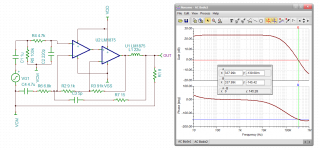

I realize that you're looking for compactness and simplicity, but using Black's feedforward correction really only makes sense (from a complexity/cost perspective) when you have a low-power ultra-linear amplifier actively correcting a high-power less-than-perfect amplifier.
What you have when you gang any of these chip amps together is a "high-power" less-than-perfect amplifier correcting another "high-power" less-than-perfect amplifier. In other words--a different mindset/plan of attack should be considered such as parallel, shoot-through biased chips, or a more conventional op-amp driving the outer loop.
Unless the goal is just to play around with topologies, whether or not they're targeted to some significant positive effect.
