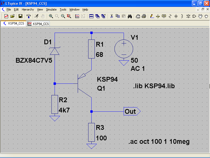

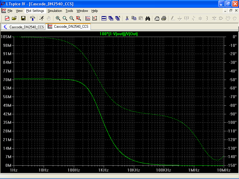

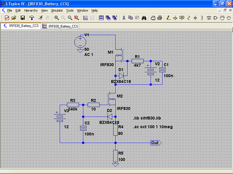

Designing an HV shunt regulator need a good CCS, surprisingly cascode DN2540 do not give very good results, googling I found an excellent reference (as ever)
CCS: not everything that glitters is gold (Part I) | Bartola Valves
Taking Ale's approach, with the same mathematical models I found the same as him (Duh), anyway I took the idea, thanks Ale!
The expression (Also robbed from Ale)
100*(1 - V(Out))/V(Out)
Came from a resistor divider and a little of algebra.
As I need a 100mA CCS, mathematical models from Supertex does not help, so looking for another solution, I found
Voltage source results from [300V (input) - 250V (output)]
I tried other models for the MOSFET and the results worsen a little, but not that much.
If I missed something, I will thank for some critics. 🙂

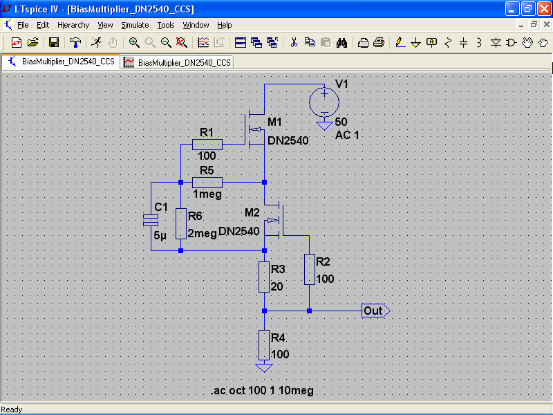

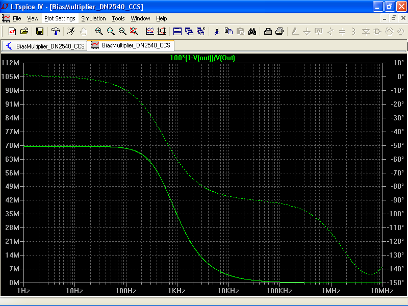

Why not just use Walt Jung's circuit with Bias Multiplier as Ale suggests?
Also.. I wonder if a "gyrator" will give better results?
Hi, thanks for your input.
With Walt Jung's circuit with Bias Multiplier is pretty much the same

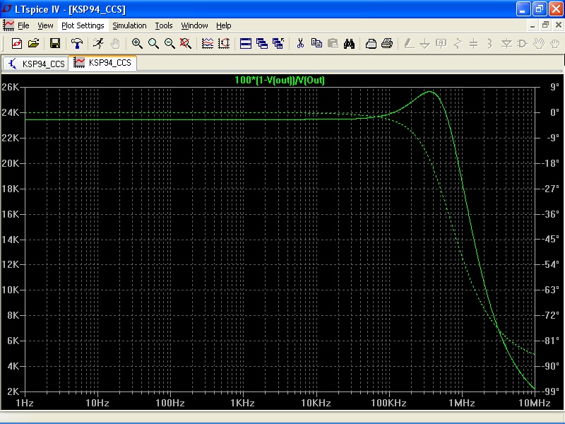

I simulated the gyrator and it did not perform better.
It appears to me that what we are trying to achieve is rejection of signal riding on B+. This will mostly be line frequencyX2 + harmonics from PS.
Harmonics fall off rapidly so they don't need as much attenuation at higher frequency than the fundamental and early harmonics.
How much rejection is "good enough"? 90dB?

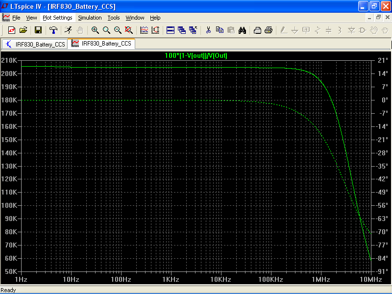

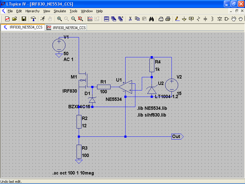

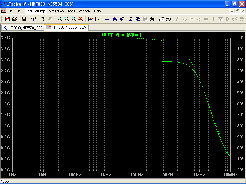

Shunt Regulator
Here is the idea

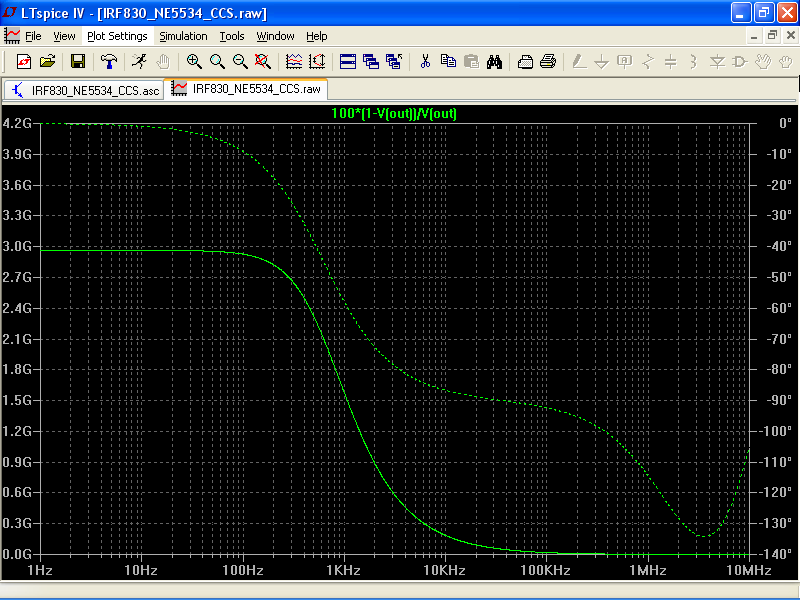

Searching for mathematical model issues, clearly MOSFET models are not very optimistic for this application, Gary Pimm claims 20Gohm at 100Hz with the IRF820
Performance with the IRF830 model is far worse.
So, what makes the OP-Amp controlled CCS behaves so good? 😕
As far as I know the model for NE5534 is quite accurate.
Here is the idea
This is my guess also.
For a shunt regulator intended for a stage with only 6dB PSRR (or less...), the bigger, the better, I would be very happy with more than 100dB.

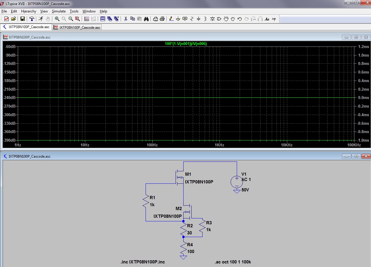

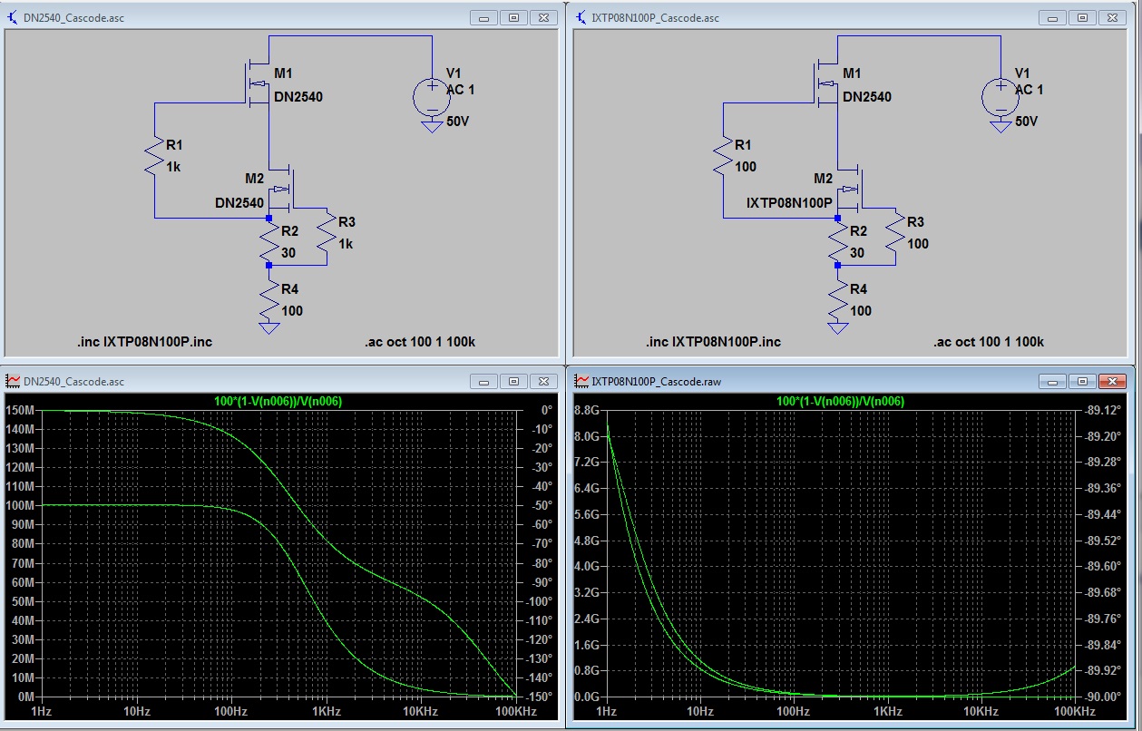

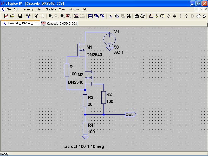

Hi Poplin
I am trying to reproduce this now.. in LTSpice with DN2540 as well as with IXTP08N100P (of which I have a very few).
This might sound a very trivial question, but what plot settings are you using? I Keep getting dB vs. Frequency.. Feeling a bit sheepish right now..
move your mouse over the left scale and right click it. You will have options for Linear, Log, and Decade. Select linear.
Hi Poplin

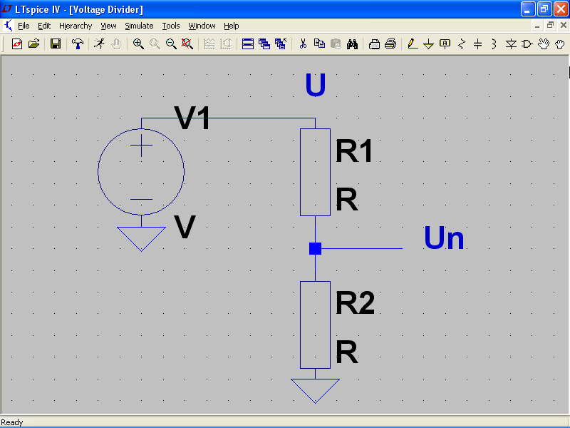

Hi Soulmerchant
I think you plotted
100*(1-V(n001))/V(n006)
Instead of
100*(1-V(n006))/V(n006)
It comes from a voltage divider
From Ohm's law
U = I (R1+R2)
Rearranging
R1 = R2 (1-Un) / Un
With cascode DN2540, your plot gives about -390dB, after right click on the left scale and selecting linear, it gives 0.0mohm.
Yes, I realized all this in the last post... also the linear scale. Anyway look above. kind of sad when you consider the price of those parts, but maybe its an easier solution?

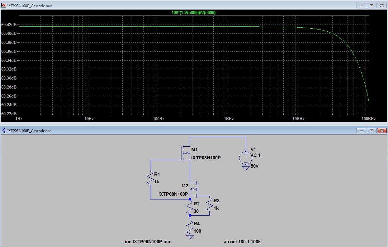

Ok, part of my error was the mistake in my expression. Here is IXTP08N100P cascaded again...
How do you like this plot? Too bad they are so darned expensive....
You think a lot faster than me!
I have problems with Internet today, but this is not an alibi. 😛😀
Yes, I think that DN2540 are better.BTW make right click on the left side of the scale in your plot, and then select linear, results are in Ohms.
ugh.. forget my last post.. I am still tinkering with it to get the load right for the IXTP device. I wanted to just use it as the bottom device, but the results are now not making sense. Maybe I need to re-check my model.

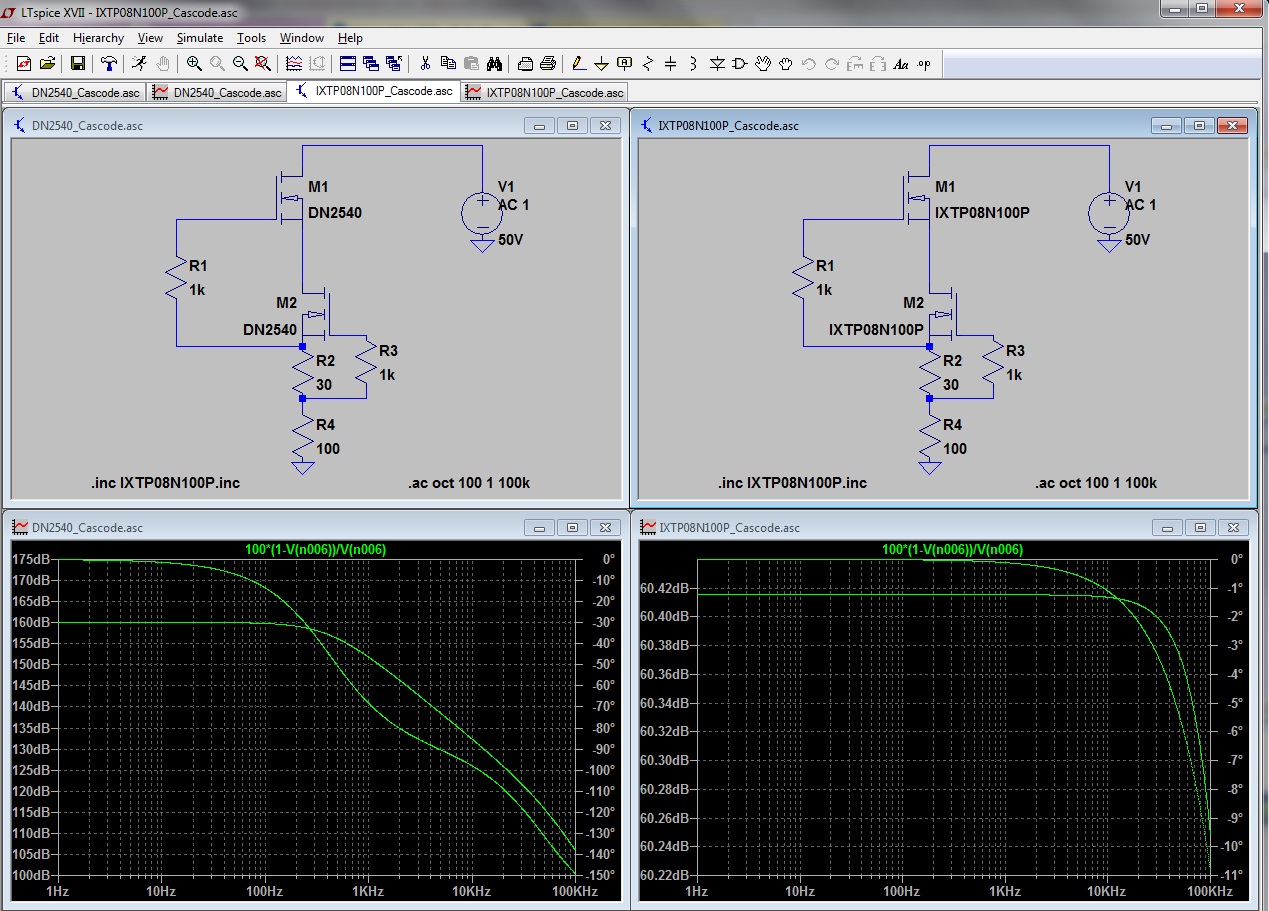

anyway here is what I get.
Yes, clearly DN2540 is a better device, you work at about 38mA, I must reach 100mA, so far the complex version IRF830 OP-AMP controlled is my only chance.
The thing is that I do not know why! 😛😀
Big problem is that I have only and old scope and two multimeters, LTSpice is my silver bullet.
Ok, for fewer than 35mA's the IXTP08N100P device is looking very good though. I see your need is different though.
IXTP01N100D might be very interesting for your application. Just need to get together a spice model for it...
