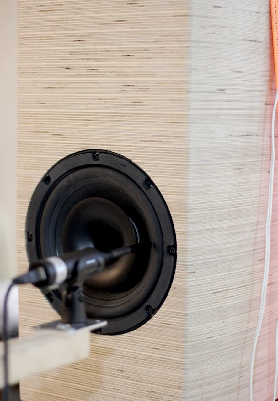

During the years I have built a couple of speakers based on Beyma 8CX300Nd/N and found it a good-sounding driver all in all. Recently, I decided to revise the crossover design for this driver to get the best sound possible. I built a cabinet by laminating BB plywood and took some actual measurement with it and simulated it in Xsim and VituixCAD and both are pretty similar, but I was hoping to get flatter response, that's because I'm writing about it here to hear your opinions if this could be done any better.
The cabinet is a bass reflex with ~30l volume and there is down-firing port underneath.

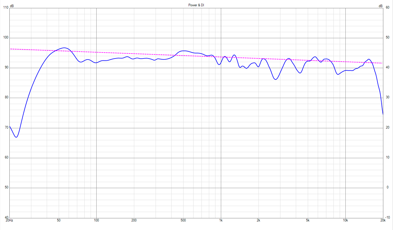

I measured the woofer near-field response and also the far-field and merged them about 250hz. Then I measured port near-field response and compensated it according to its surface area and added it to woofer response. Then simulated the baffle step diffraction loss and imported it as a graph into REW and multiplied it to the overall response of the woofer:
here is the tweeter @1m. I was hoping the tweeter will perform better but...
Here is the simulation in Xsim using the actual FRD and ZMA in the cabinet. First I wanted to use the woofer response after subtracting the baffle step diffraction loss, but then I decided to ignore it by taking the room gain in lower frequencies into consideration:

And here is the VituixCAD simulation:
Actually, I'm happy with the woofer flatness, but the tweeter is so so and doesn't seem it can get any better than this. Any idea to get a better result is much appreciated.

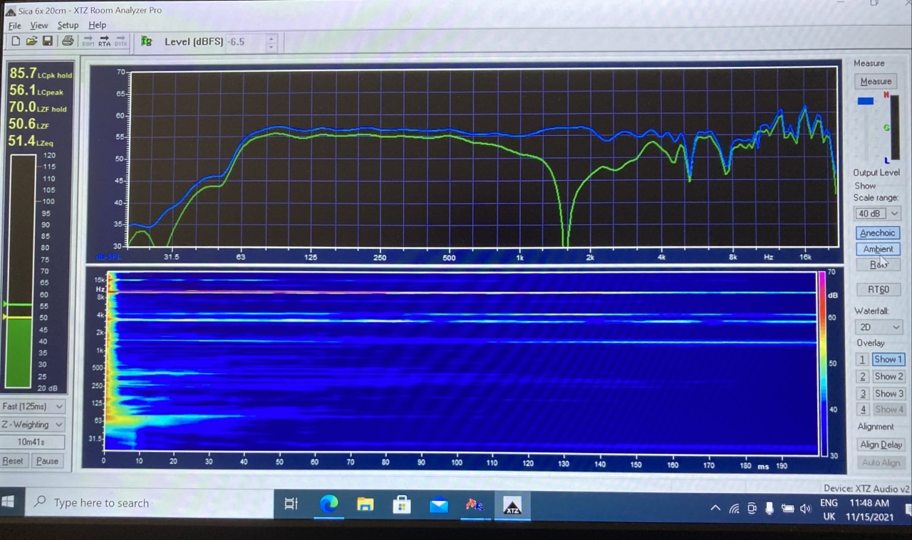

Hi Dave,
I can't help you with passive crossover but here are my thoughts. It seems for me and the work I put down on my coax, that the peaks around 2 and 4,5kHz needs to be adressed. Also the elevation between 500-1000Hertz needs to be flattened. I had roughly the same issues as you, when these peaks were fixed and getting a general down sloping response, all seemed to be heading into a clearer sound. I don't have a recent measure, but attached is after getting peaks down and this shows before fixing the elevation around crossover, all done by DSP. I think this is as good as it gets with a coax, for me it sounds good, despite the unevenness... People seems to "listen" to graph's today;o)

I don't think it can be any better. I think I'm done with this XO:

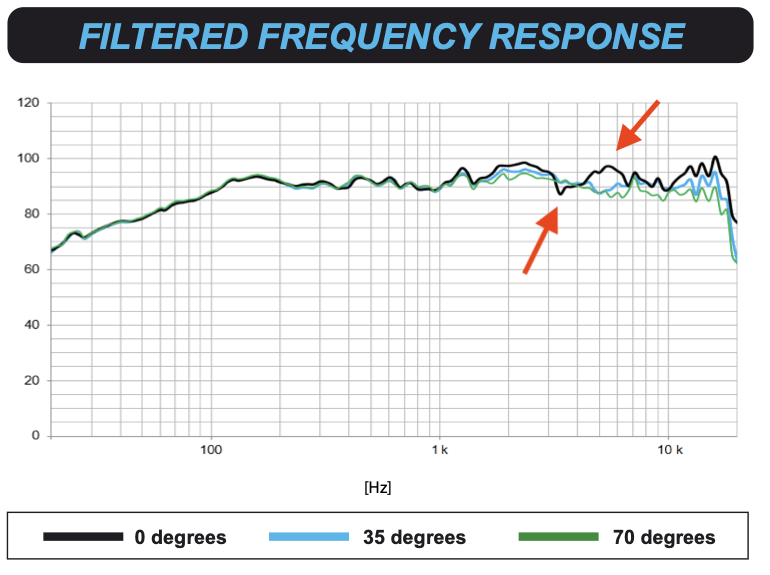

Thanks for the tips. You are right, those dips are really annoying, but there won't be a remedy by going passive.

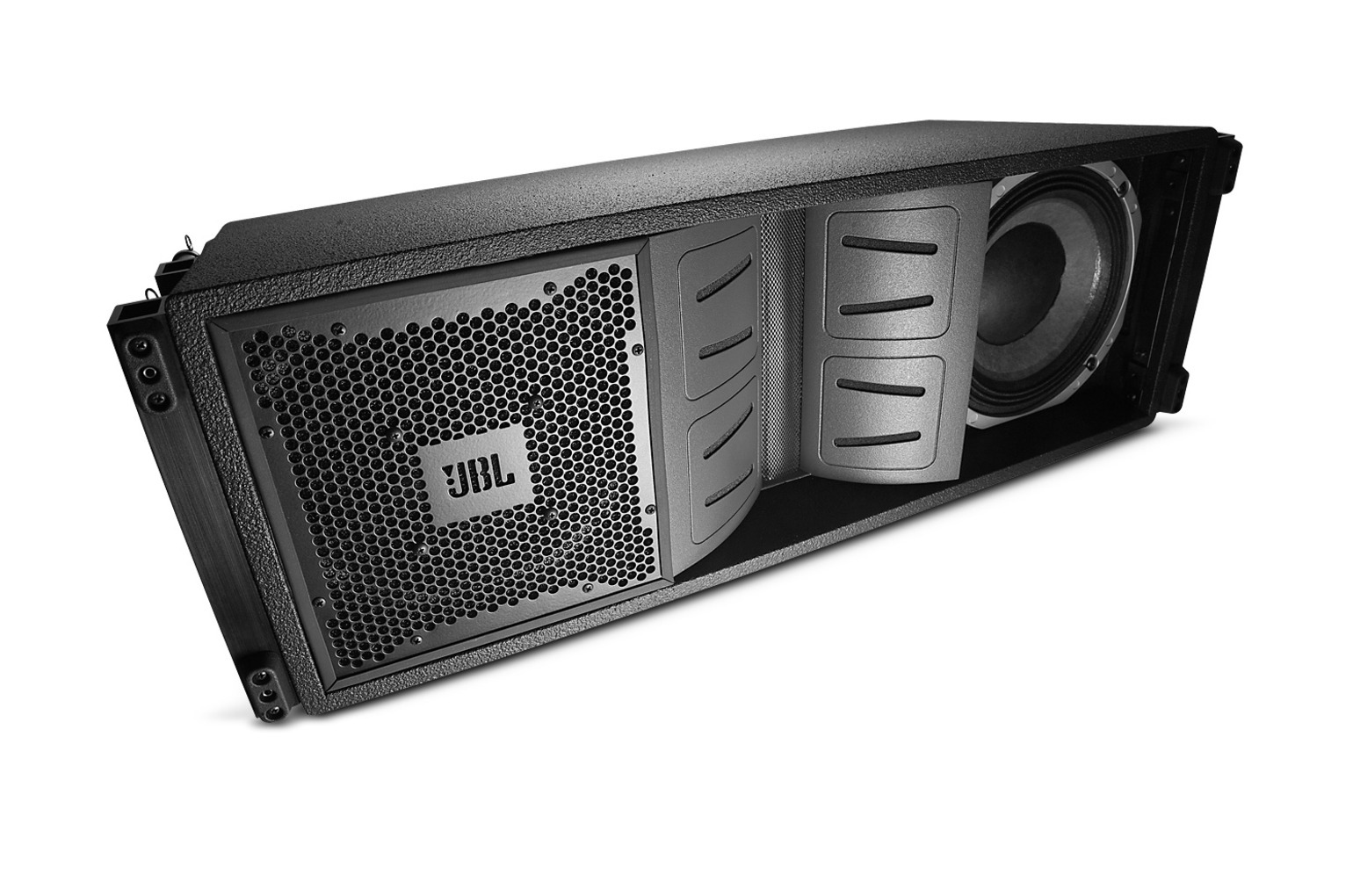

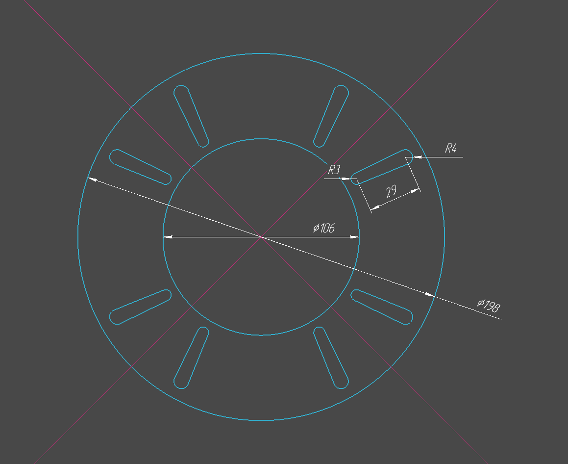

Some peaks and dips are diffraction-related, so your design will sound better than axial measurements imply. However, root problem is spatial and can't be solved in 1D space (crossover and equalisation being the 1D tools).

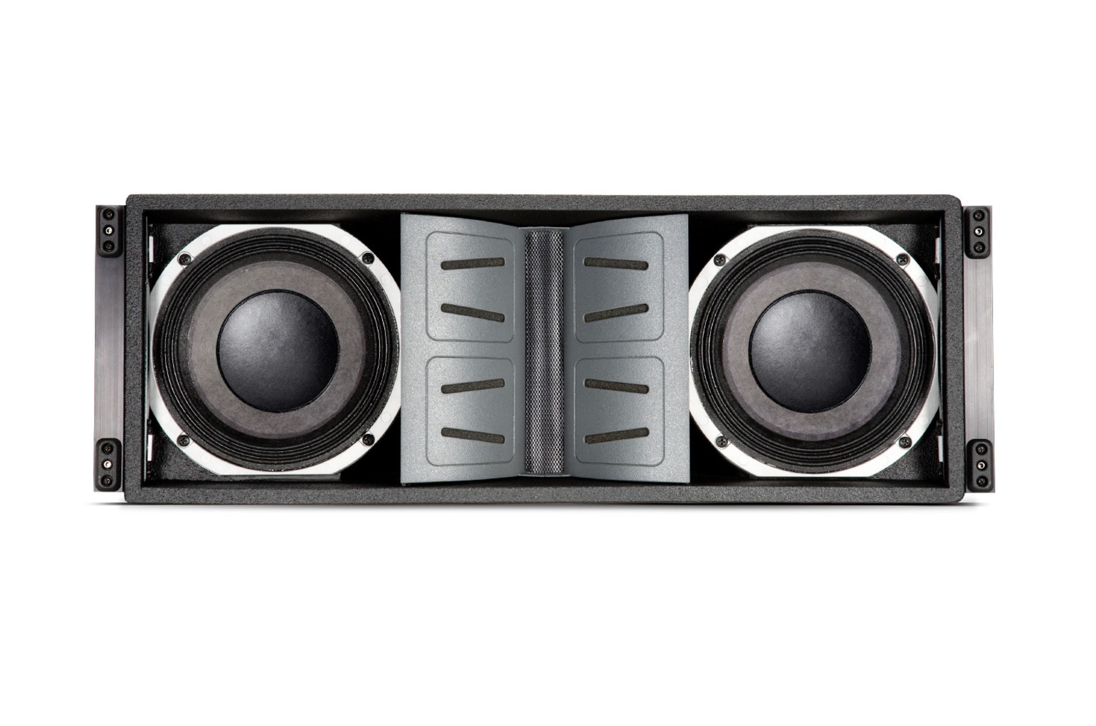

8CX300ND horn is unterminated, so sound waves will reflect off its edges back into the throat, interfering with the initial wavefront. Another part of the wavefront will detach and radiate at the edges, creating secondary sources. The simplest and most effective solution woul be to cover the exposed part of the woofer with a perforated disc, bridging horn surface to baffle and eliminating discontinuity. Angled slots with some melamine damping behind them may be better than simple round perforations, judging by JBL VT line array series.
See last drawing. You can easily prototype it with knife and stiff cardboard. Slot positions and dimensions are eyballed.
