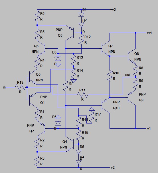

hm, you have hf switching hiss. it is -180db down @10MHz😱
in Kenpeter's proposition there is no HF hiss from >10KHz😀
but anyway I like you project very much🙂
I am pleased that you like it.
Any Way, i would like to see other versions of it and builds. It is not complicated to build also.

Your new design is very clever . . . not very high OLG but very low distortion.
My DC linked fetzilla version has higher OLG in the audio band which I'm enjoying very much just now but this upgraded version of yours is just too tempting to resist. It will be a good nice comparison of the different approaches.
I do enjoy high feedback amps if they're stable enough to also be smooth especially for classical music but I have the feeling your design is going to sound very good.
It may be a while before I will get around to it but I'll report here when I do
cheers
mike

It Will performers equali good with triple ef output but it Will need a Series coli of about 500nH - 1uH.
The idle power consumption is the double (~12Watt at +/- 35Vdc) for the triple EF

You have to draw this output stage. I cannot remember i have seen it.
The reason for the low distortion is the use of a driver stage for the mosfets.
You need to get rid of the gate charge and build it up fast. That requires a lot of current which the VAS stage cannot deliver.
I also discovered that standard current mirrors and folded cascode generates slewing related distortion. They both has to supply the compensation cap. And the output stage or the driver stage. The solution was to ADD current gain to the mirrors.
On the same time we need to raise the linearity of the mirror. That is the reason i have choosen Wilson current mirror.
The next problem was the fact that the current mirror with gain reducere the influence of the compensation cap by the gain factor.. We dont need more bandwitdh, just reducing the slewing distortion. So by applying the compensation cap across the current mirror fixed this problem.
I hope it explains how i Got there.

"laws of semiconductor physics" forever forbid complimentary jFETs.Without increasing costs...
Forget such designs.
Forget complementary Wilson current mirrors. Yo cannot get that working in practice.
Not Q1 throu Q6 sit on a thermally conductive plate held at constant temp. That is n-times better than "thermal compensation". Those who understand semiconductor physics understand immediately why this must be so.
Further Q7 Q10 must be mounted on a heatsink separate from the heatsink Q8 Q9.
I do not fully follow you.
I think i have never spoken about complimentary JFET'S !? You can make a buffer with two N or P channel Jfets that will act like a complementary, but i don't think that this is what you mean.
For the record: Wilson current mirrors does work in practice.
But not complementary Wilson mirrors. of course one could select from a big bunch of devices those which yield a DYNAMICALLY (!!) complemnetry pair of Wilson mirrors but why? It is far more clever to follow a design rule that yields topologies insensitive to
such inevitable differences . Only ring-emitter or multi-emitter BJTs can be made dynamically complements, not simple Epi-planars. its not possible.

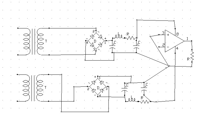

Power supply double star grounding
Hi Hafran,
You have not yet realised the full potential of having two separate secondaries & bridges in your PSU diagram.
Whether you use cheap noisy diodes of nice schhotky ones . . . when those diodes turn off a resonance will be excited in the secondary windings of the transformer - usually in the 1meg hz region.
In your diagram you are injecting that resonance directly into the amps earth - sonic disaster !
You need to either damp that resonance with a snubber cct or filter the earth lines before you make your star earth point - or do both !
Even a foil cap of some 47nF across secondary may be a total cure. BUT - in any case - it is necessary to MEASURE the effect, there is no general rule, as parasitic impedances of the transformer and switching properties of the diodes used count.
