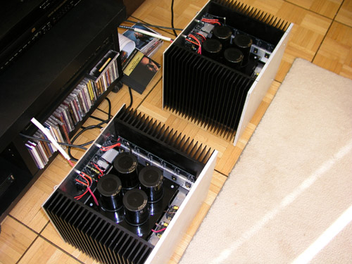

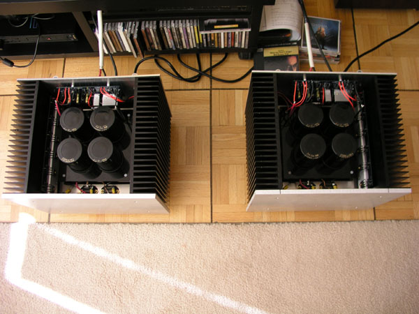

Finally listening to my Aleph 4s (mono-blocks) Here is the pic.
Sound ??? Just marvelous , mission impossible , bass strong and powerful and yet mids and tweeter like a crystals from min to max power. I guess it will take a little time until it shows a full capabilities.

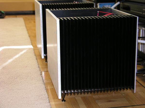

what material is the front plate of your aleph4, it looks so clean.
what size of your heatsink? how much electrical energy does your aleph4 consume? sorry for too much questions.

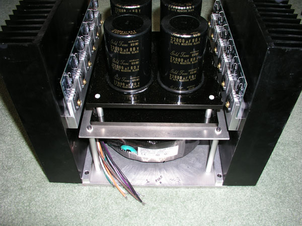

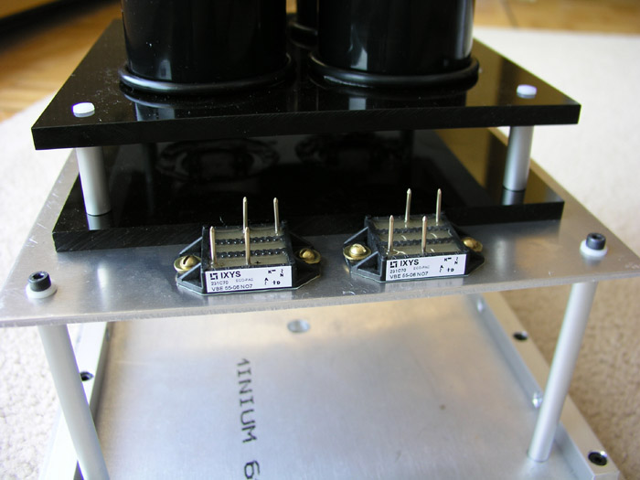

Wow! what truely clean and beautiful innards. I'd like to see more angles of how you've stacked those beautiful black caps over the tranny

Front panels are Aluminum. Heatsinks are R-Theta 11" by 11" Each block runs about 260W idle.
Wow! what truly clean and beautiful innards. I'd like to see more angles of how you've stacked those beautiful black caps over the tranny
Brian
I have used black acrylic which as well serve as dumping bridge since my trannies are each 1.5kW Plitron 2 x 40v with insulated primaries and secondaries and plus with electrostatic grounding.
Take and look at the pic.
Re: Wow!
Thank you Dennis, yes they are R-theta 11" by 11" The amps are running on about 60C degrees

...but aren't monoblock Aleph 4's just Aleph 2's?? 🙂
or are mono 4's actually a little more powerful than 2's?
I see the rail volages are at 48V...
anyways, i love the spikes and the plex... i can see the hours

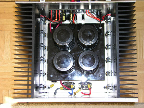

any chance of posting the make and model of them rectifier's ?

This is probably one of the few Alephs with possibly the best parts you can get, I mean silver wire, IXYS bridges, Mills resistors, Nichicon Great Supply caps, 1500 VA Plitron with all possible features and so on. No expense was spared😉 I had a chance to see them yesterday and those are indeed very nicely made amps.

Your pair of amps looks great! How are you going to hold the top panel on? (i didn't notice any way to attach it?)
Also, what are your internal dimensions? 11"x 11"? I have 4 of these heatsinks, and was thinking about doing a similar pair of amplifiers.
