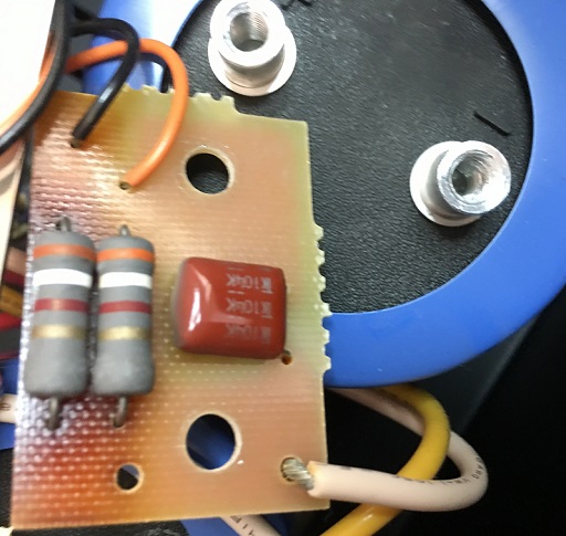

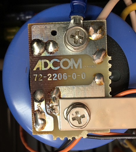

Change the resistors on the brown board to 10k 3watt - only 1 required instead of two. The resistor is just a safety bleeder to remove the charge in the capacitor when you turn the amp off or blow a dc fuse.
That way you won't continue to degrade the board

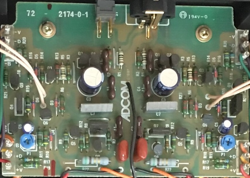

Next data points and a couple questions:
I couldn't get voltage or resistance readings (E-C) on output transistors, so I used a diode tester. All came in between 0.68 and 0.70v, so I presume they are all good. All were showing open when reverse biased, so that's good. I didn't check the one non TO-3 transistors (Q11&12) - what's the chance that it is bad? It's an oversight on my part, I can check over the weekend, if anyone thinks it's useful.
While the diode tester was out, I checked D5 & D6, and they were both just over 0.7v (each one on each side), so that looks good for Q3 bias.
I got a capacitor-meter, and the big one under the burnt board read 14,543uF on a 15,000uF spec, do that's good. Both resistors (3K9) on the burnt board read 3K5, or slightly more than 10% low (not bad for a 5% part), resulting in just under 1.9 watts for a 2w part…
That's as far as I got with everything assembled and power off. I wanted to put R4 in, but can't figure out how to do it, as all the wires were soldered on after it was bolted in place. Is there an official "best practices" for getting the main board out?
I hope (R4 or not) to power it up this weekend and do some quick D.C. offset measurements at the outputs, and then measure the bias voltages per the manual. If all looks well, I might push 50mv in and watch the scope (no load) to see what it looks like. If bias looks bad, adjust bias per the manual and look at a small-signal on each side to see what I have.
Any comments on what I have done or plan to do?

Sorry the other resistor for the long-tailed pair, under Q2, in the same place R3 is to Q1. There is a provision for it on the circuit board, but a wire jumper is in its place.
leave it as is
you're allowed to mess there only if you know what you're doing
in worst case you can worsen amp stability margin
I'm kind of confused. The resistor in question is in the design (but omitted in the build) and a normal part of a long-tailed pair. How does putting something back in which was omitted going to cause problems with the stability margin? This amp's schematic was the first time I saw such a design (but I'm not an expert) omitting one of the resistors.

well , having just one of these in LTP easily can be designer's choice
I can't see it in schematic , so who cares why it can be on pcb ......... and it really isn't
regarding pre-tests , I think it's time to flip that power switch
use bulb tester , just in case

Update - small signal test worked well and so the setting of the bias was run, and all looked well. Minor adjustments to get 50mV on loss of signal, will have to check what the shorted inputs look like coming up from cold (to see if it's still in the 16mV range).
