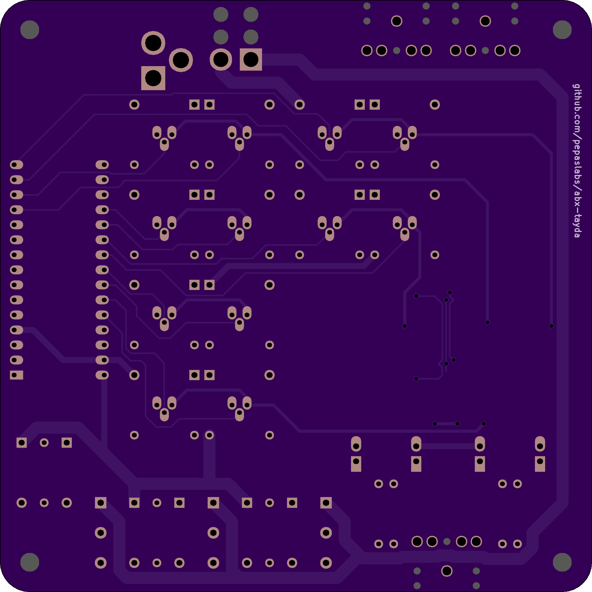

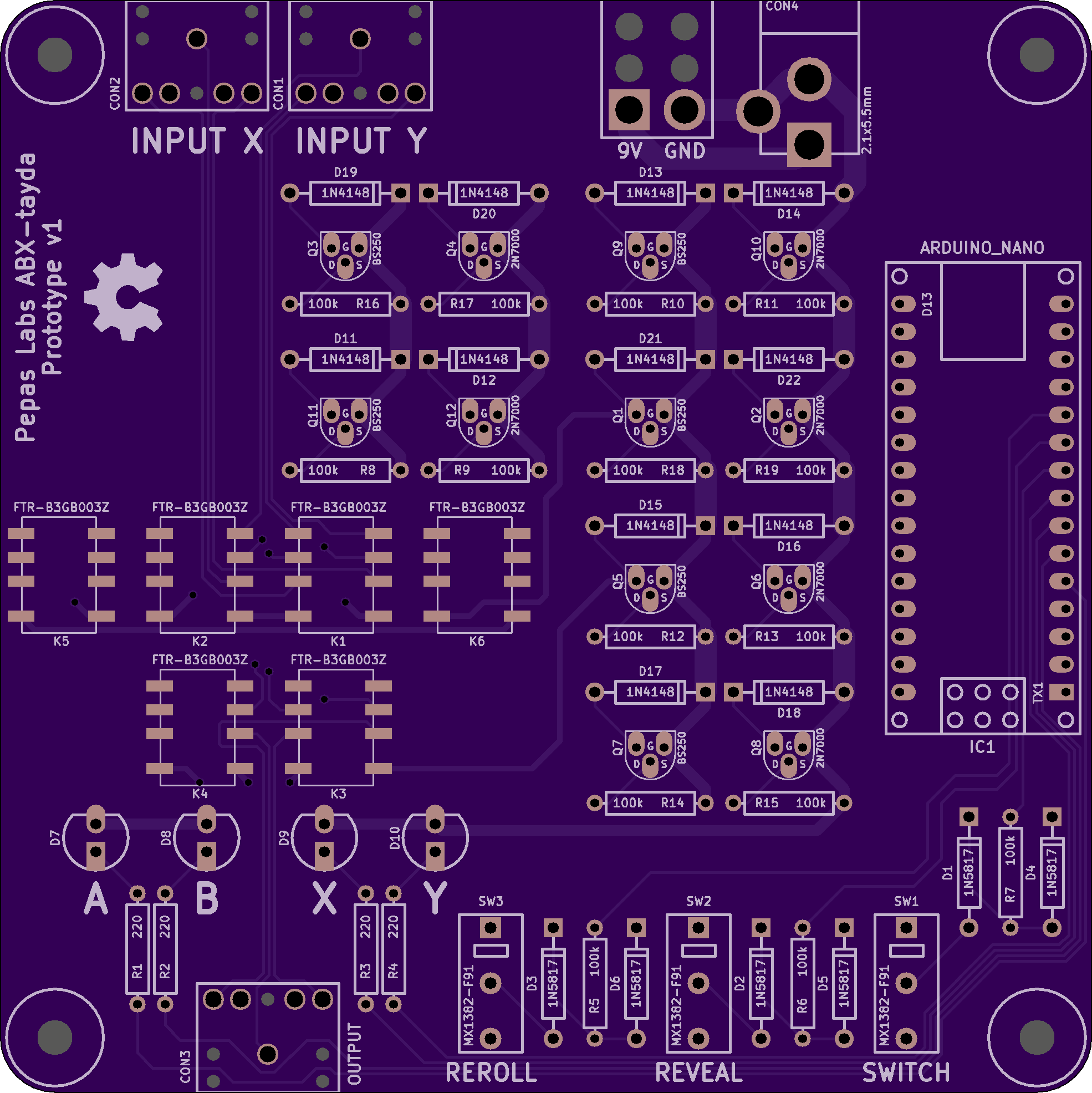

Here is v4:
GitHub - pepaslabs/abx-tayda: A relay board for performing blind A/B testing of two audio sources.
- Use 2N3906 PNP transistors rather than BS250 P-channel MOSFETs
- Use wider traces for the signal path
Thank you for all the updates 😀. I've had a look at the latest schematic - I see the P-channel Arduino pins each have a 100k resistor in series except PCH4 on D01 / TX1, which connects directly to the base of Q7. Is this correct?
Whoa good catch! Each PNP should have a 10k base resistor, but one of them is missing! I suppose it is lucky that I haven’t ordered updated boards yet 🙂
Thanks!
Thanks!
Glad to help!

Another thought - have you considered a driver chip such as the ULN2803 or DRV777 to control the relays? Obviates the need for transistors and diodes. It won't look as cool though.
edit: I forgot your need for Tayda as a source - the ULN2803 is available from there for $0.48
edit edit: hmm a driver IC doesn't solve the relay coil voltage problem

Oh that's an interesting approach! It would conserve some board space, and if you were using oshpark that would definitely save some money.
However, I have really loved learning from simple DIY circuits, especially those which leverage "jellybean" and discrete parts. Plus, the DIY'er gets to stock up on these "jellybean" parts which they can use in other circuits.
That said, I could certainly see making a variant of this board, which used parts from digikey, and didn't shy away from integrated solutions 🙂 Or maybe even 😱 an SMD version
I totally get ya - there is a satisfaction one gets when doing something from first principles 😀
SMD though... heresy!
Here's v4.1, with the missing PNP base resistor. 🙂
This update was a bit delayed as I was working on another board to bundle into a JLC PCB order.
