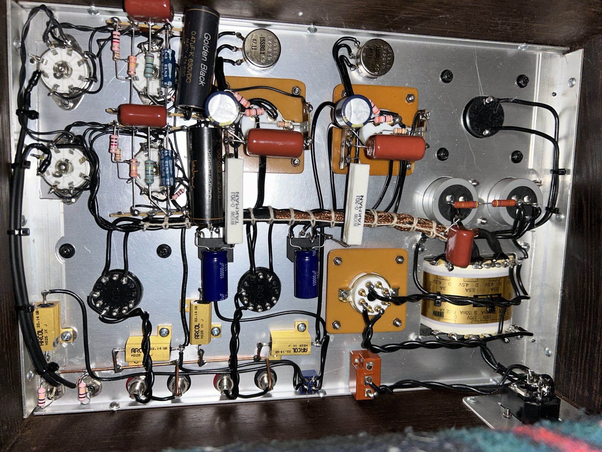

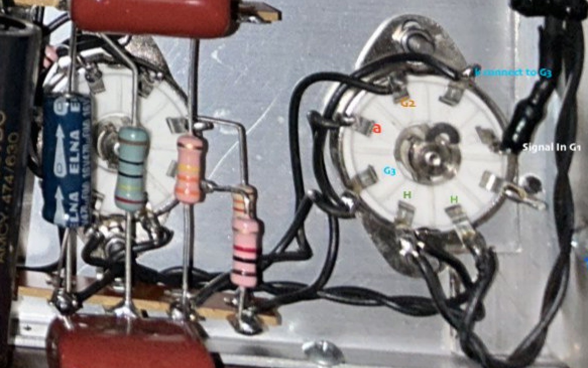

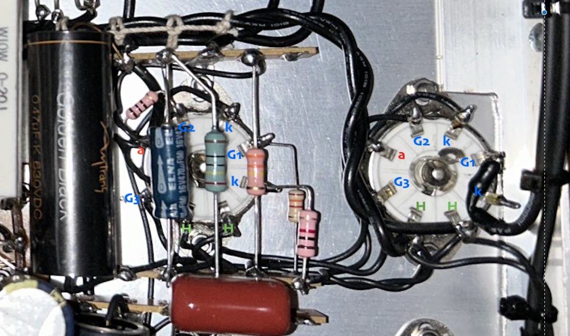

If you've heard what you like I think it's wise to start there - If you can get details from your friend's amp about the driver (C3g) connections and the voltages/currents everything is running at you should be able to get very close to what that circuit is (or even better) without having to spend the money on C3g's . There are plenty of other suitable tubes without the high price.
The only thing I'd recommend from the outset is to plan on building the circuit in a way that allows for experimentation.
If you're interested in reading and it turns out to be what your friend's amp is using, I'd also suggest searches on SRPP vs Mu Follower.

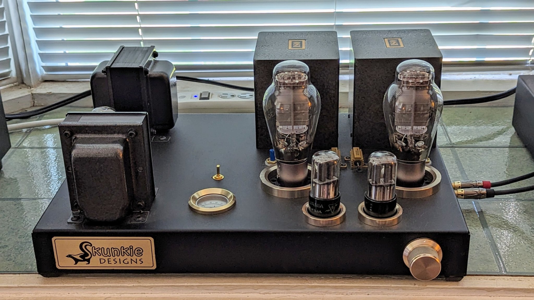

I will note that I'm not super well-versed in what different SET circuits sound like, as I haven't heard many. I'm not convinced that this is the best 300B amp out there, but it's one that's local to me and that I enjoyed listening to, so it seemed like a decent idea for a build. The more I study the photo, the more it looks very similar to the Sun Audio circuit, at least in the 300B stage. It also seems like corners were cut as the amp is advertised as being able to run a 300B or a PX25 with a toggle switch. If the transformer is indeed the FC-20s (which it appears to be based on the pinout), ISO doesn't even list the FC-20s as being able to run the PX25 (they list the larger, more expensive FC-30 and FC-40 as being able to). Maybe these things indicate a sloppy design? I'm not experienced enough to make that call.
Edit: also just identified the power transformer as the ISO MS-3716 (ISO lists the application as the 2a3 and the 45)
