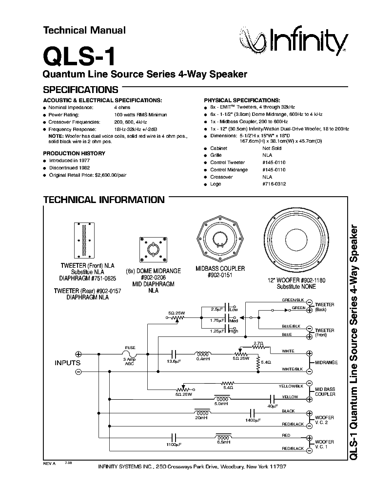

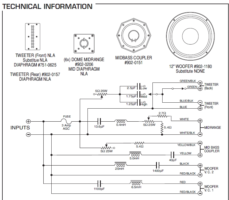

thanks again and yes For instance in the dq10 is cut at 400Hz I saw a FR and if i remember well it is flat up to at least 3kHz
For this reason if i only could understand the dq10 xover i would try a redux version giving more range to the Philips where it could shine more
The bass is not its strong point In the Infinity i would have used another midwoofer It can be done
