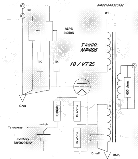

"Sound Practices issue #16 "
Ummm, that won't work. The 10 mF cap is shorting out the audio in the transformer.

Ummm, that won't work. The 10 mF cap is shorting out the audio in the transformer. .......
Smoking amp is quite right about that, in order for this to work and not short the ac signal out entirely there would have to be a huge amount of leakage inductance between that winding and the others.
When you wind two windings on a common core you have mutual inductance between the two, and what you do to one is reflected to the other by the degree to which they are coupled.
So shorting one winding effectively at least partially shorts all of the other windings on the common core depending on the degree to which they are coupled. A 10uF capacitor across a fairly high Z primary winding should constitute a pretty good short over most of the audio bandwidth.
