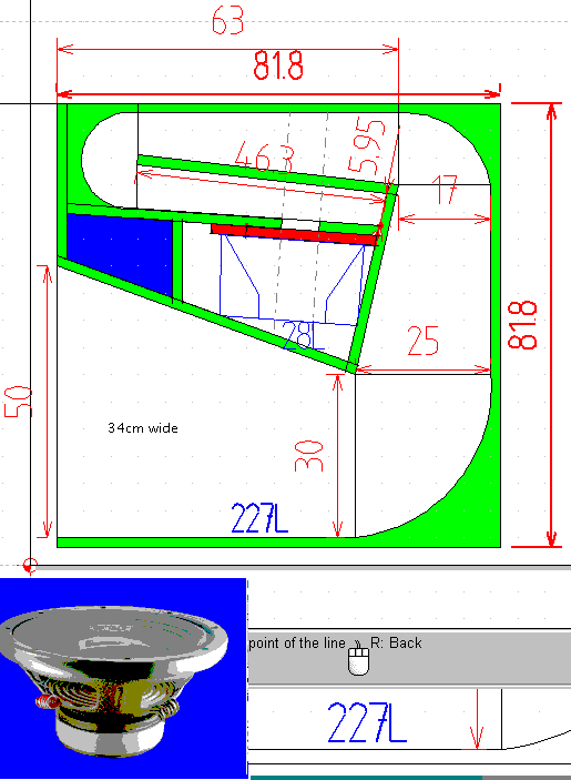

Yes im crazy.*horns involved*
Doing these types of designs in the mid to late 80's was interesting
because then, we didn't have monster woofers and high powered
amplifiers were expensive :smash:
But you have to be careful as horn critics will say that
it aint a horn at low frequencies because they is no
acoustical gain - a qualifier for being called a horn. It looks
more like a midbass 'horn' but not LF 'horn' even though
you do have LF response.
Anyways, these types of projects are fun 😎 😎 😎

in HORNRESP after inputting parameters use the HYPEX TOOL!
chose BW,and away you go! chop that horn! reduce that mouth! work it work it! watch that response go wobbly and that excess volume drip off before your very eyes!
🙄 🙄 :dead: :devilr:
