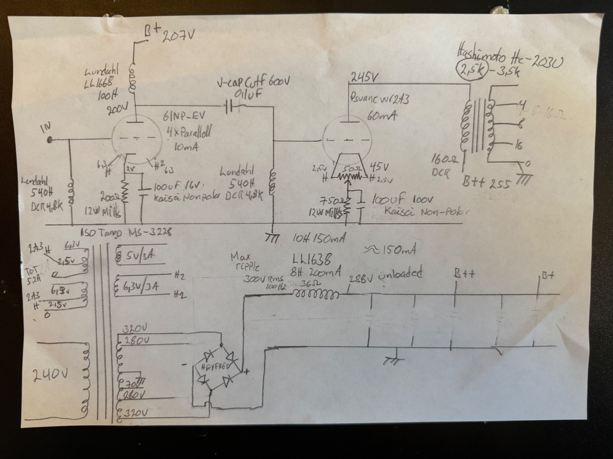

Yes another 2A3 design I am ready to be judged
D3a datasheet:
Limiting values Va max 220V.
Your traced -3V curve shows about 7mA at 220V, datasheet about 2-3mA, Triode Loadline about 2.6mA.
Is this the best operating point for this tube?
I'll stick to the 1-2V range.
