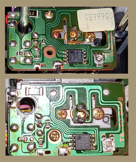

Received the SF-90 laser which looks identical to my current SF-P1 laser. Upon further reading I did find that indeed they are interchangeable. We'll see.
However, before I swap them out, for the life of me I cannot find the protective anti-static solder blob that is supposed to be removed once the laser has been replaced.
If there was a blob on the replacement part, then it has already been removed.
BUT I am suspicious of what could possibly be a shorting screw seen going through the PCB copper trace circle in the SF-90 (bottom picture). The top picture (my current SF-P1), the screw has been moved up to a secondary location, with no copper trace.
Could this be what is being used instead of the solder blob?
Thanks in advance.
P.S. I did get my tray motor working, so almost there...

I can't see any shorting link on those pickups.
As the laser diode is driven directly from on board circuitry it is possible that it is deemed not necessary as the drive chip will provide a low impedance across the diode and protect it.
The screw seems to be located on the 'ground' trace of the circuitry and I expect it simply connects the PCB to the pickup body. Definitely nothing to do with diode protection.
Ah. That makes sense. The pick-up body is all metal on the SF-90, whereas on the SF-P1 it is not. So the screws in different positions likely relate to that. Any pics of either I see on the net show the screws as aforementioned.

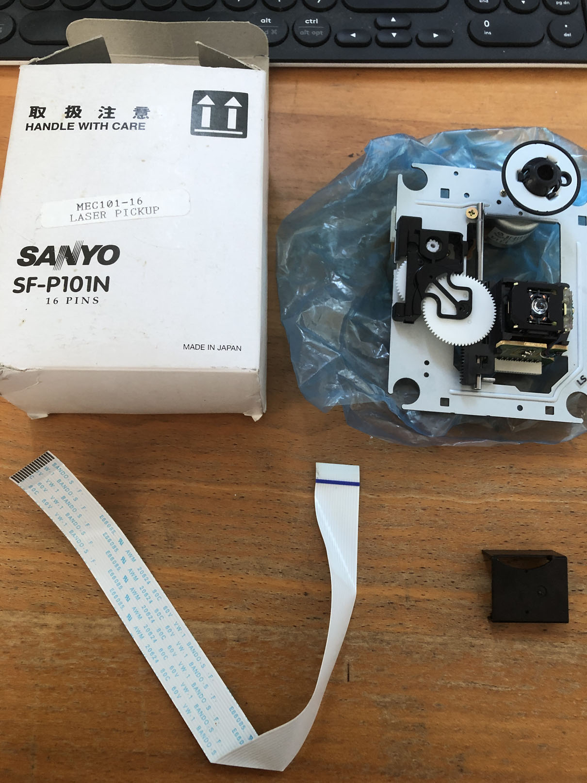

Guys, I'm here from russian speaking audiophile community - to check your opinion: is it possible to buy genuine SANYO SF-P90/P91/P1 now days or everything, what's currently listed on ebay or few other stores are fake? I'm asking, cause in our community appears to be a strong stereotype, that there is no genuine P90 laser head on market now and it's literally no possible to find one elsewhere. I'm not quite sure about it, so decide to double check with you here)
Will be highly appreciated for any helpful information.
Thanks a lot for you response and great proposition! Unfortunately I can't use this laser head, as I'm looking P90/P1 for my C.E.C. CD transport.
But I'm also curious about overall opinion of the diy comunity of this source, regarding the statement that all of the P90 laser heads, currently present on market - are 100% fake.
Also that would be extremely helpful, if someone can share an information about the visual difference between genuine P90/P1 head and its fake copy.
