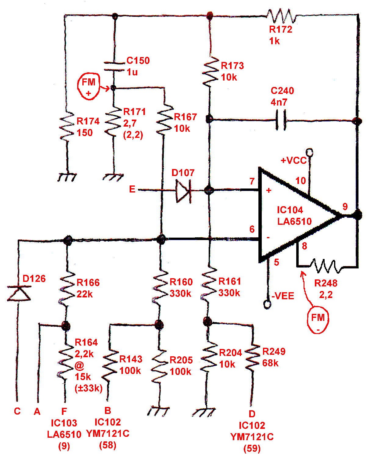

Hello all,
The absolute first thing you have to do when you have reading problems with an Alpha or Delta series YBA CD player is clean the laser. When I say clean I mean using a Q-Tip soaked with glass cleaner. You would not believe how many times a dirty laser lens is what is the cause of the problem. I sometimes get an RF signal that is up to half a Volt higher after cleaning!!
As Mooly pointed out, there is no way to do a proper adjustment without an oscilloscope. You should have between 1.5V to 2V RF at TP16. Sometimes I have to crank that close to 2.5V as many customers want to read CD-R and CD-RW discs and the original setting was a little too low for that. I rarely have to replace laser pick-ups as they are extremely reliable.
As for real defects, the first thing to go bad on the Delta series of YBA CD players is the spindle motor. The second one is the YM7121B or C as the players are extremely sensitive to electrostatic discharges. The third one is the zener diode, D116, regulating the display "high voltage". The fourth one is the tray motor. I am beginning to see tray belts going loose since about a year now.
The easiest way to test the spindle motor is to connect an analog multimeter on the x1 Ohm scale to DM+ and DM- of CN102 and turn the platter very slowly to see if there are shorted spots. The needle should be steady around 15 Ohms.
The same goes for the tray motor on SM+ and SM- of CN102. A good indication that this motor is defective, IC104 gets burning hot.
Another problem I see from time to time is a jerking tray motor while reading the CD. It is more pronounced when using a CD that is not perfectly centered. When I first began to see this problem I thought it was because of off centered disc platters but after awhile I had to dismiss that conclusion as I saw more and more older players having this problem. Since I was not supplied with a schematic by YBA I had to "develop" a fix for that behavior problem. After a lot of experimentation I found that increasing the value of R164 from 2.2k to 15k I was able to eliminate the jerking. This can be done without removing the PCB by soldering the new resistor to the left side of R164 and right side of R166 and not forgetting to cut the right side of R164 AFTER the soldering is done. This new resistor value is not absolute and may differ from one machine to another. The best way is to install a resistor with full length leads in case you need to change that value.
Getting back to D116. The original value of R170 that is in series with D116 was 470 Ohms on the first PCBs I saw and became 2k2 on later PCBs. They used the same circuit on the Alpha series of YBA CD players and the same diode burning problem happened then..., after they replaced the transformer originally coming with the PCB by a "better one". The voltage output of the new transformer was higher so D116 had to dissipate more than it originally did. Stupidity being what it is, it looks like almost everybody using that PCB made the same mistake. Go figure... The really bad thing is that I can not find replacement displays anymore and this is that part that suffers/dies when D116 looses contact from the PCB traces as full voltage is applied to the display.
I am at your disposal if you need more information or even parts if you can not find them and would be extremely grateful if someone had the schematic and could send me a copy.
Best regards,
Michel

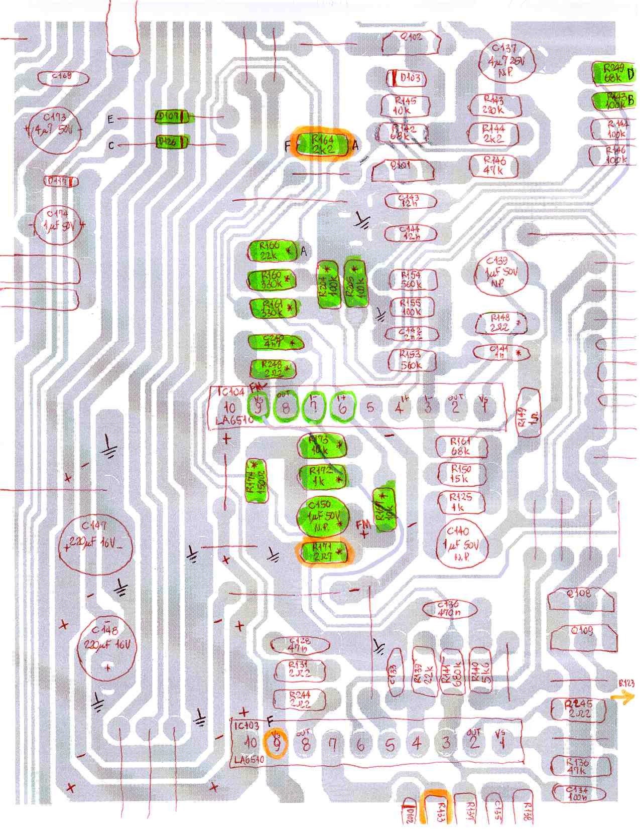

Hi Michel
do you have any experience with this Sanyo PCB?
I wanted to try your R164 resistor mod, but I am not sure which one on mine PCB [CEC TL2] refers to it.
Hello prinzinio,
Sorry but I'm not familiar with this board but, it has lots of similarities with the YBA Delta board. Shown is a partial schematic of what I did to address the shaking problem. You can see where resistor R164 is connected in relation to IC104. If your circuit uses the same configuration, you should be able to put your finger on the resistor that does the same work.
Good luck!
Michel
