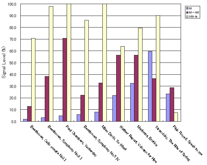

It depends on mainly two factors;
1. Sound volume
If you are listening music with small sound volume then you will have a plenty of margin against Xmax. I�fm listening at approx. 80cm distance from the speakers ( maybe 2 W amp. power should be enough, even though my wife sometimes complains). This extreme boosting is possible because of near-field listening style. If you approach to the speaker, then you can get the same sound pressure level at your ears with less sound volume from the speakers. If you are listening in a big room with nearly full volume then the boost possibility must be quite limited.
2. Original signal level at the boosting frequency
In most of music sources, original signal levels below 50Hz are not so strong even in classical symphonies (I tried Beethoven No.1 ... No.9). Therefore +30dB at 25Hz is generally not so critical.
However, as I mentioned in my Blog, some special music like as modern orchestra with extraordinary strong bass drums bring the drivers to Xmax because of strong signal level. In such case the boost factor must be reduced.

However, at this moment I can only say, boosted Alpair5 sounds better (faster or tighter or clearer) than my own cheap powered subwoofer(13cm 30W). The software also compensate phase delay that increases in lower frequency range (this is inevitable in any laud speakers). It might be working some how? but I�fm not sure.
+30dB looks quite shocking, however signal level below 50Hz is quite low in most of music sources especially non-electrical tunes. (see attached picture) Furthermore +30dB is just a peak value at 25Hz. Therefore actual effect is not so big in many cases except for some extraordinary tunes like as Rit of Spring / Stravinsky. Usually I boost down to approx. 40 Hz flat and limit the max. factor (approx. +18dB) down to 25Hz, then sharply cut-off (See figure in my Blog, "reduced boosting cactor"). It�fs enough and safer.

In other words, �gmaximum low boosting�h means �greduction of mid-high range from the maximum powered condition of the driver". Therefore basically I would recommend to use Alpair6 or CHR-70 for this kind of extreme boosting applications, with which you could have much more boosting potential (see below table).
driver / X-max(1way) / max. Power
Alpair5 / 2.5mm / 12W
Aplair6 / 5.0mm / 30W
CHR-70 / 4.5mm / 40W
(data from Mark Audio home page)
