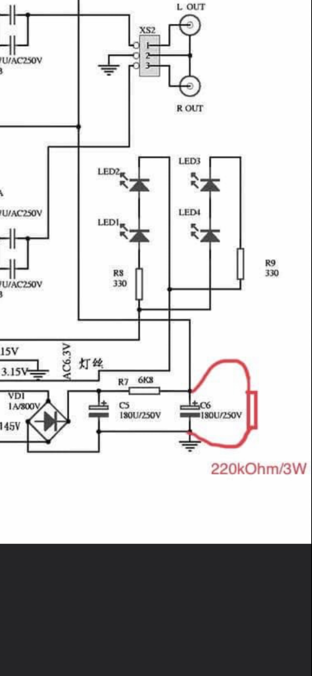

Hi all, a new member here. The info from this thread has been of great value. I need some help regarding what value resistors are required for bleed resistors on the power caps (already sorted for the input & output bleed resistors). Any info would help. I'm also a bit confused as to how it is implemented. Some photos show the implementation of two resistors across the first cap whereas some show it as one per cap (bridged). Not having a great deal of experience with this, your help would be of great value.

#1) the bleeder resistors for input & output (480KOhm & 120 KOhm) that I can get come in values of half watt or 1 watt - will it make a difference which I use?
#2) what value resistors did you use as bleeders/ bridge/bypass on the 2 x power caps?

2) I used a single 220K/2W resistor across C5 only. C6 has a series 6.8K between the plus posts of the two caps so it will drain thru the 6.8K and then the 220K. No need for a 2nd resistor across C6. I used 1M across the inputs and 100K across the outputs.

I have read that 2 x 1uf Caps instead of 4x0.47uf caps is a better option due to costs and time invested. I also understand that they are in parallel. So with that in mind, do I simply solder in the new 1uf caps in ‘c2’ and ‘c4’ and leave it at that, or must I bridge the “gaps” left my the missing 2 0.47 caps with a wire (on the correct side of the terminals to each other) and same for the other side?

Replace C2a and C4a with 1.0uf caps. Leave C2b and C4b empty. Do NOT replace them with a jumper. Doing so will short caps C2a and C4a out of the circuit.

One more bit of info regarding the SD-CD3's schematic. All the schematics I've seen show the left side of C2a&b and C4a&b connected to the junction between resistors R2&R3 (left channel) and R5&R6 (right channel). The left side of caps C2&4 should be shown connected to the junction between pins 3&6 of each tube and the top of resistors R2 (left) and R5 (right).
Along with that I would recommend the following...
* Add a 1M resistor across each input jack.
* Add a 100K resistor across each output jack.
* Add a 220K/2W power resistor across the leads of filter cap C5. This will provide a discharge path to ground for both filter caps.

Regards the 220k/2W across the ‘leads of filter cap c5’. What do you mean ‘accords the leads’?
