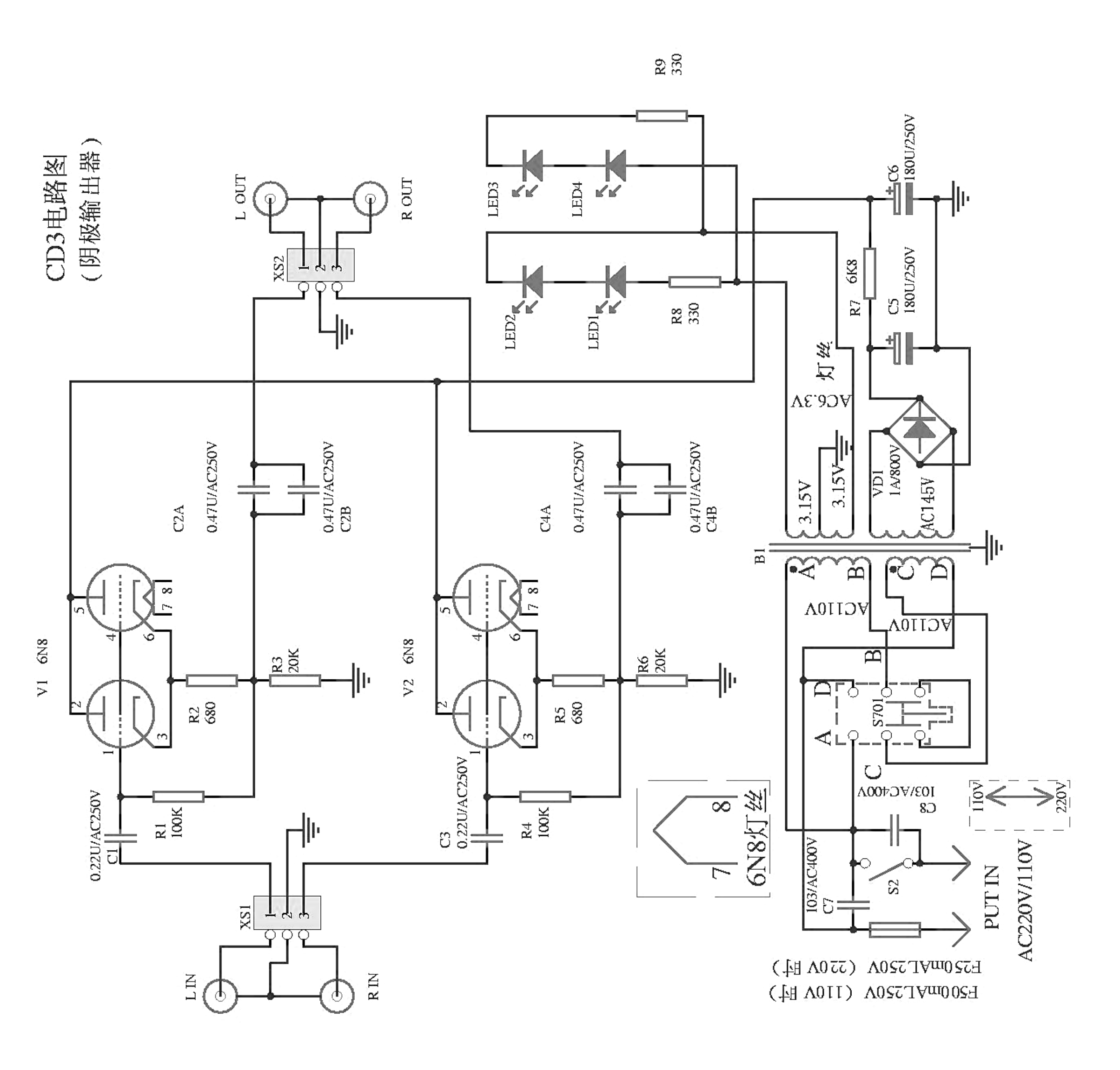

Yaquin CD3 schematic

Just bought the CD3 buffer and have access to the schematic, which I thought you boys would like. But I have a vexing issue and some observations to follow in my next message.

Hello again. Hope you like the schematic.
I'm not a tech, though I've built some kits in my time. I'd appreciate some observations and corrections from the techs in residence.
First, judging from the schematic I've submitted, I'd say that all the capacitors and the 680 & 100K resistors are in the signal path. I concluded that the 20K resistor is not. I'd appreciate any corrections.
Second, in the interest of properly orienting any capacitor upgrades, could someone point out the source and destination or ground sides of the capacitor positions judging from the supplied schematic?

Is the Yaquin AC or DC coupled? If I am not jumping to conclusions, judging by your comments and this quotation from the article you referred me to, the tube buffer stage is solely and only for impedance matching and will not impart the same qualities to the signal as a tube circuit with gain: “The cathode follower is an excellent buffer stage for driving a tone stack or effects loop, or any circuit which would otherwise present a heavy load to a "normal" stage. In addition, the DC-Coupled cathode follower can also be used to produce a unique compressive quality, and is to be found in most of the classic amp designs. The AC-coupled version is not so useful for this, since the input-coupling cap prevents the flow of quiescent grid current. The AC-coupled version is therefore used as a tonally transparent stage, usually.”
It would therefore be essentially useless to engage in tube rolling with expensive classic tubes, or to upgrade caps and resistors.[/U] I don’t mind being told I’m barking up the wrong tree. I’ve wasted more money on bad CDs and records. But have I reached the right conclusions? As I’ve stated in my previous post, I hear no difference with the buffer on or off, so why not eliminate the added circuitry? There are no impedance matching problems with my system in a simple ‘passive preamp’ mode.
A well-designed circuit is not meant to impart any qualities, just pass on the signal with as little damage as possible. This is a simple cathode follower, dressed up to look important (and expensive, I bet). There is nothing particularly wrong with the circuit, apart from missing ground leak resistors at the outputs. As you have found, it still passes some signal even when switched off! In most setups, it should have almost no effect on the signal apart from adding a tiny bit of noise and distortion, probably too little to notice. In most setups it is unnecessary, as there is no impedance problem to solve so it can only be used for cosmetic reasons.
Given the relatively high input impedance (the 100K resistors are bootstrapped, so look much higher in value), changing the input caps will not affect the sound unless you go to much lower values. The output caps need to be big enough to cope with whatever follows. 1uF with a 20K input impedance next will give 8Hz rolloff.
This circuit is AC coupled at both input and output.
