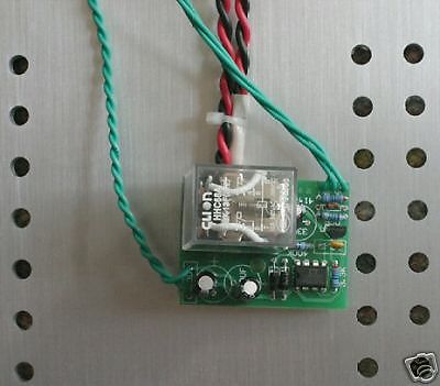

Hi, This is my first post here. I own a MC-13S and I was thinking to install a Power supply delay board which I found on ebay.
Power Supply Delay Board Dynaco ST70 EL34 6550 KT88 6L6 6V6 EL84 Tube Amplifier | eBay
Can anybody tell me how?

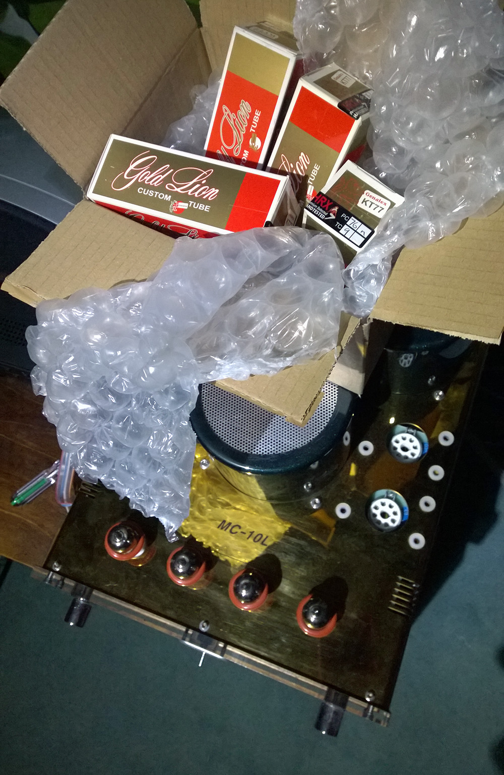

Valve shoot out
Hi I have a failing EL34, so time to replace the set. Has anyone compared them to KT77s or 6CA7s ?

Lessee - I've run TungSol EL34s, JJ KT77s, Mesa EL34 (rebranded someone-I just don't know who) and Valve Arts 350Bs. Any impression of any of the above is a little jumbled in my mind's ear right now as I've been down for 3 months doing a complete front-end rebuild. Tube Depot and some others might have some impressions of each tube's character for you though.
I should also note I'd been running 6922/6DJ8s almost from the start - which I like quote a bit better than the 6N1. More rolling possibilities.

1) Lack of bass was cured by replacing all power valves with Gold Lion KT77s. Really superb, apart from restoring the low end they are an amazing listen and worth the praise they receive. Propels this amp into a different league.
2) Glitches and bangs during warm up were dirty pins on the four 6N1s cured by wiping them with WD40

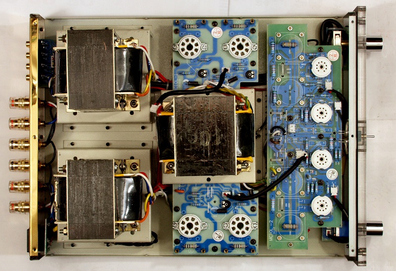

I have been wondering how the amp would look without the transformer covers on. Odd maybe but has anyone come across a picture of such a thing?
