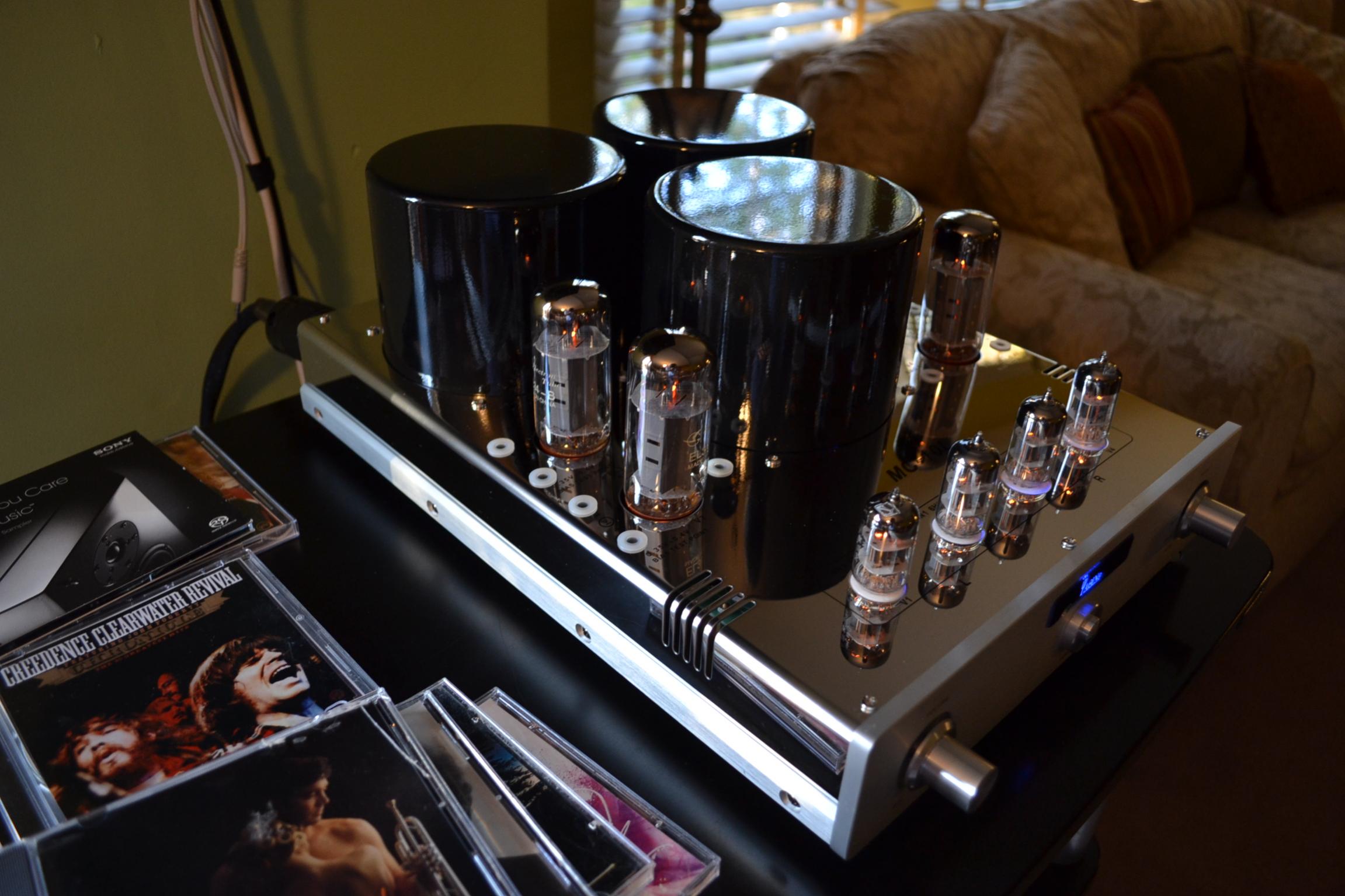

The amp arrived and it was better than expected. I finished the mods and installed a new set of Mullard reissue EL34 tubes. Sound is fantastic.
I have pictures and write of the mods here on my site for anyone interested.
