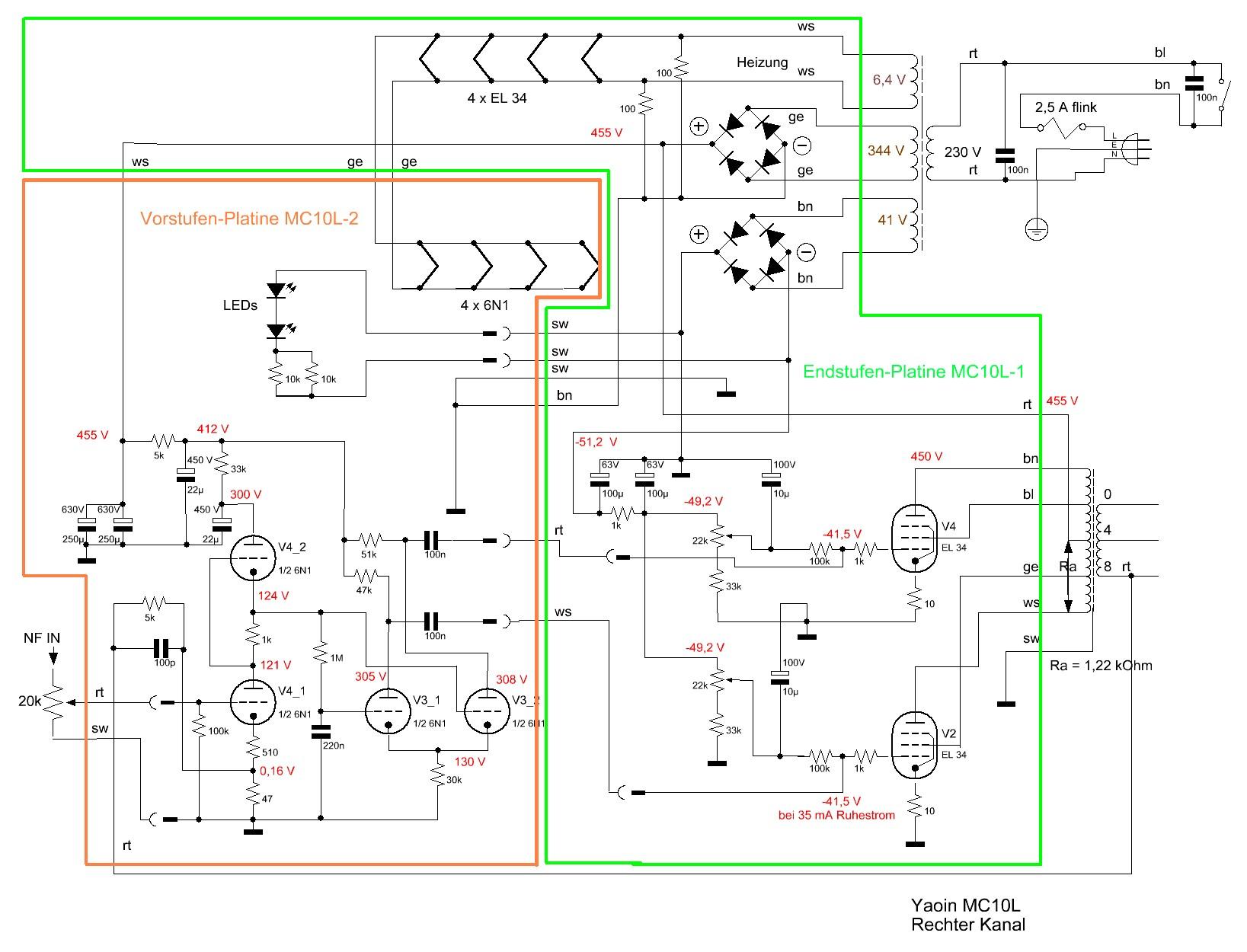

Found a different schematic.
What should B+ be? 440vdc? Cause my amp started out in its "Dark Place" with no warm up and only reads 386vdc on B+ and the bias measement twice removed is less than half of what I had set it last week.
There's a clue. Measure the voltage on both sides of the 5k resistor. That will indicate whether the electrolytics are dying or whether there's a problem in the signal circuitry that's causing it to draw excessive current.
With fixed bia and the bias voltage being way high, I'd look at the voltage across the 1K resistor in the bias circuit as well.
The bias is supposed to be -41.5V acording to the schematic. If it were all the way up at .14 I would expect the tubes to be drawing a lot more current that intended. This could drag down the B+.
But, i'd expect to see red plates as well.
