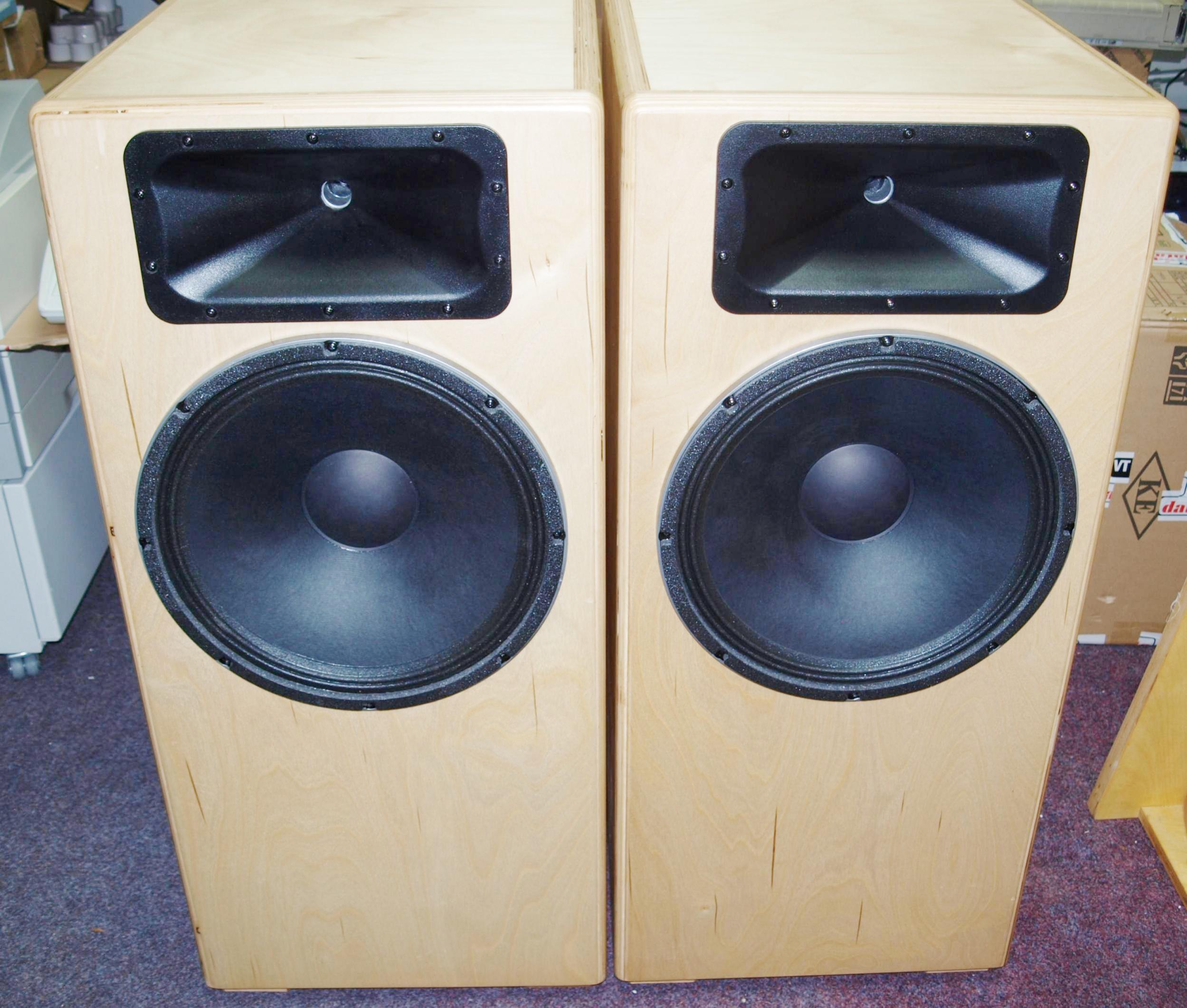

Yesterday I bought a pair of clones of this speaker - for a steal price.
I do not know the exact type of horn, but the driver and bass speaker are the same and it also uses 1st order crossover. I have had a chance to listen to them for some 20 minutes only, but I must say the sound is really nice. When installed in their place, I will try some measurements and maybe post some more details if anyone is interested.
One things is, they are really huge speakers And therefore I need to re-do furniture arrangement in the listening room first.
I do not know the exact type of horn [...]
That's either the Dayton Audio H6512, Pyle PH612 or the JBL original, the JBL 338800-001.
I put the speakers into their position. They are more or less in corners of the room, which may not be ideal. I think the sound would be further improved using active crossover and 4-ch amplification. I also suspect that the internal DAC of my small Denon receiver is not too good. The music sounds more detailed from my laptop's sound card. I did not realize this until I connected the huge high sensitivity speakers to it.
One of my future projects will be adding the RCF H6000 horn on top of the cabinet and turn it into a 3 way...and eventually into a 3 way compact PA box.
Even thought the box measures really flat, it is kind of laid back and I suspect is is the low order crossover and the crossover point - 2500 kHz feels too high for a 15" mid bass.
