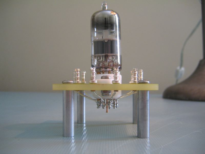

I have two of the 9 pin sockets, gold plate, that I'm not going to use. I did solder wire to it, so they are not completely unused. the're the 9 pin teflon at welborn labs site, 9PCHCD:
http://www.welbornelabs.com/sockets.htm
man these were $88 a piece! I'd be willing to part with these for half? $44 for the pair.
I also have glasshouse boards to go with them:
I will say that these are high quality sockets and well made...
As for how they effect performance of audio.... I would say that it depends on the application... If you have small signal tubes then the effects are small to negligible...
If you are using a 211 or an 845, then examine the AC voltage swing on your load line....This can have roughly a 2000V AC swing, which now puts a sever gradient upon the dielectric, thus having an affect on high frequency performance...
I would also say that pentodes in octal base would have more of a affect....due to the higher source impedance...
