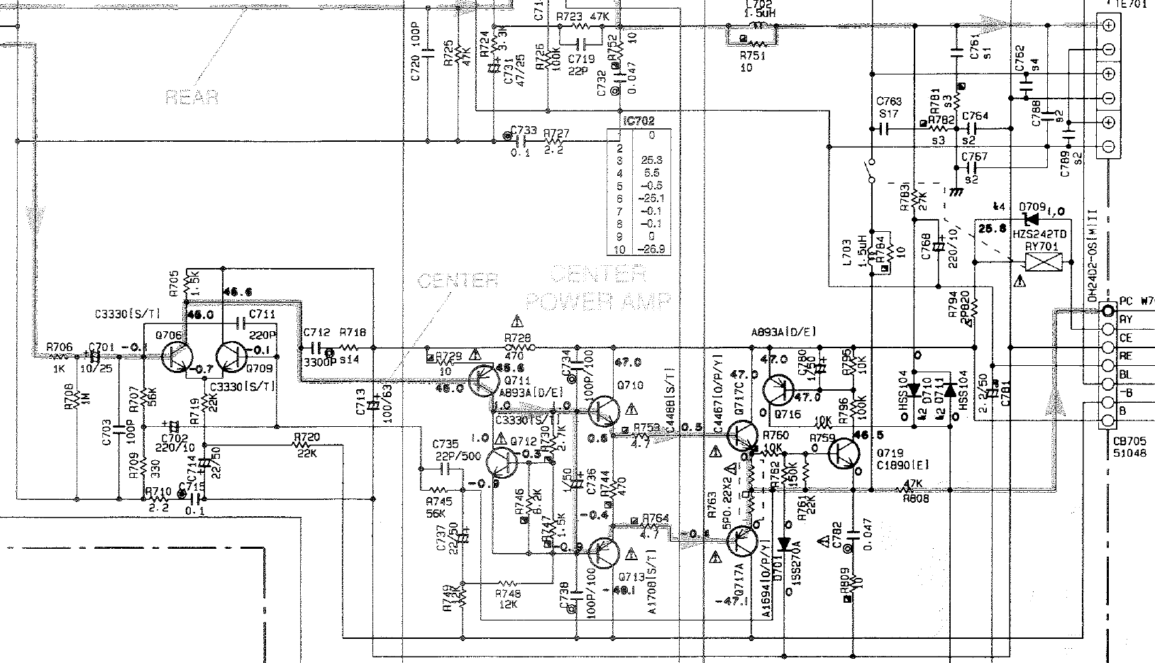

As D103 is reverse biased, the 1.07v seems to be coming in from the circuitry above your schematic section. It's probably coming in from that MU (mute) pin on CB102 which then points you back to the System Control IC301. You could try lifting R329 in the Mute line to see what happens.
Hey Guys,
Right, turns out that all the PCB's connectors grounds are in series and isolated with small caps (C715, C127 for example - Is this common?), meaning because I didn't have all the boards connected (I thought isolating them would make it easier to diagnose, not worse!) that I had all those high voltages as half of the PCB wasn't grounded.
Now, I have the rear power amp connected fully as well as earthing out the two E pins on CB701. I didn't have a heap of time tonight to do too many measurements however I found that when the amp first powers up I have around 22v on the LHS of R808 and 0.7V on the RHS (which is leading from the rear power amp to PROTEC and hence turning it off).
THEN, with the mains relay shorted open after about 7 more seconds the output relays (RY101 and RY701) turn on and the voltage on both sides of R808 drops to about 100mv. Then, if I press the power button again on the amp it turns on and stays on.
So, this is what I'm thinking: RY101 and RY701 should be turning on earlier (rather than about 10 seconds after the button is pressed/the mains relay turns on) before the IC checks the PROTEC pin (which is around 3 seconds). Perhaps one of the caps has lost its charging capabilites and is causing this? What do you guys think? How do I even easily test for this besides pulling them all out?
I also tested Q717A/C and they have the correct voltages on them (when the amp stays on after the relays click in), so I don't think it's them.
Anyway, let us know your thoughts!

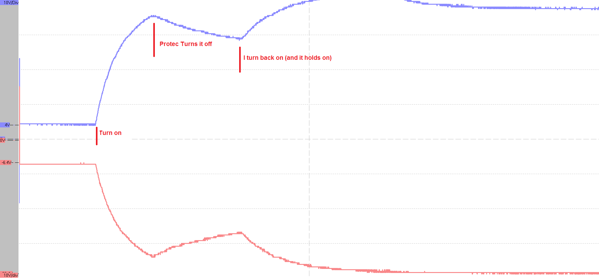

Hey Guys,
Finally have gotten enough time again to dust off this amp and have another play, after a bit of measuring with this rear power amp I am now fairly certain it's something to do with some of the transistor/cap timing!
I've noticed that measuring at R763/R744/R808 when you first power on the voltage rises quickly to 22V, then up to around 33V before powering it's self off (with the 0.7V on the RHS of R808, leading to PROTEC).
This then drops the voltage down to around a -400mV DC, (however looking at my DSO trace there is a reasonable AC fluctuation), which if turned back on again here it will stay on forever at this same voltage.
It then does a strange thing if left here for about 6 seconds (without turning back on) as it will increase this AC amplitude, then back off all the way to -15V where it will then discharge slowly (over a few minutes) back to 0V.
I've included a trace of these measurements, plus one of the two supplies from the bridge which shows that they are quite symmetrical in their behavior.
Any thoughts on this? I'm thinking it's a dodgy cap on the negative supply somewhere (C737, C735, C738), however that's pretty much a guess...

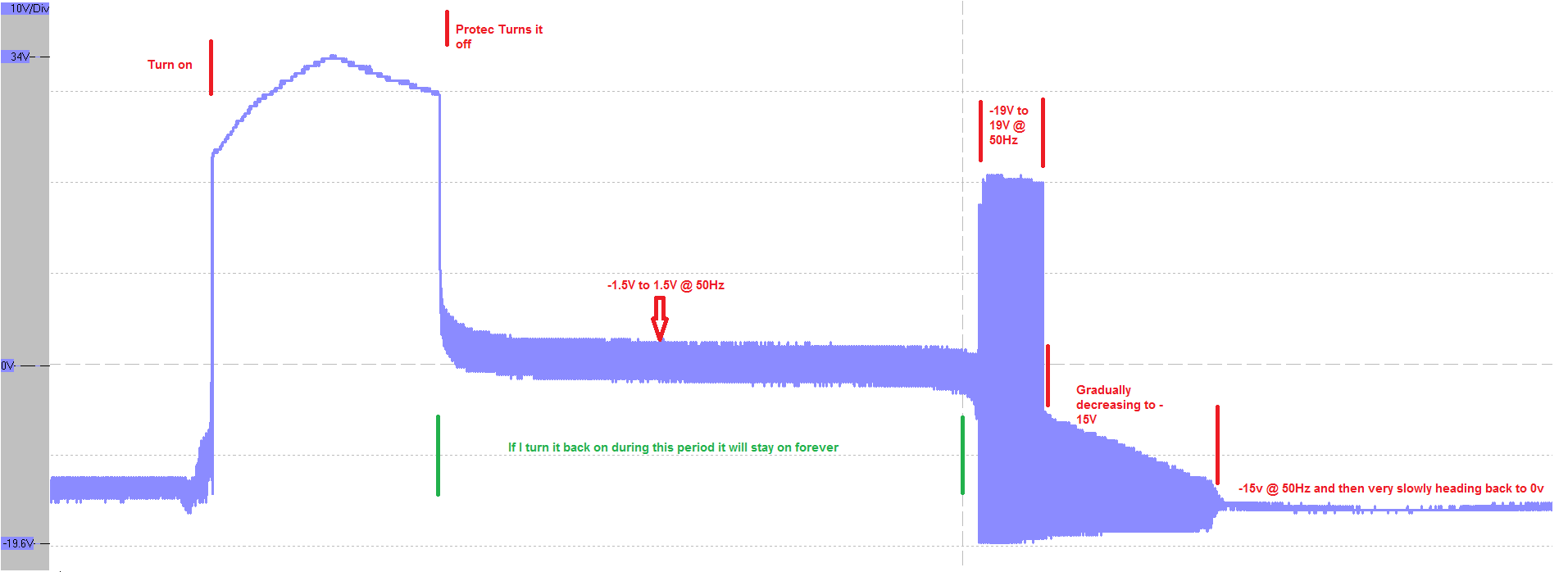

Some designs can be a bit marginal on protection, fine when they're new but throw in a little cap drift/leakage and then they're not fine, I've experienced it myself on a Harman Kardon 5.1 sub not coming out of standby and the relevant cap had only dropped in value 10% and wasn't leaky.
Another thing I think I've noticed is that you're looking at R808 in the centre amp circuit, the rear amp is IC702 and has no protection according to the block diagram in the full schematic.
Sorry I can't be more help ATM.

Hi sbrads,
Thanks for your response, that's interesting to know about the RVX-667. I think you're right, that is the correct timing for the output relays, it was just coincidental that it occurred at similar timing to whatever is my problem.
My mistake on which amp I have been looking at as well, it is the centre one (I had forgotten after all this time)
I spent quite some time today thoroughly measuring what is happening, and this is what I propose:
On initial power-up either Q713 (and hence) Q717A isn't turning on quick enough (well before PROTEC is checked), as one of the capacitors in the timing circuit is taking too long to charge (however will be enough if the amp is quickly turned back on). This is why it initially goes high, because the negative rail isn't activated.
Is this plausible? If so, which capacitors? I couldn't figure out exactly how the circuit worked so I'm thinking I might just replace C734, C736, C738, C735, C737 and see how it goes...
Thoughts on doing this?

That seems to indicate something doesn't like high voltages, like caps, but transistors can go a bit leaky at high volts also which doesn't help to reduce the possibilities.
For caps, I would first change the feedback electrolytic C702, the reason being that the amp AC gain is controlled by feedback R745/R709 ratio and is high (x160-ish) but the DC gain is unity because of the infinity resistance at DC of C702 being in series with R709. Therefore if it's leaky, the DC gain shoots up and input errors get amplified up at the output.
For transistors, the input pair would be favourites as a bit of leakage on one half of the output stage trying to cause voltage offset would get tuned out by the feedback if the rest of the amp was OK. An output transistor would have to be very leaky to do anything bad and as you don't have a high current consumption it would likely rule out the output stage.

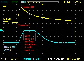

Right, time to try something new. Get a permanent connection to Q709 base so you don't have to probe all the time, measure the voltage with a DVM and get used to how long it takes to charge up from -10v to 0.1v with a few turn-ons. Now heat up areas of the board with a hot air gun (hair-drier will do) and repeat. You could also try freezer spray as well if you have any. Look for variations in the charge time, with a bit of luck you'll get a large change in a small area of the board which should help to narrow the range of possible faulty components somewhat.
A quick look at IC702 datasheet shows a quiescent current of typically 60mA, max 120mA. At 52v total supply that's 3-6w dissipation which could be very hot depending on heatsinking.
sbrads,
After convincing my girlfriend that it's perfectly acceptable to be taking her hairdryer out into the shed, I have tried your suggestion and have found that when I heat up the effect power supply (namely C747 and C746), Q709 base voltage on power off drops to ~-4v instead of -9v as would happen at normal temperatures.
So, my thought is that one of them (C746? I'll replace both anyway) is leaky, resulting in the whole protect circuit being pulled low through D712.
The only other cap in this area (where I am directly heating) is C745, so I might as well replace that as well.
What are your thoughts on this?
