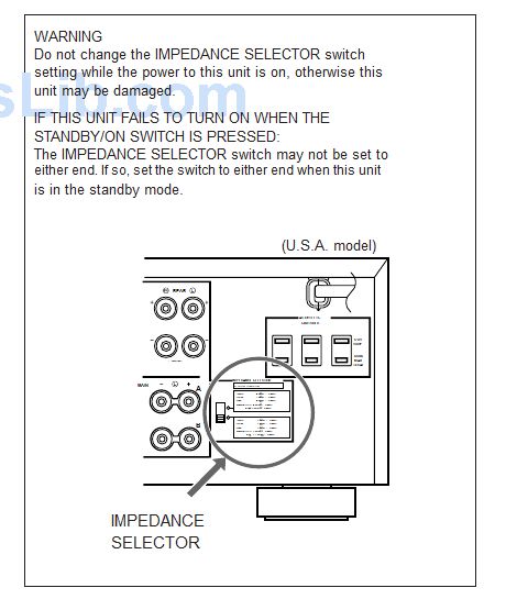

Check the impedance selector switch on the back. The contacts become intermittent and cause the very problem you are experiencing. Give the switch several actions and then set it back where it was and try again. If this clears the fault the switch will require a small squirt of Deox or similar to provide a more permanent solution.
hmmm ... it looks like the impedance selector switch may affect how the power is rectified ... actually changing the voltage on the main caps .. so, what you are saying is that if its contacts are not solid, it can screw up the power supply in such a way that the cpu chip takes a voltage transient and trashes one of its power inlets (for example) ... yes, there does need to be an explanation as to why that chip would suddenly decide to fail, and someone static zapping the unit is not a very good explanation. That comment is very much appreciated. I think you may be on to something .. I'm beginning to wonder if the impedance selector switch isn't a serious risk to the amplifier as you describe it ... and if other TTL level chips haven't also been damaged by that.

Here's an entry from the user manual regarding the impedance switch.
