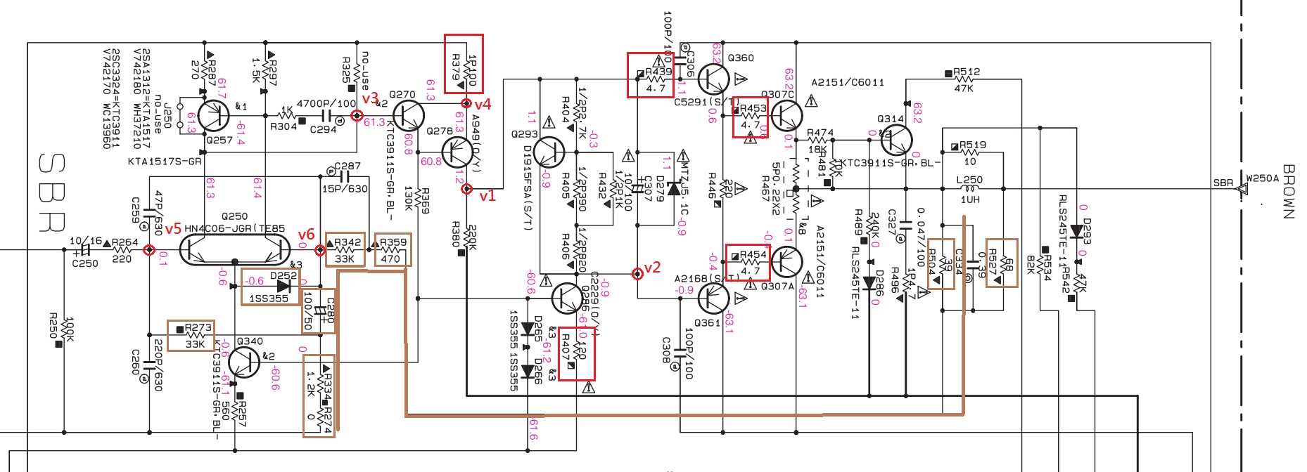

In these Corona-times I have some time to work on this amp, but I have got myself a headache trying to understand what's going on.
The amp goes in protection, so I have to start it in self diagnosis.
There's 1v8 DC on Surround back right output.

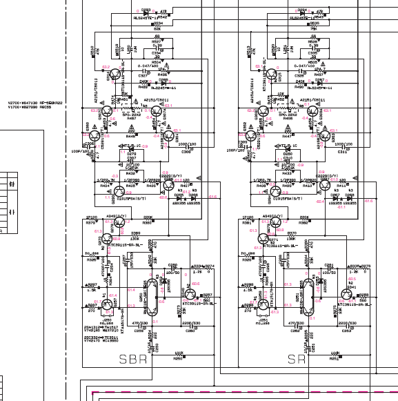

I have pulled both OP-transistors and they measure OK. I have also measured the rest of the semis in circuit and compared them to the other channels.
Of course there are differences, but not more than expected, typical 0v552 - 0v562 drop or so.
Maybe the fault are located in the stage before the OPS ?
The amp are not easy to start up without Yamaha's extension cables, and one can't measure on OPS when the amp is assembled.
So maybe someone have a good clue about what is going on.

Well, the amp are up and running.
Could'nt measure any differences on the bad channel's componets, so I took a shortcut and adopted PCB's from another broken amp. The DSP circuits did'nt work either, it only worked in Direct mode.
